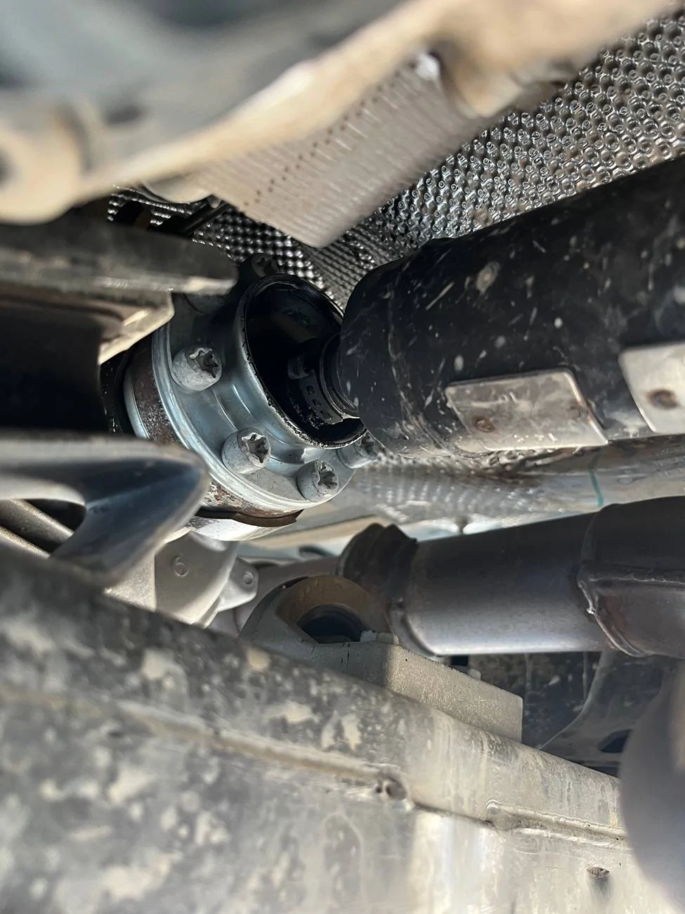

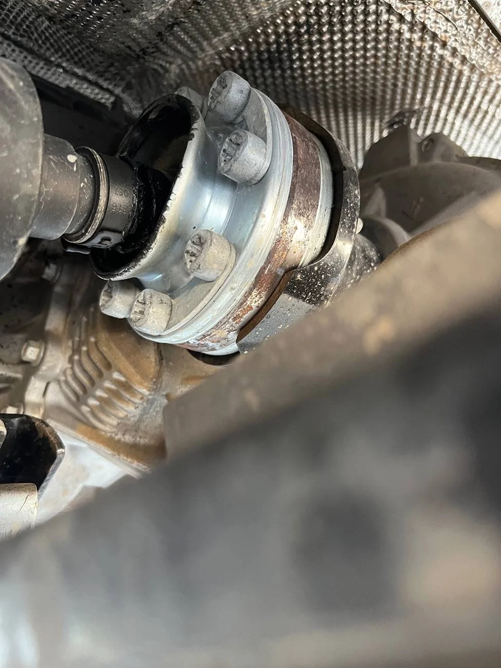

Wanted to add a data point to this discussion for future searchers.
3.5ā€ lift on a 2024 rubicon XR 3.6 AT running billstein 5100 (24-310635) which are marketed as a 28.4ā€ extended length shock
Bent the flange pretty good and tore the boot despite being under 29ā€ extended length.
Ordering an Adam’s this weekend, but now the JLs do not come with FAD so I will have to play the game of balance castor and pinyon angle
I'm planning on purchasing an aftermarket front driveshaft for my lift, but I was wondering... Has anyone cut the flange off that part of the drive shaft with an angle grinder? It doesn't appear to be doing much other than getting bent and destroying the boots of the poor joints.
