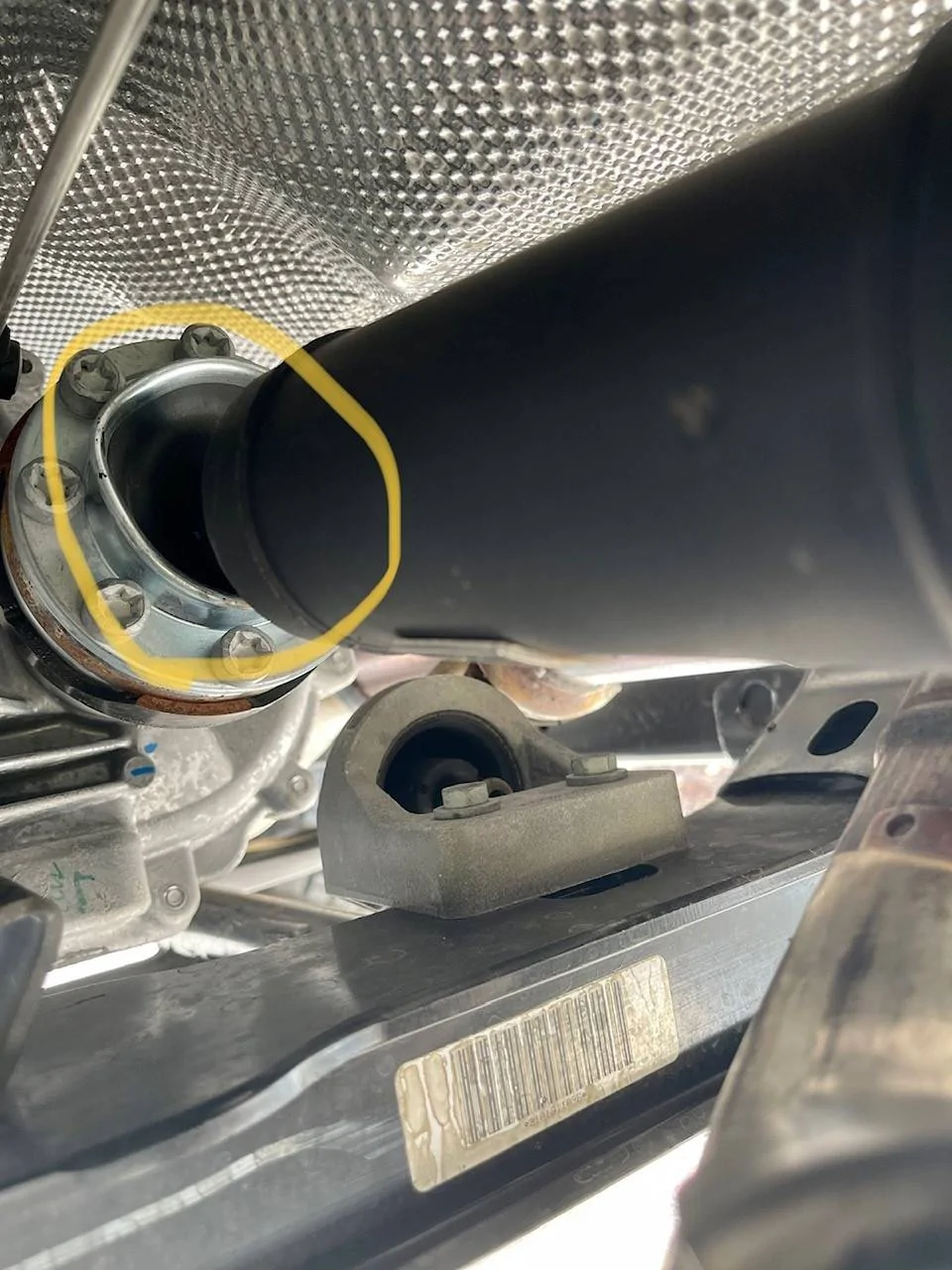

Yes you want a new front shaft. The factory design does not work with 3"+ lifts. The cup on the output shaft will bend. Mine bent after its first trip on the beach. I'm glad I replaced it then and not on a real off-road trail.
Right there's your justification ?
Again, it is not the lift height, but the shock extended length that determines whether or not you need to change out the ds.
How do you explain the DS damage then? Do you know for a fact he’s running 30” shocks on his Clayton 3.5” lift? Even if he is, I doubt he got that much flex at the beach…
It’s both. The height puts the drive shaft close to the cup at ride height. Any additional downward droop forces contact and it bends. The lift progresses the issue via DS angle.
Droop from shock length could accomplish the same thing at any lift height.
No, it's not. Even at full droop hanging on a lift with 29" shocks the cup won't come into contact with the shaft. I'm not making this up.
