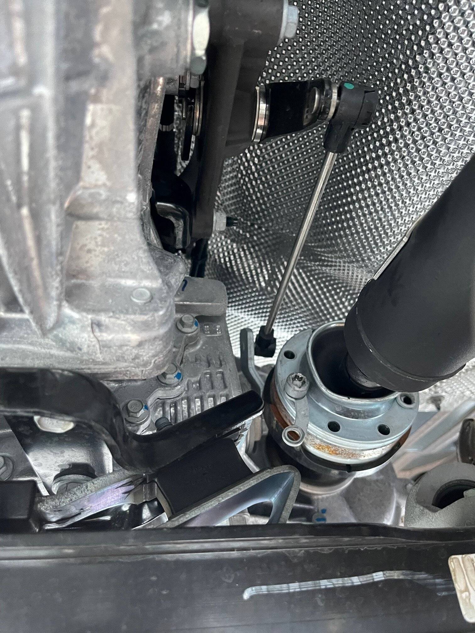

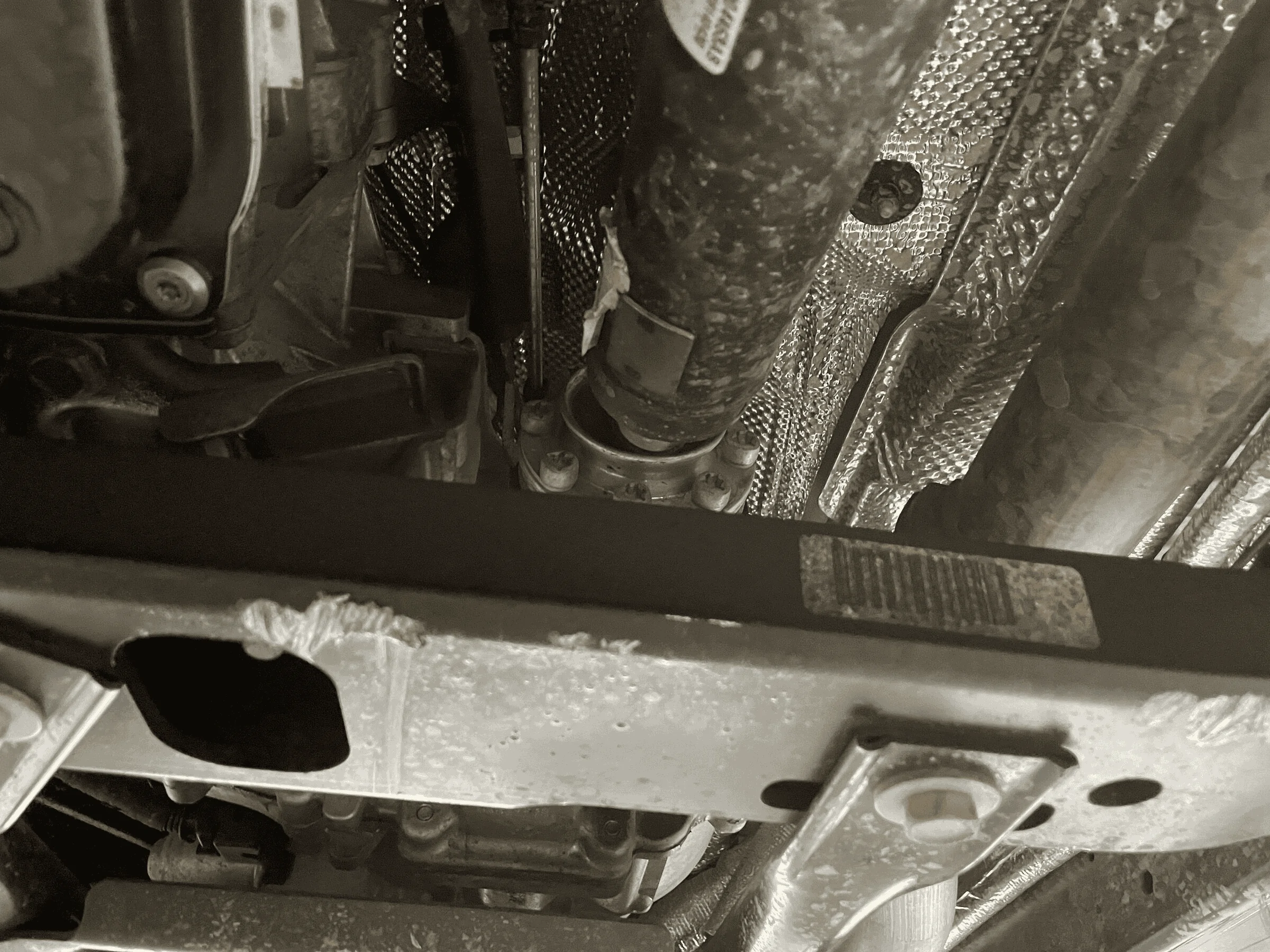

Wanted to add a data point to this discussion for future searchers.
3.5” lift on a 2024 rubicon XR 3.6 AT running billstein 5100 (24-310635) which are marketed as a 28.4” extended length shock
Jeep Wrangler JL Adams drive shaft - required? IMG_2583
Jeep Wrangler JL Adams drive shaft - required? IMG_2582
Bent the flange pretty good and tore the boot despite being under 29” extended length.
Ordering an Adam’s this weekend, but now the JLs do not come with FAD so I will have to play the game of balance castor and pinyon angle
