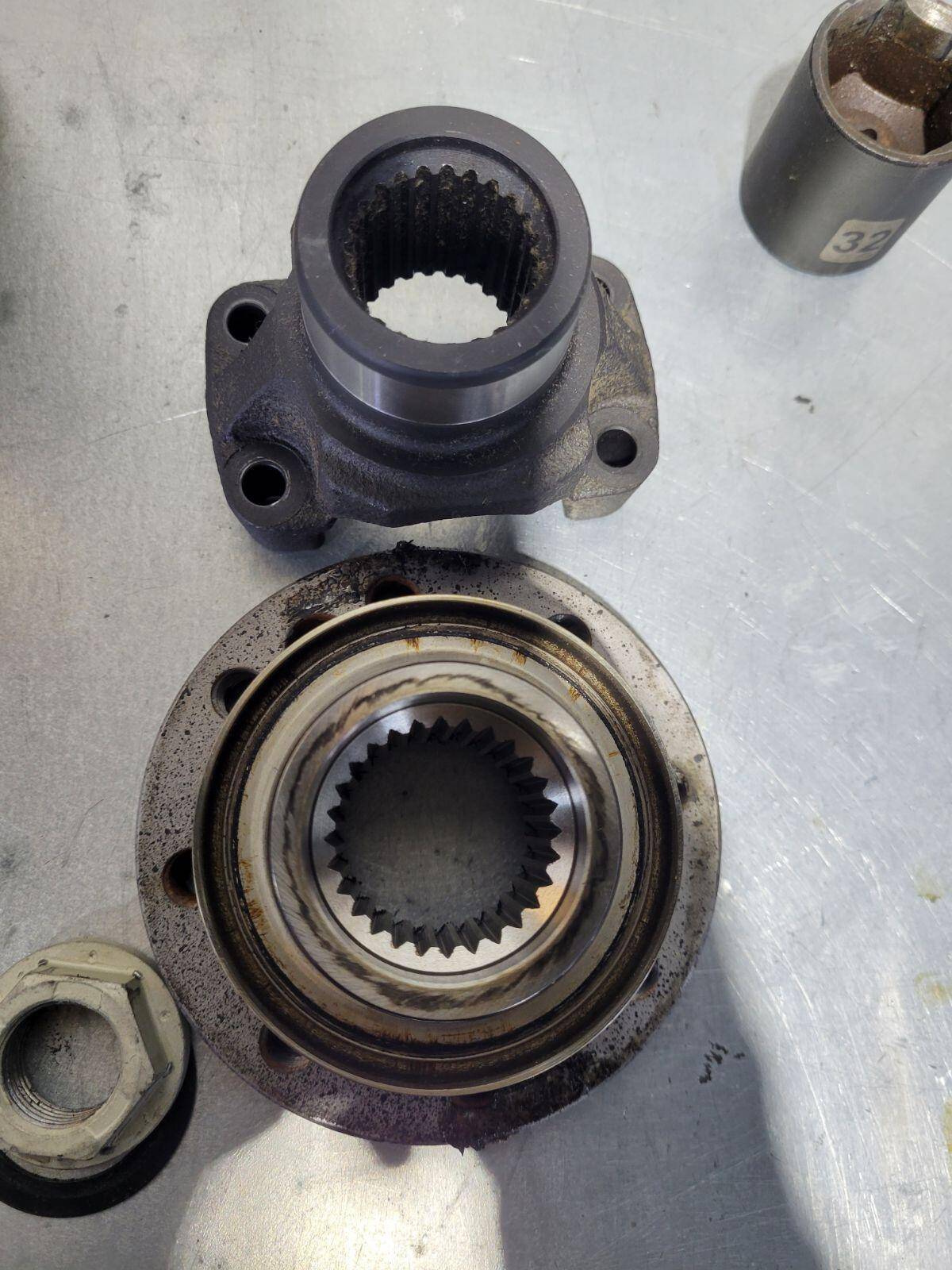

Has anyone ran into an issue with the front drive shaft being different yet?
I have a 24 Rubicon, 6 speed with 4.88 gears. Just installed a metalcloak 2.5” lift and forgot my 32mm socket so couldn’t install my new drive shaft. Took it to a shop to get an alignment done and asked them to throw the new front drive shaft in while they had it up. I ordered a Yukon 1310 drive shaft. Box said Sport / Sahara Dana 30, but my understand was I swap yokes and it’s fine. Shop told me the “inside spine diameter on the Yukon is way too small”. I can’t seem to find anywhere that they changed anything with the 2024’s. Could it be different with the 4.88’s? This is the crappy pic they sent my from the shop. I have not had a chance to get under and look myself, but if I have to return the driveshaft I have to do it in the next few days or I’m outside of the return policy.

Rear is different now but haven’t heard about the front. Front should be 24 and rear 28. Is the front a 28 now?

That’s what’s going me wondering. The photo definitely shows 28 spline yoke.
Like I said I was not there, I dropped it at a 4x4 shop near my work to get it aligned and swap the driveshaft. Full disclosure, I’m not exactly happy with the alignment. Caster was set at 5.2* and 5.7* (hence why I wanted to get it checked). They set it to 4.1*/4.3*. Said they have never heard of setting it as high as 6* and they set all of their lifted vehicles like this. My fault for not saying what I wanted to begin with, but I assumed a “truck” shop that is known for lift install would know. They told me they could fix it, but would charge another hour of labor at $145/hr to do it since their alignment machine said it was good.
Reason I bring up the alignment part, I would honestly not be surprised to find out they dropped the rear driveshaft and not the front. This is one of the reasons I was checking if anyone else has run into this with their 2024’s

I just went out and checked under the jeep. I can see the tool marks on the front drive shaft and none of the rear. Its pretty obvious they dropped the front one, but I have not heard of a 28 spline front driveshaft in these before.

Just got off the phone with Yukon support. They said that a Rubicon with a manual transmission is in fact a 28 spline. I can not find this same information anywhere else. The price they gave me for the new driveshaft was almost $1100. I dont mind having to move up to a 1350, but not at double the price.
Can anyone with a manual Rubicon confirm that is a 28 spline?
