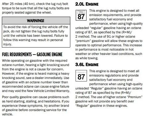

I still can't get over them saying that there is no benefit on these engines to running premium, but then the very next sentence they say you may experience audible knock while running 87 but that it's cool. You know what resists knock? Higher octane gas, sounds like a benefit to me.
Where does it say that? The below image is all I see. The only mention of them saying a light knocking sound is no cause for concern doesn't reference it being from using 87, and also doesn't seem to be referring to actual ping/detonation, but simply a light knocking sound, which can come from normal operation of parts that can make ticking, knocking, and clicking sounds normally. If your Jeep is actually having detonation problems, something is wrong with it. The knock sensor should pick it up and likely throw a code if it's actually a problem. That's different from the 2.0 and other motors/ECUs that are tuned to adjust to different fuels and run differently.

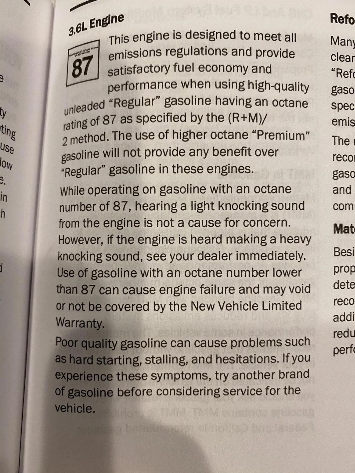

Page 369 of the 2020 owner's manual:
Jeep Wrangler JL 3.6 engine and 87 octane a no-no 6pSwDTM
There is nothing wrong with the engine according to them if you're hearing 'light knocking', but the engine knocking loudly enough to be heard is not optimally timed combustion very obviously. You have experience tuning so you know what happens to fueling strategies as knock control increases.
Woah, that's worded a little differently (in a not so good-sounding way lol) than my 2021 manual, which is where I took my pic from (the PDF version they sent me). I could see where that could be read as it being a result of the 87 octane that there's knocking, maybe that wasn't intentional and why they updated it to what mine says. I still think they're referring to normal knocking sounds, not not actual detonation, but that sounds bad to read that way. Surely nobody would consider detonation to not be a concern, especially a manufacturer!
