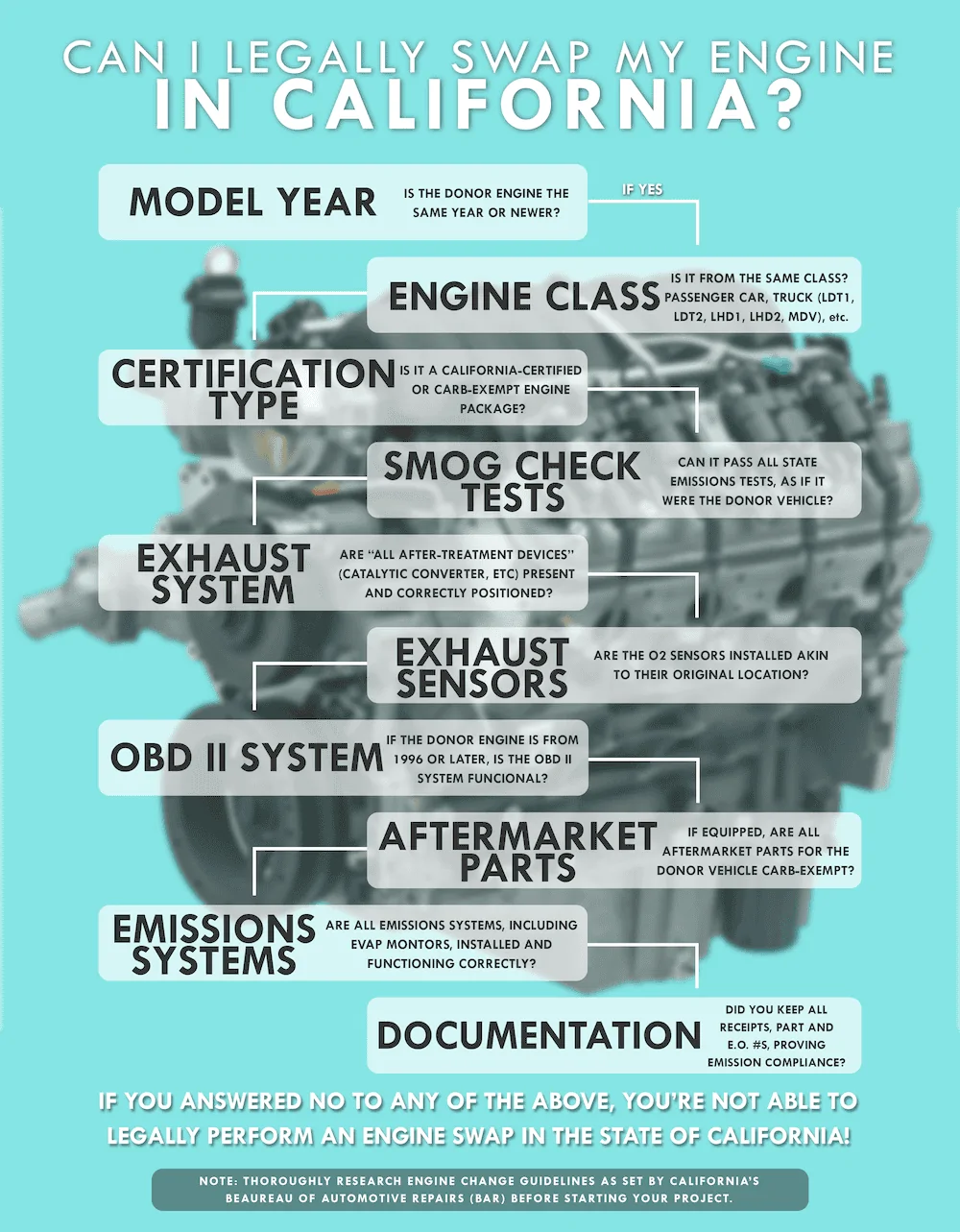

When I checked with an in state shop in 21 that did swaps and prominently showed a 392/JL swap that was Not Legal For Use On Public Roadways. The latest Approved swap at the time was a 5.7 truck engine/JK swap. Perhaps it could be done with difficulty but if not approved, big problem.
It can be approved, assuming it follows the guidelines I posted earlier. I would question any shop that doesn't know this.
There's no list of approved swaps, and anything that doesn't get approved by the Bar referee would be considered off-road use only.

Which leads me to believe they got the 5.7 truck engine (only)approved and could duplicate. But haven’t gotten the 392/JL approved. It would be a gamble if you’re not certain of approval. Haven’t checked since April of 21.

I am certain that it is possible. The guidelines are in the links I provided.
CARB doesn't certify all engine swaps for a specific vehicle/engine combination. The referee checks every single engine swap to make sure they comply with the guidelines. You could put any motor in anything as long as it complies with the guidelines (for street use).

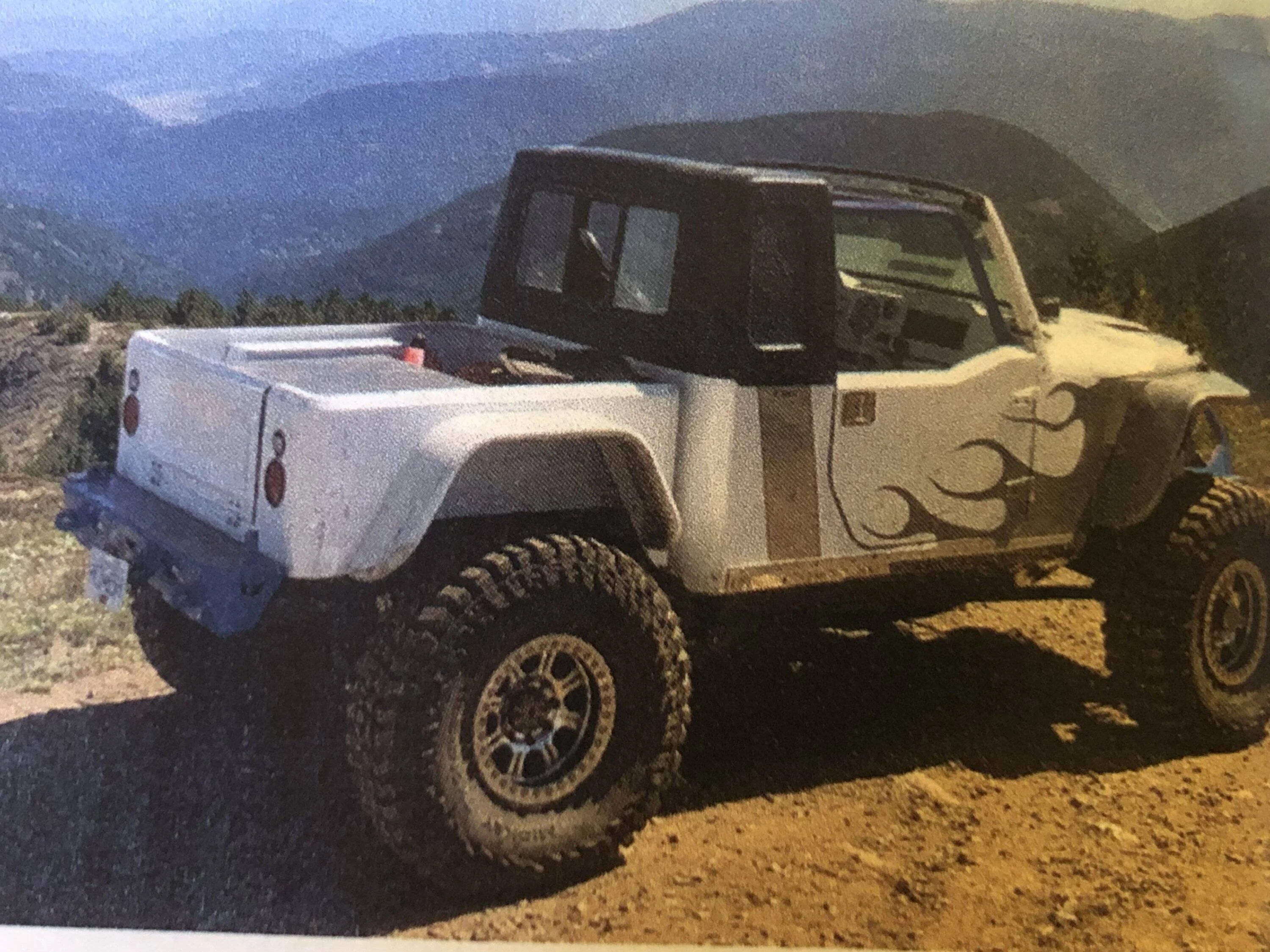

It would probably be easier and cheaper to have a collision shop cut and shorten a 4 dr 392 into a 2 dr.
No emissions headaches

I would definitely buy one altered into 2 door with pickup bed.
Jeep Wrangler JL 2dr with bigger engine??? IMG_2461
