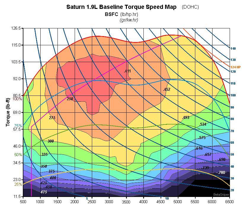

And I'm learning this is BSFC (Brake-specific fuel consumption). From Reddit:
Jeep Wrangler JL 2021 Sahara Overheating on freeway BBWi6
This map tells you how much fuel the engine burns per horsepower-hour or kW-hour it's producing. The red island is where the engine is most efficient.
What this tells you is that the engine is most efficient at about 75% load (think 75% throttle, roughly) and at medium revs. In that range it burns 250 grams of fuel per kW-hour or 0.411 lb of fuel per horsepower-hour.
At lower load levels it needs a lot more fuel. This means that an engine only runs efficiently when you're asking it to work reasonably hard. The curved blue lines tell you how much power the engine is producing, so when you look at the red island, the lowest power output that this engine can achieve while staying in its efficiency sweet spot is 30 horsepower.
So if the gearing is appropriate this engine would burn 30 * 250 = 7.5 kg grams of fuel per hour while putting out 30 horsepower. But what happens when you ask it to make half as much power? It's going to burn at least 15 * 300 = 4.5 kg of fuel to make 15 horsepower for an hour. Half the output but more than half the fuel consumption.
And that's where the problem lies with large displacement engines. The BSFC map is for a 1.9L 4-cyl engine with 120 hp or so, and its efficiency sweet spot is in the 30-70 horsepower range. If you made this into a 3.8L V8, its efficiency sweet spot would be in the 60-140 hp range. But driving on the highway at 70 mph only requires like 20 horsepower, so a large displacement engine is going to be pretty far away from its efficiency sweet spot, running at a load level that's too low.
Wonder if and how forced induction changes that, since the torque curve is generally really flat and you're putting out so much of your torque so early in the rev range.
Thank you, this is interesting chart, first time I see this kind of analysis
