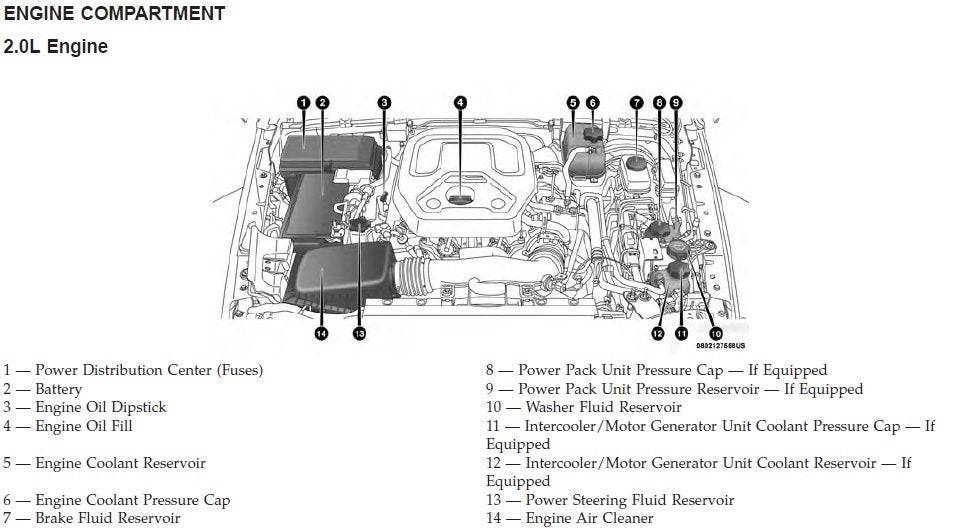

Just to confirm coolant reservoir locations:
5 & 6: Engine
8 & 9: Power Pack (48V battery for eTorque)
11/12: Intercooler & generator (BSG for eTorque)

The 2021 Sahara has 2 reservoirs, # 5 and # 12 while the 2018 JL Sport S 2.0L has 3 reservoirs #5,#12 and #9. Do you know what power pack means?

The "power pack" is the eTorque system's 48V battery cooling circuit. This also means that reservoir 12 is dedicated to the intercooler instead of being shared with the BSG (Belt Starter Generator).
If anything, a non eTorque JL like your 2021 should cool better than one with eTorque, since there are less heat exchangers/radiators to cool.
