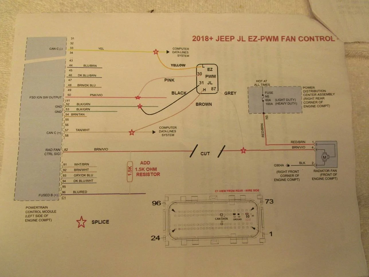

Here is the solution to if the PWM module fails
2. If the unit fails can a jumper wire be used to temporarily run the fan? You can just hook the stock fan signal wire back up
Hook up an on and off switch to the two fan signal wires
Meaning if the module ever fails. unplug the module turn the switch to the on position reconnecting to factory fan control
The fan signal wire is the only wire you cut.All others are a splice
You will understand more ones you see the wiring diagram

More info
The plug that you see you pull back the tape on the loom to get to the wires
Jeep Wrangler JL Overheating and losing power IMG_1834
Jeep Wrangler JL Overheating and losing power IMG_1835
Jeep Wrangler JL Overheating and losing power IMG_1836
Jeep Wrangler JL Overheating and losing power IMG_1831

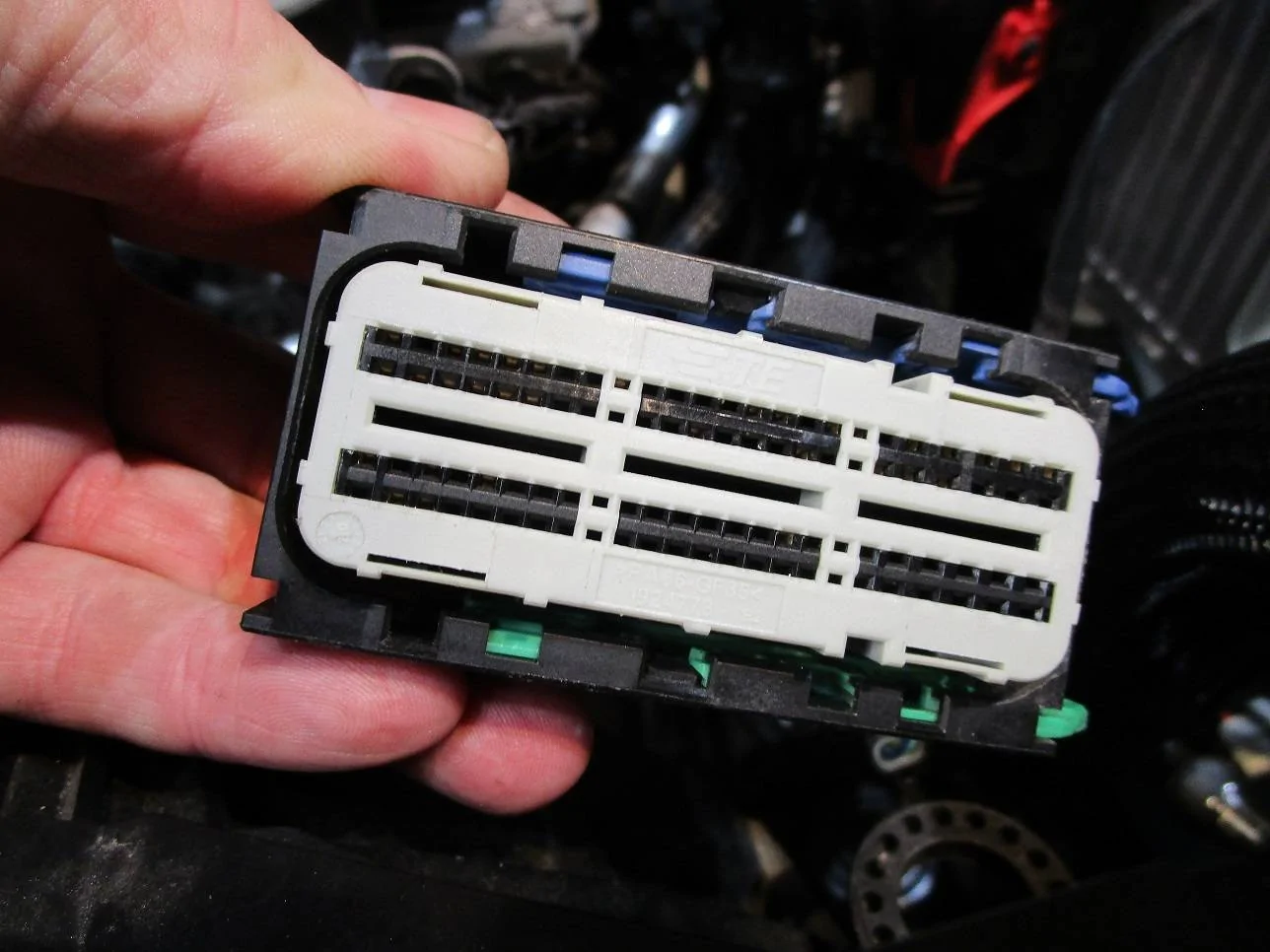

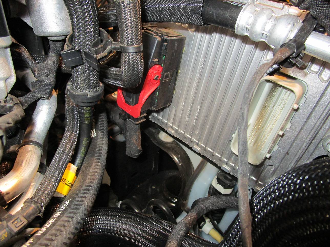

Jon from RPMExtreme said it's never been tested on a 2.0. He wants me to take a pic of the "engine computer". I assume he means the ECU. Is that the computer modular under the fuses? Or is it something else? He said the fan side should be the same.
Medsker
Medsker
Jon
Jan 8, 2019
758
1,514
South Jordan, Utah
2024 392
Retired Engineer
Thanks for the reply. I'm having surgery on my nose this morning and will be out for a few days but I'll take a look. I'm pretty sure the 2.0 is under the fuse box which means it probably won't work but I'll take a look and snap some pictures anyway.

Location of your pcm on 2.0

My 2020 2.0 ecu is on the driver's side up by the radiator.
