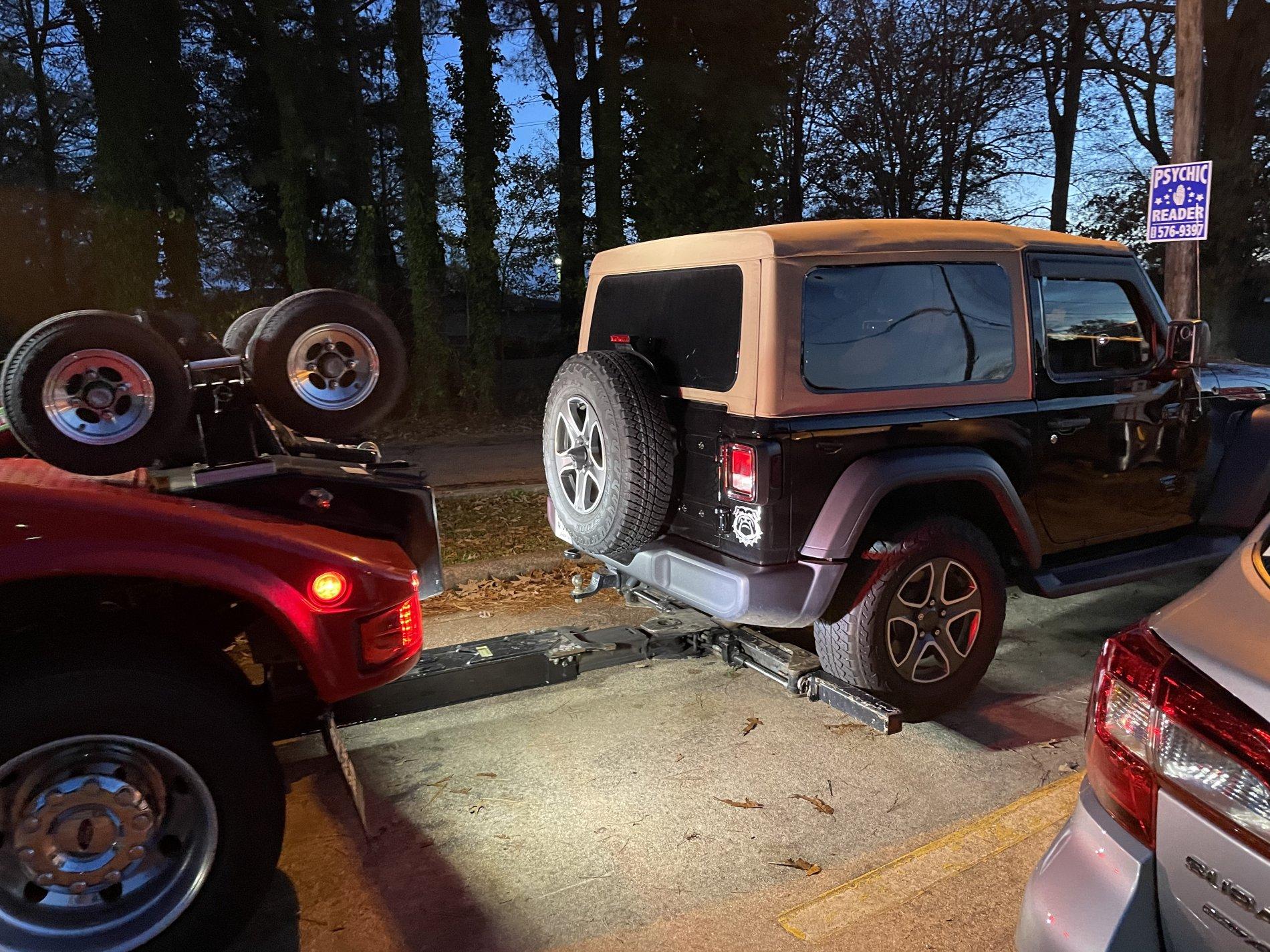

This is my 2020 Jeep JL with the 2.0 turbo engine and 13,708 miles. It has been rock solid until today. Without warning it started to overheat. I couldn’t find a leak but I could smell antifreeze. The reservoir has sufficient fluid and I was unable to find a leak. Well I used the Mopar app and requested a tow truck to take it to the dealership. Of course it being a Saturday I won’t know anything until Monday. I hope this isn’ta sign from above that I should have gone with the 3.6.

Today at 12:53 pm EST I called Jeep service department and spoke to Ron and he informed me he has tried to call me twice to let me know my Jeep was fixed. No missed calls on my phone. He said it was ready. Problem was Inlet coolant tube fasteners we're not holding. They had worked loose and they removed then they had properly torqued new ones. I still love this engine and the overall performance of my JL. Between the 3.6 and 2.0 I just preferred the torque performance of the 2.0.

Was your Wrangler towed with one end elevated and the other not? I thought these vehicles could be flat towed, or transported on a rollback, but never via a traditional tow truck (as your picture suggests.) Just curious.

Jeeps are traditionally a rear wheel drive vehicle unless 4 wheel drive is engaged so it can be towed as long as the rear wheels are suspended or flat towed if transfer case is placed in neutral or it can be flatbed towed.

I think the "Psychic Reader" sign in front of the jeep is some sort of message. Give them a call and see what they say.
