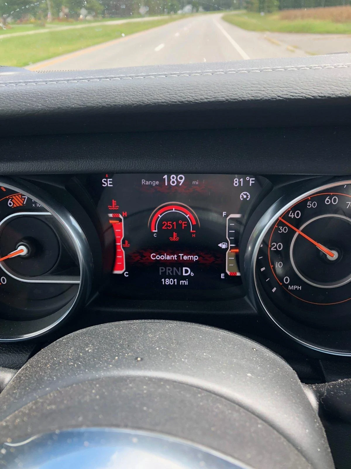

I got my vehicle back about two weeks ago, after five weeks in the shop and getting a complete engine replacement. I held off on posting because a) I wanted the dust to settle a little bit, and b) I wanted to see if everything was fixed and no new problems were introduced. The overheating issue, or more accurately the sudden rise in engine coolant temperature to a level that caused the warning light to come on, is resolved. The technician who worked on the vehicle actually thinks there was a defective or damagaged coolant line that runs next to the firewall that was the real cause, and that engine replacement was probably not necessary. I'm not sure exactly what part it was because I was getting the info second hand via the service writer.

This is my first reply/post. I have a 2019 JLU Rubicon with 13K miles. I experienced this on my way back from Zion, Utah to Los Angeles. Midpoint, stopped by In and Out to eat and noticed my fan blasting like crazy. I looked at my gauge and sure enough it was reading hot in red. It really was lucky i stopped because you don't really think this would happen on a fairly new Jeep. Long story short, I got it towed to the nearest Jeep dealer. They figured it out! It was the water pump inlet tube not torqued per spec. Apparently it was loose, not because of off-roading, it was just a flaw with some Jeeps. I searched the internet and found these complaints about it here:
