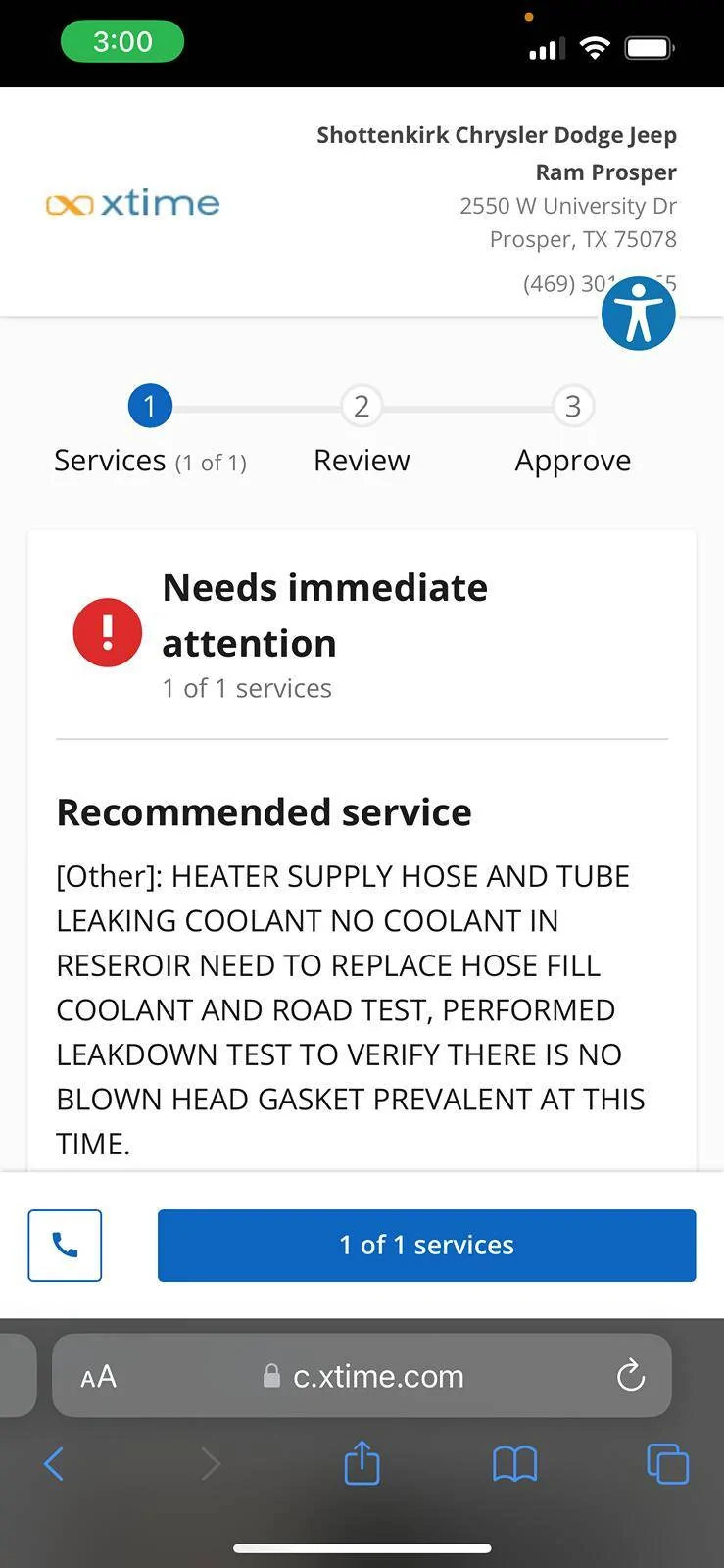

****Update on my overheating issue***
The dealer says a faulty heater supply hose and tube was allowing coolant to leak out from the secondary coolant resevior as others pointed out. Not covered under the Powertrain warranty since it's a hose according to the Dealer. Here is their description, hopefully this is helpful to other 2.0 owners if they have this issue.
They tested the headgasket and said it was find per the pressure test.

The 5yr/60k power train warranty only covers “internally lubricated” parts; heater hose wouldn’t be covered.
