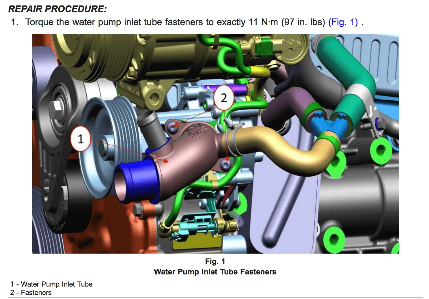

These are the 2 torx bolts you need to check to make sure your water pump inlet is properly fastened. This seem to affect quite a few 2.0s
With mine, I never used thread locker or even changed out the gasket. I also never torqued them. I cranked down on them and called it a day. So far, it's still tight and no leaks. One thing I did notice when I pressure tested it, it sprayed coolant on the ground and into the radiator. So the coolant smell took a while to go away (when it happened to me it was really cold out and I was not going to rinse the whole thing off).

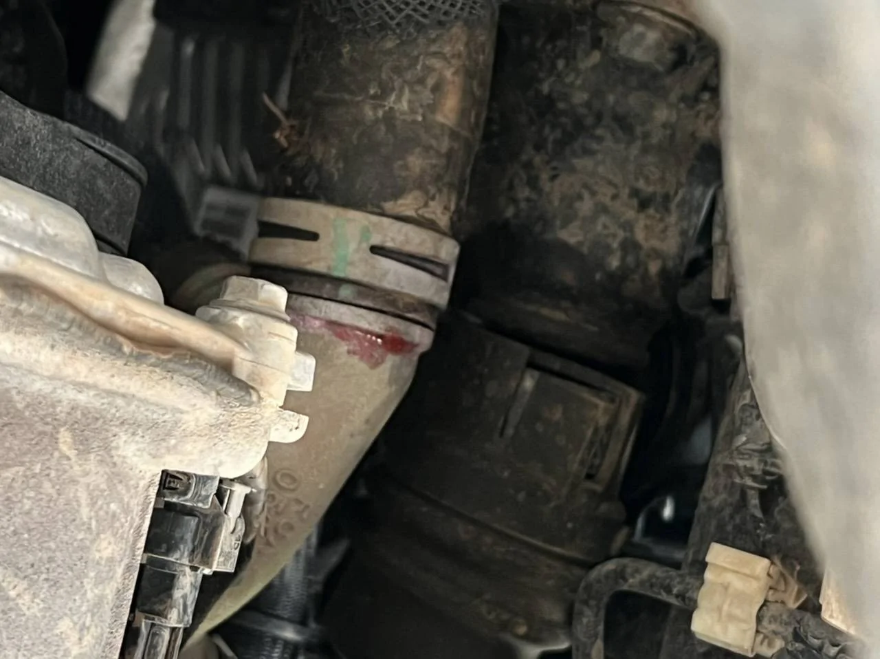

For anyone wanting to look, just lay on the ground and scoot yourself right under the FL part of the Jeep (about under the steering box). Look up and you'll see the lower radiator hose and where it goes to the water pump. It'll leak where the aluminum housing bolts to the water pump. If leaking, there will be pink crusty stuff all around it.

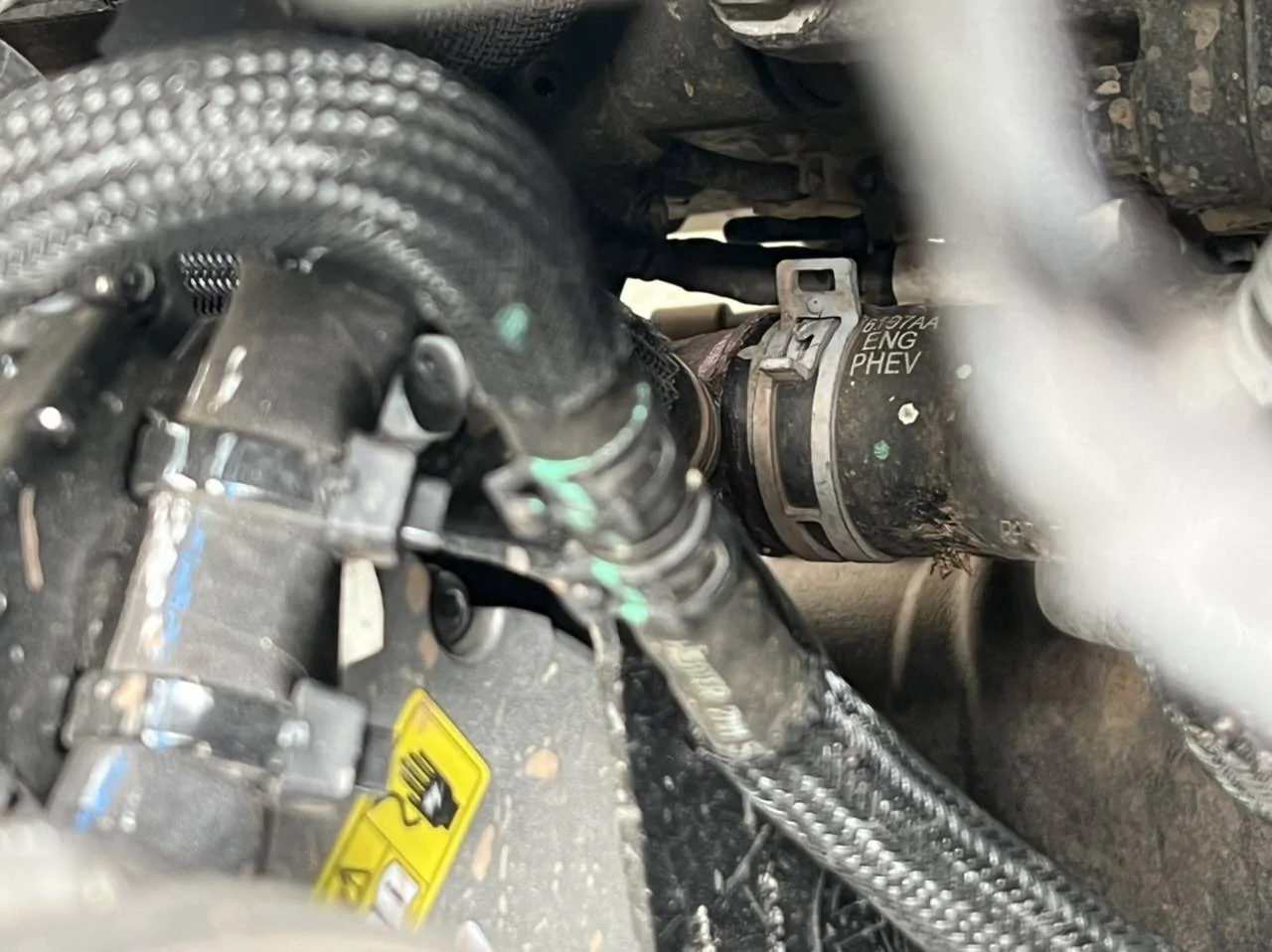

Just checked mine, 2020 2.0 19k miles both full. I even have an appointment next week at the dealership to have the lower hose replaced. I think the clamp isn’t on properly and it has a tiny bit of coolant build up on it. Might as well since it’s under warranty. Plus I have a big road trip next week.
@NyRey87 is this what your lower hose looked like?

jjvincent
May 31, 2021
973
1,411
Bethlehem, PA
2021 Wrangler, 2017 VW Alltrack, 2003 VW Eurovan
Mechanical Engineer
Just to make everyone feel better, after cranking down on those bolts a while back, no coolant leaks. While checking my work, seen that the oil water heat exchanger was leaking oil. No suprise to me, two of the bolts were loose. Got to love Jeep quality.
