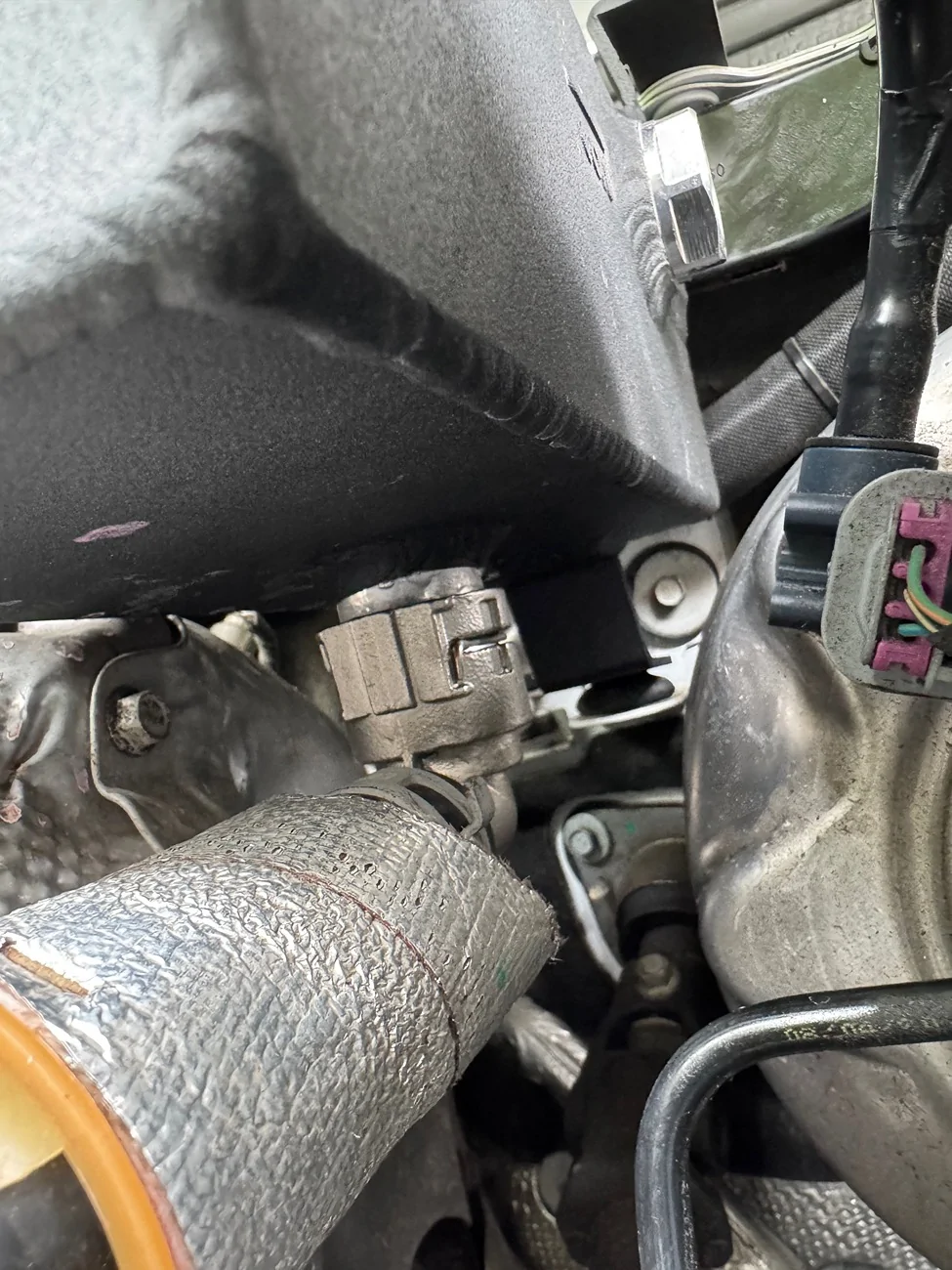

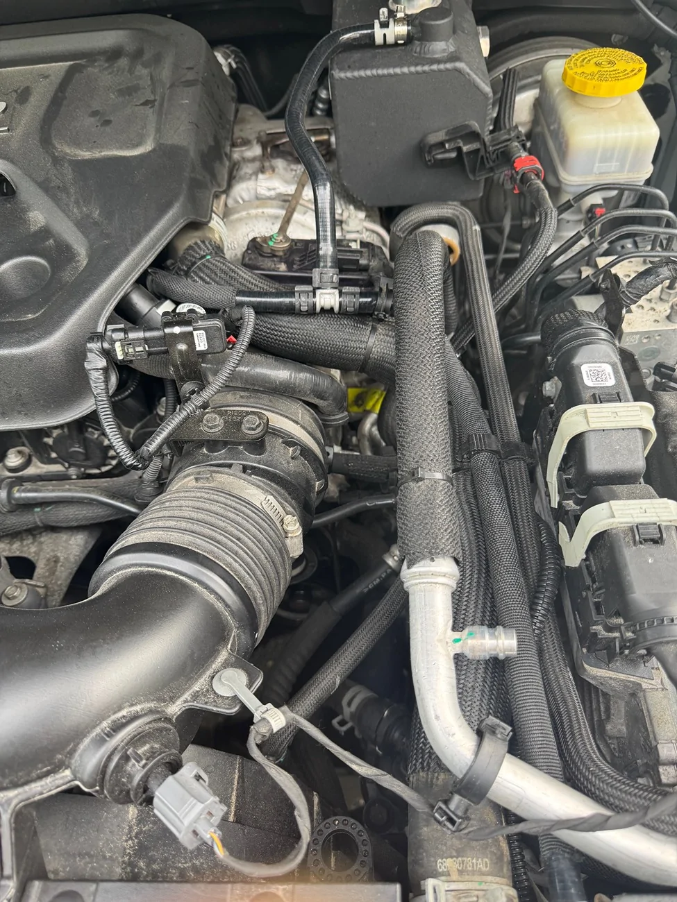

I honestly didn't need to do any of these replacement because the dealership the car came from did a water pump/coolant hose replacement in their reconditioning process and the parts look brand spanking new. But I did it anyway to hopefully get ahead of issue creeping up, because these rubber hoses have been problems in my other turbo cars as mileage increased in the past.

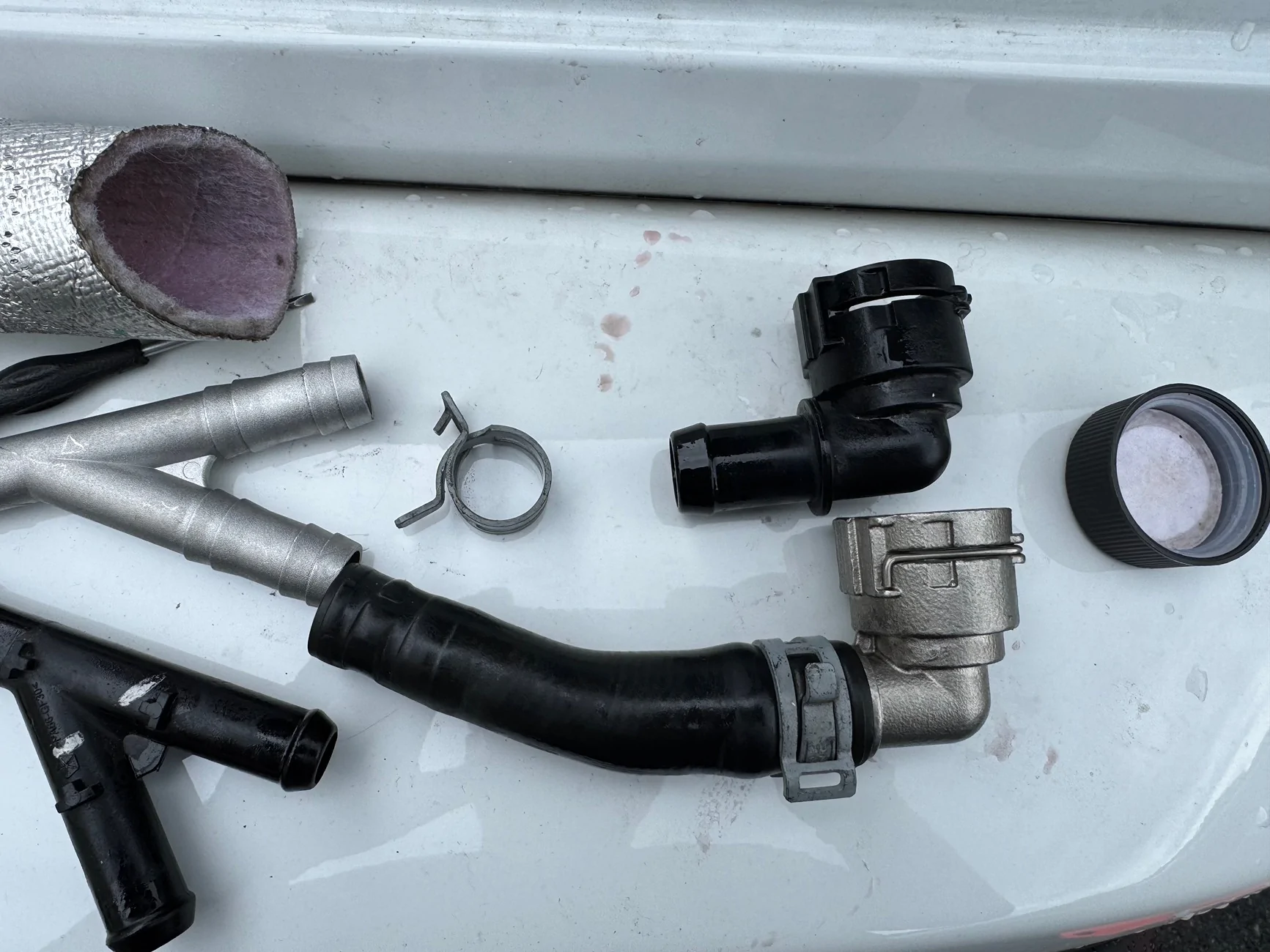

Anyway, what the T with silicone hose looks like:
Jeep Wrangler JL 2.0 Coolant Reservoir Replacement IMG_1246
Only thing I have left is the aluminum Y connector and the elbow replacement. I'll probably hold off on those for now since those parts also looked brand new.

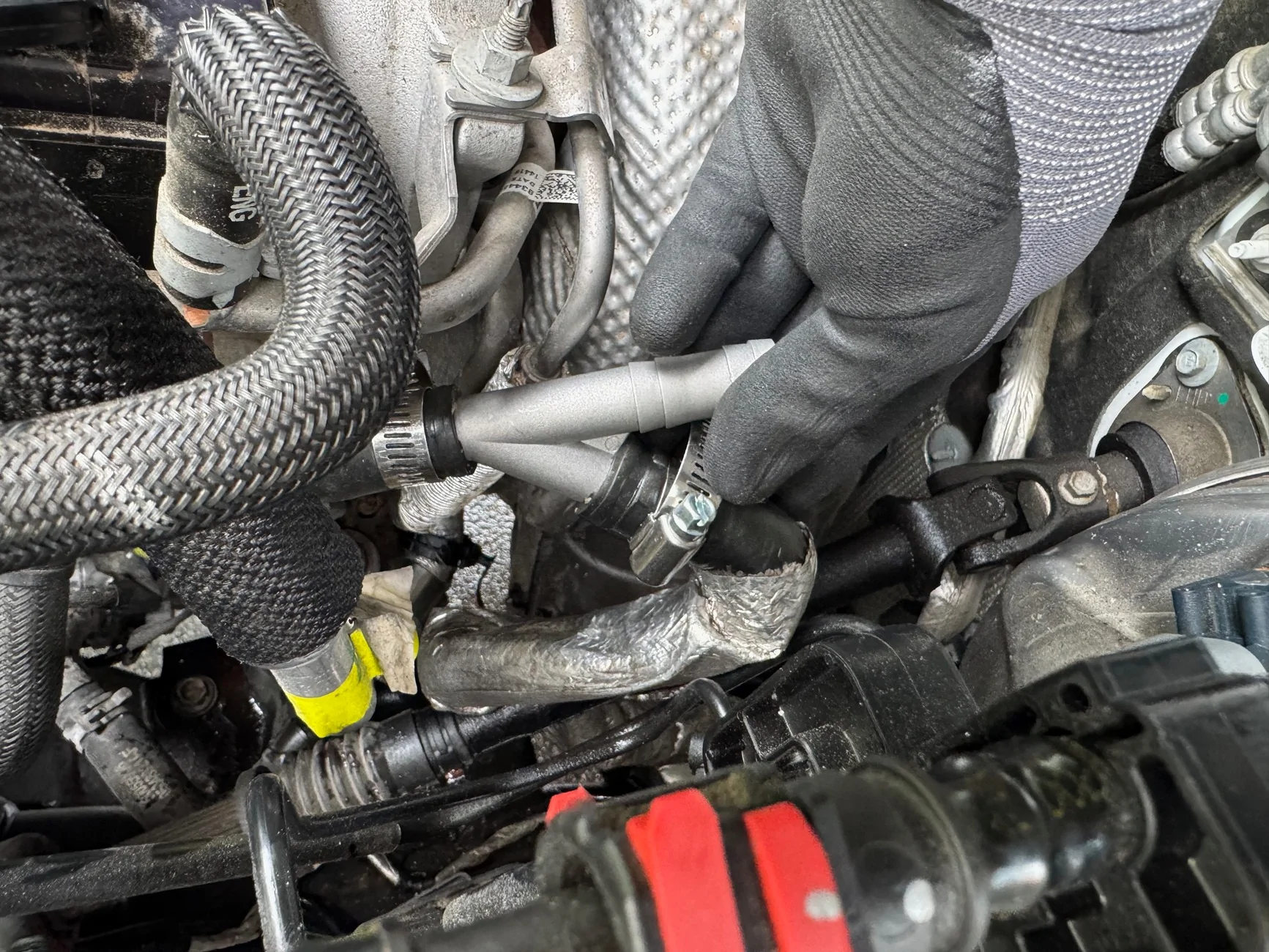

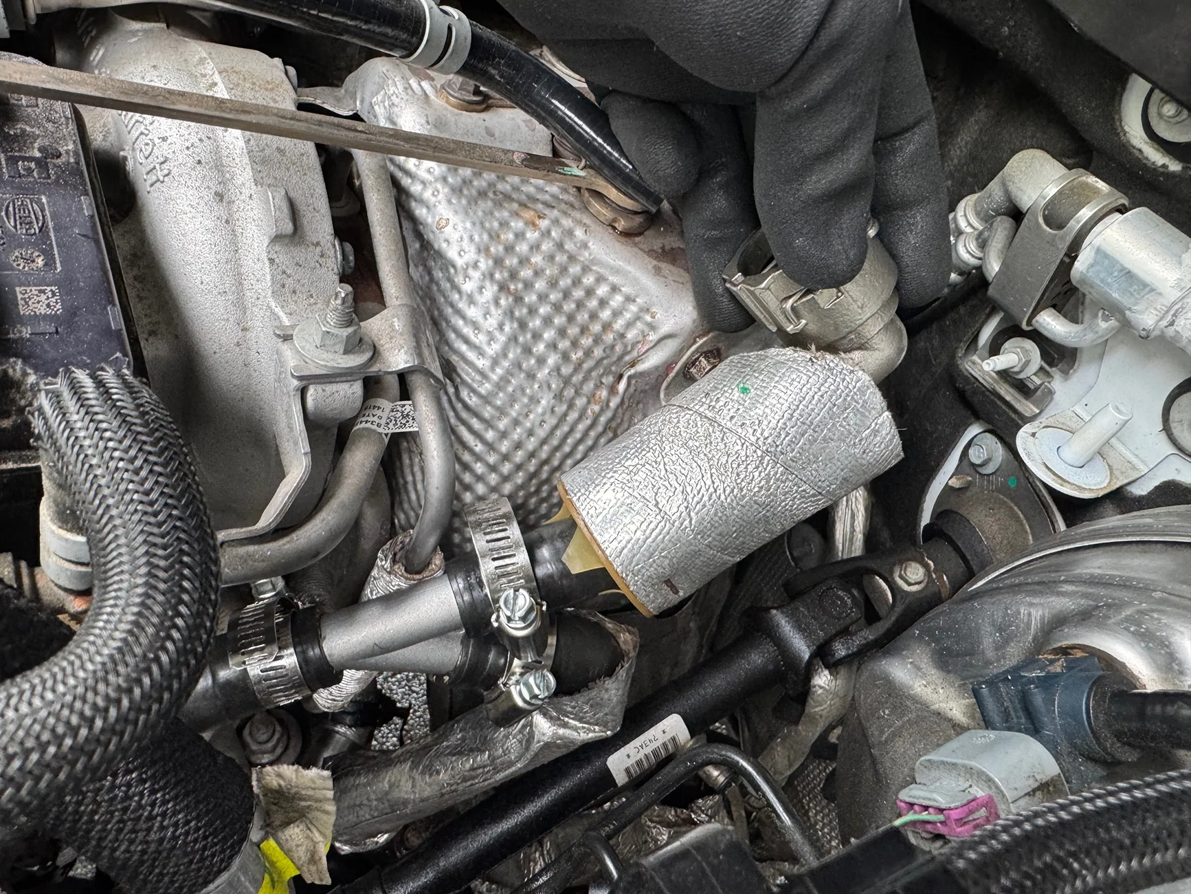

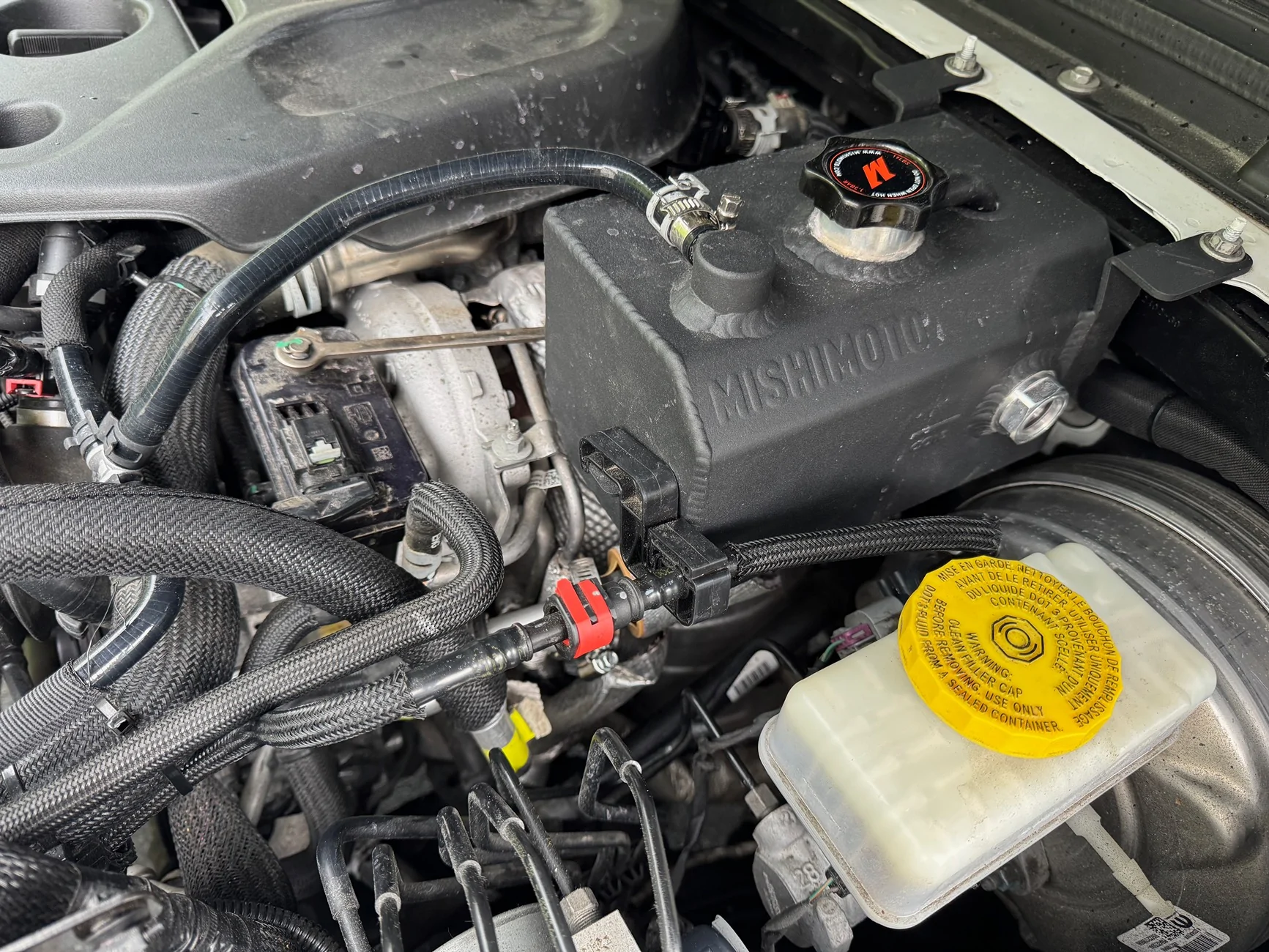

Just kidding. I got bored today and did the elbow and the Y junction.
So I now have MIshimoto, aluminum elbow, aluminum T with silicone hose, baja T, and aluminum Y junction. Aside from doing more silicone pipes (which I'm not going to do because then I'd have to take the whole thing apart again, and I'm not going to do that for the 4th time...), I think I'm pretty set.

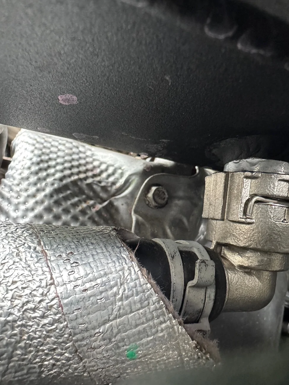

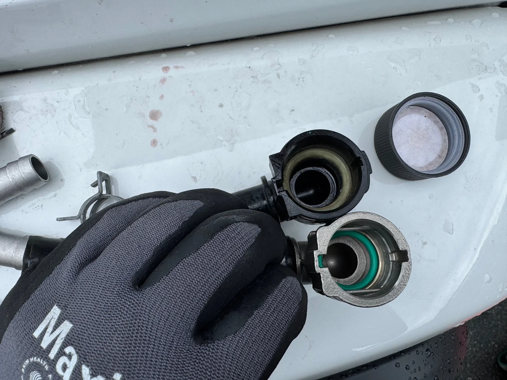

It most definitely does. When pushing it in though, gotta push it all the way past like the second stop. It catches once then you push it further and it pushes in all the way and catches again.

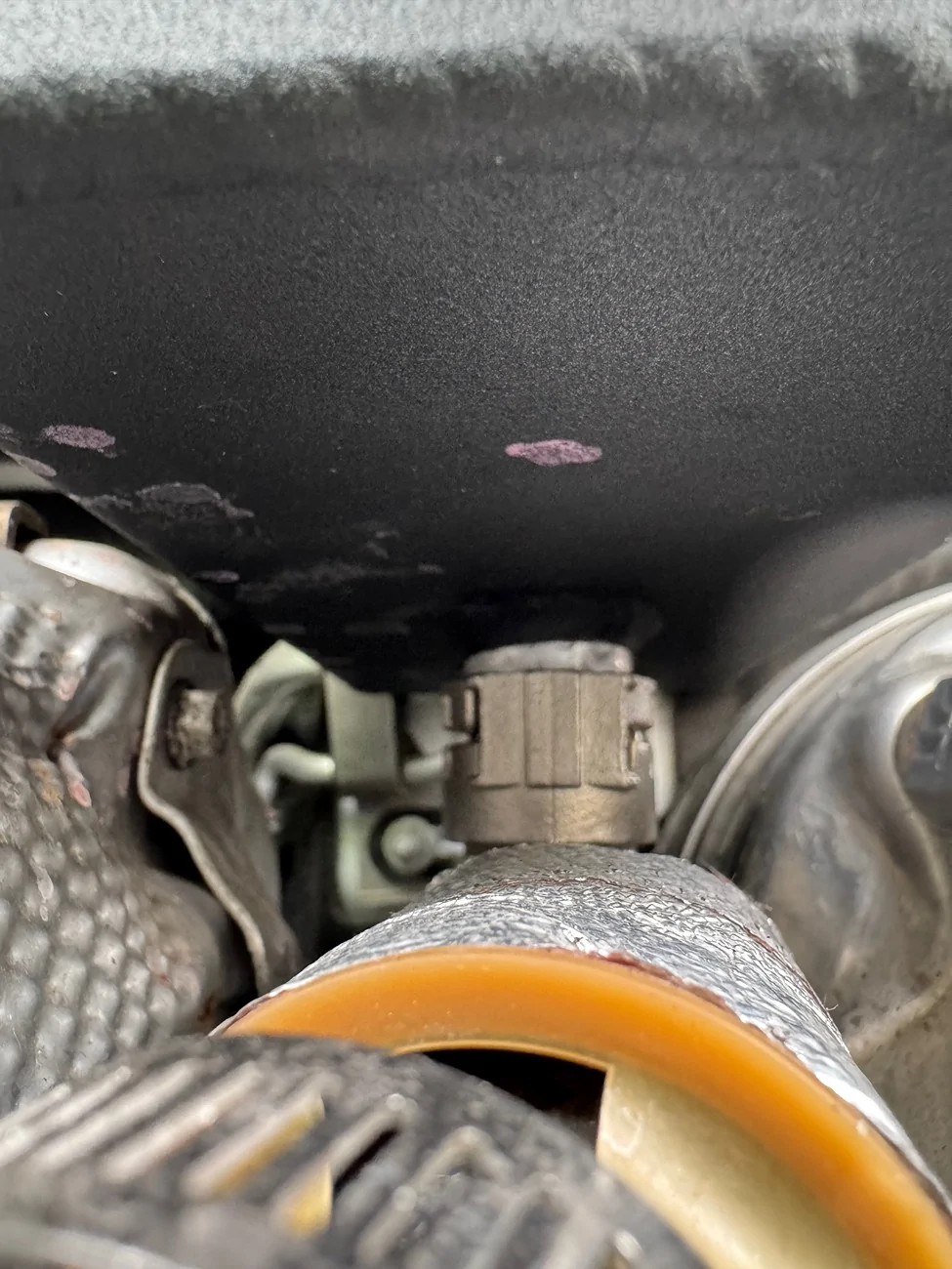

Did a 30 minute drive, and no leaks at any junctions so far.
The spots and insulation stained pink is from the removal and reinstall where coolant just got everywhere even after emptying the tank.
