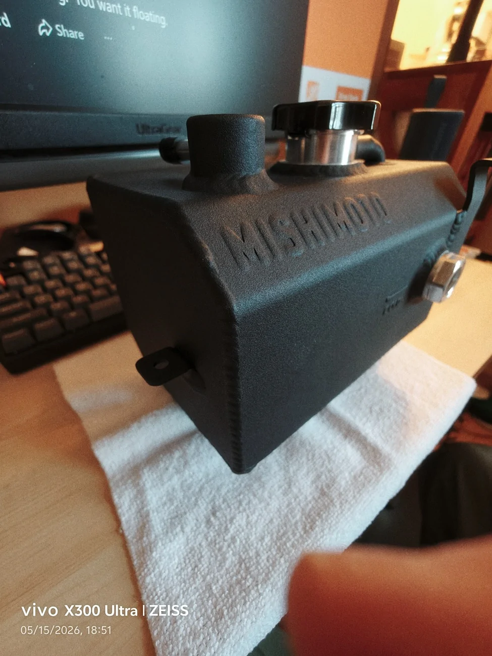

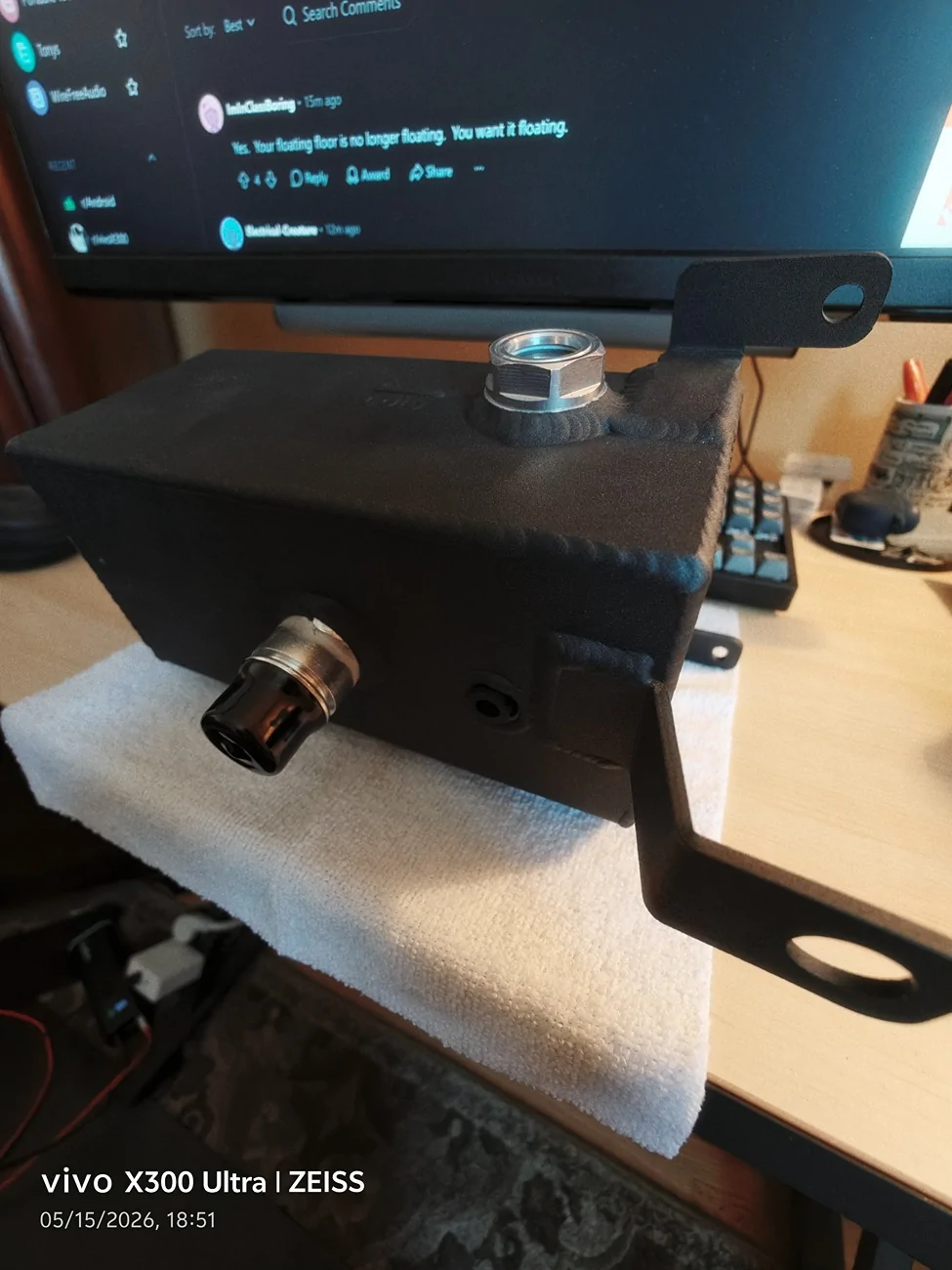

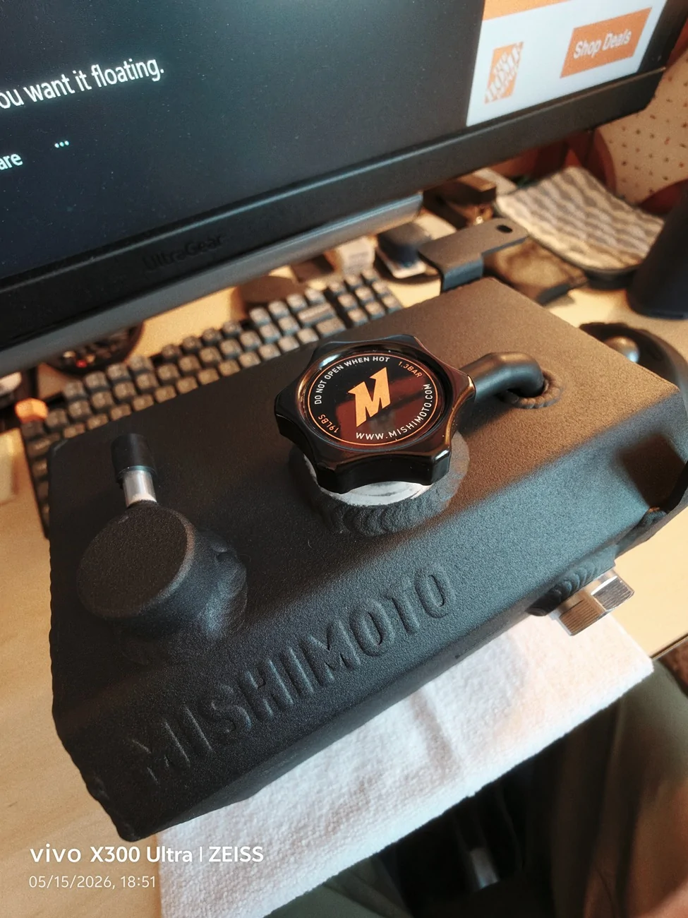

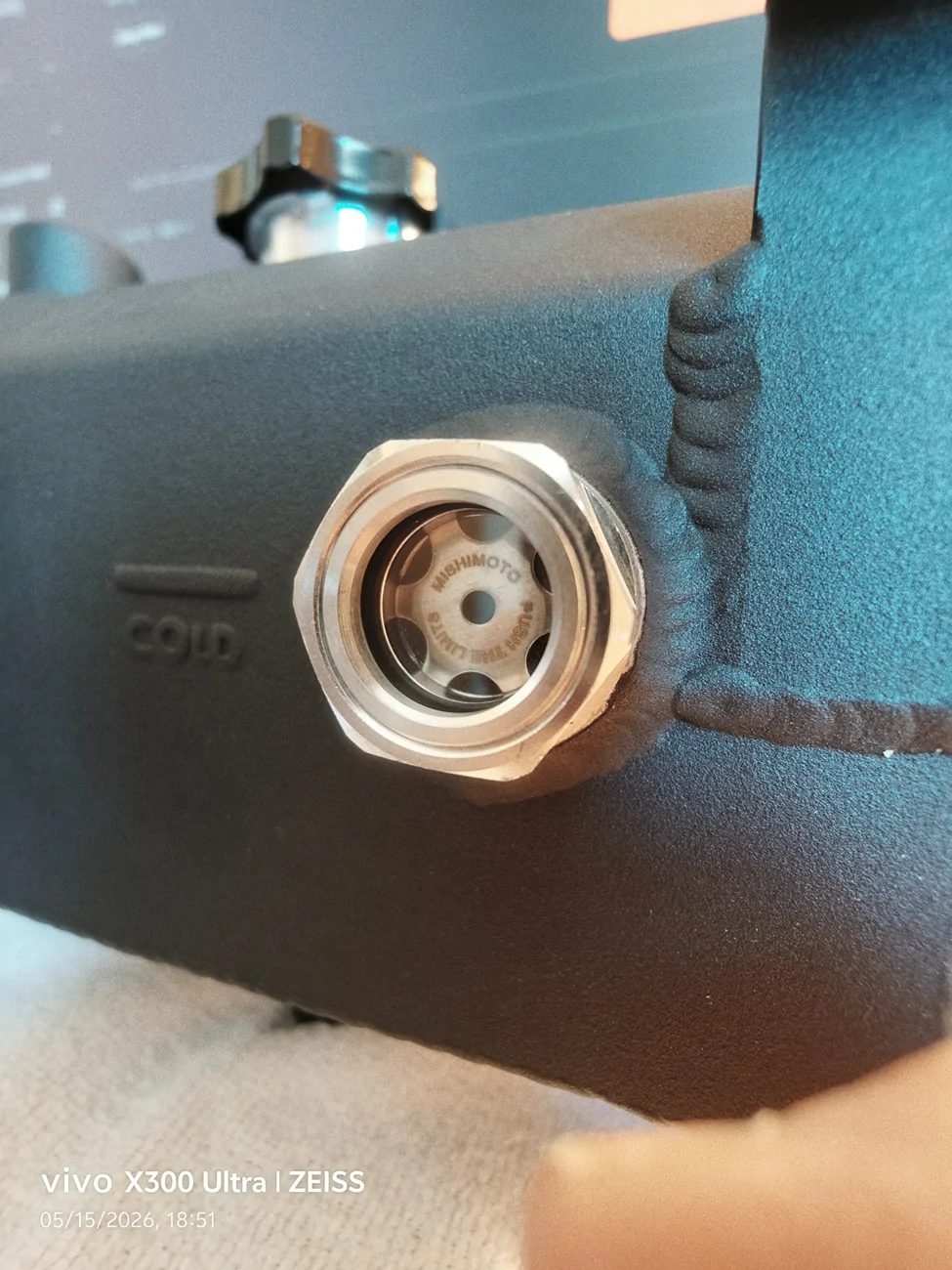

I have 45k mi on mine right now, no leaks yet but I ordered the T and elbow connector from Amazon(just needed the elbow and will get the Baja design for the T connector) . Ordering the Mishimoto coolant tank. I am not going to wait for mine to leak.
ScotM
Scot
Jan 3, 2023
38
1,240
1,902
Southern California
2022 Jeep Willy's JL 2 Door
I just ordered the elbow, going to assume at this point that the engineering on that will match up with the mishimoto tank. I know they built it to mate with their coolant tank, but we will see if it works with another tank.

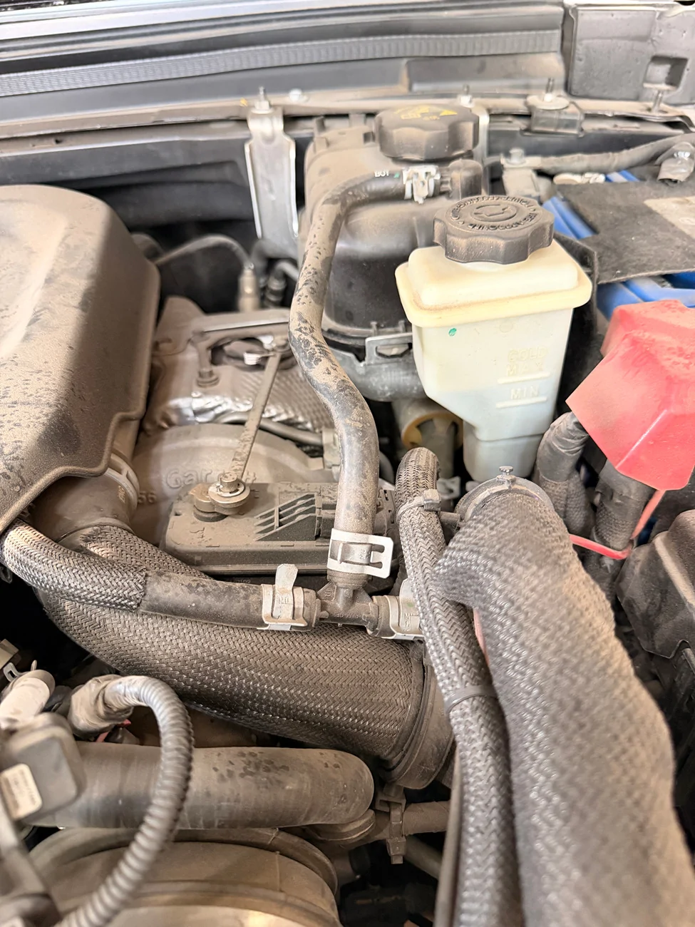

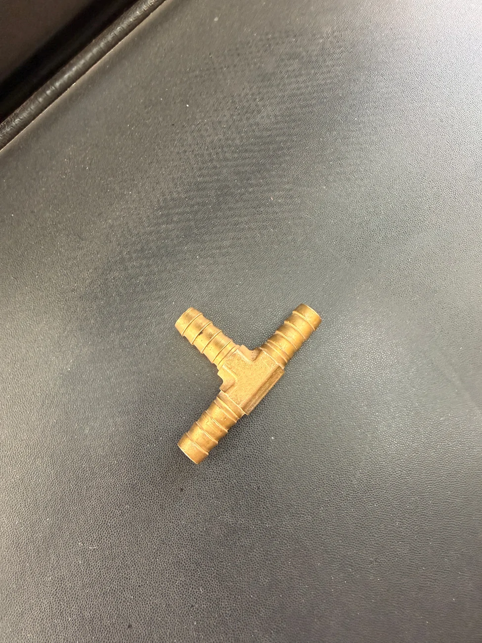

So I am in the process of replacing the weak parts which are bound to fail. My tank and heater hose T is on order but we came across this plastic joint also picture 1. My friend who takes care of all out vehicles and bikes had this brass fitting lying around so he swapped the plastic T with this. The plastic was brittle. Its almost the same size and fit easily.
Jeep Wrangler JL 2.0 Coolant Reservoir Replacement IMG_3843
Jeep Wrangler JL 2.0 Coolant Reservoir Replacement IMG_3844
croppz
Zach
Apr 6, 2026
393
692
North Carolina
2021 JLU Rubicon 2.0T
Got the size on that?
