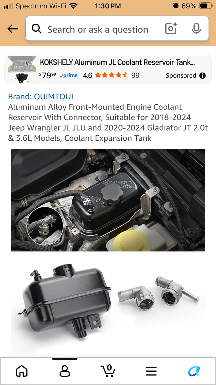

I think I'm gonna order the Chinesium tank which has an L shaped lower connection since that will eliminate another weak point along with the T and the Y and the heater hose fitting
That tank unfortunately has failures and zero warranty (or baffles in the tank). The mishi is baffled and has a lifetime warranty against failures. Up to you obviously but the Amazon seller isn’t gonna care they sold you a bad product

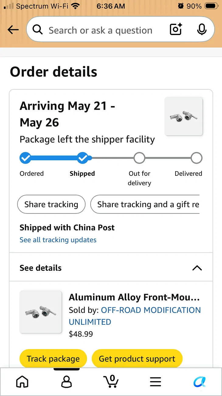

Looks like they were able to ship mine.

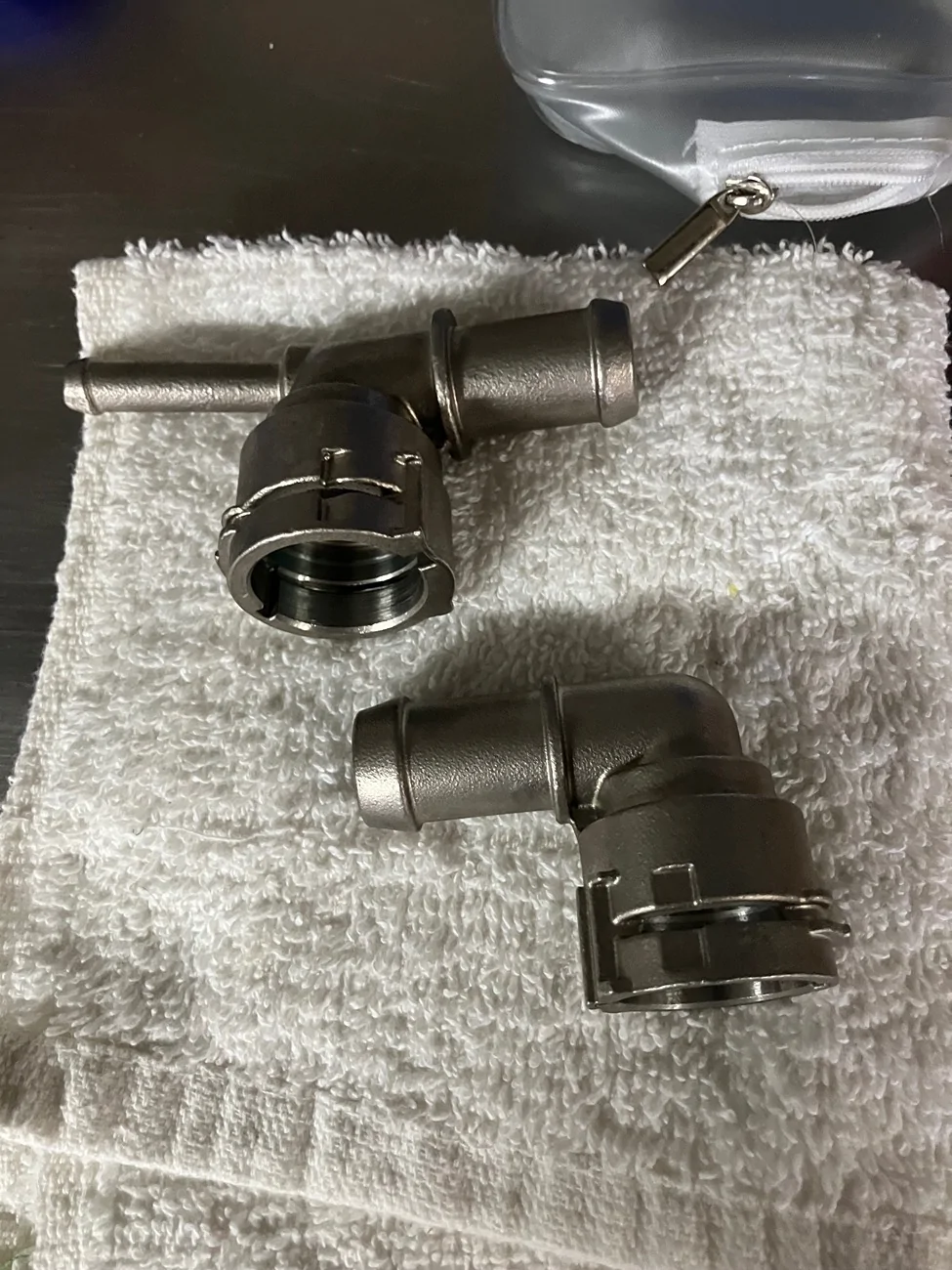

I ordered just the replacement elbow and T from the Amazon supplier, they sent the whole kit, including the tank. At any rate has anyone tried the elbow on the Mishimoto tank yet? I’m going to wait until I see some leakage from under my tank, before I tear the whole thing apart and try it. the elbow fits really nicely on their tank for sure.

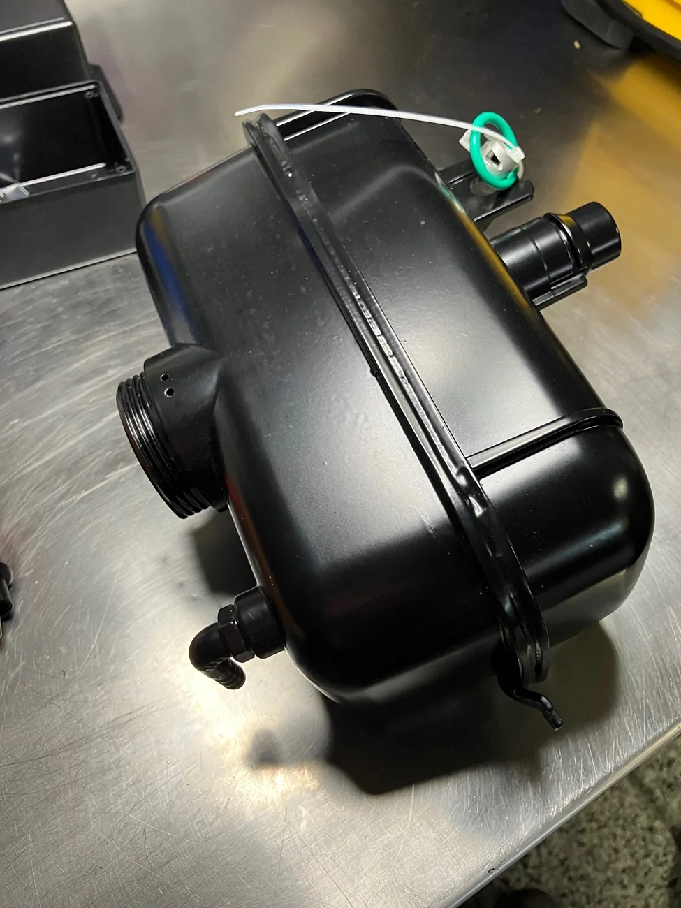

Mine just arrived. Loving the build and design features of this coolant tank. The fluid level window quick check simplifies everything. 10/10 for Mishimoto.
My tank arrived about a week ago and was looking at the bottom of that tank, what was the hole for found underneath?
TrailMax
Max
Apr 26, 2023
268
461
Arkansas
2023 Wrangler High Altitude 4xe
The one by the lower mounting tab? That's for the overflow if your coolant system builds up too much pressure. You can see the tube coming out just under the cap, then runs through the top of the tank to the bottom as a vent. Better down than everywhere!

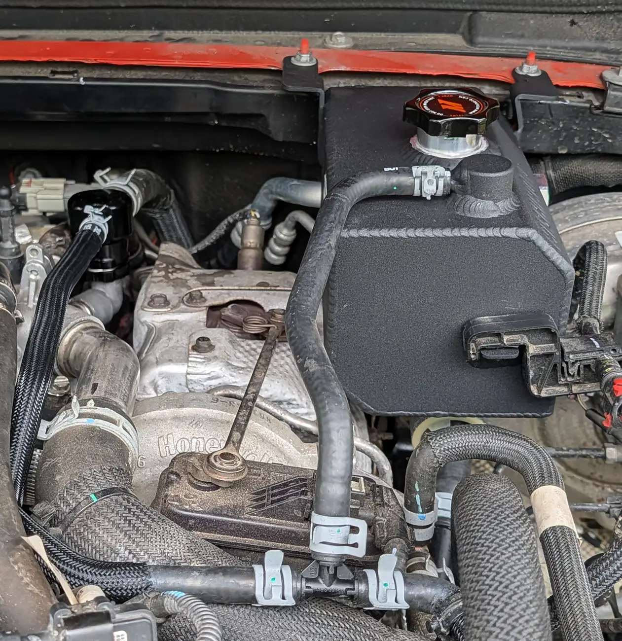

I just installed the Mishimoto tank and baja customs T fitting a few weeks ago. So far so good.

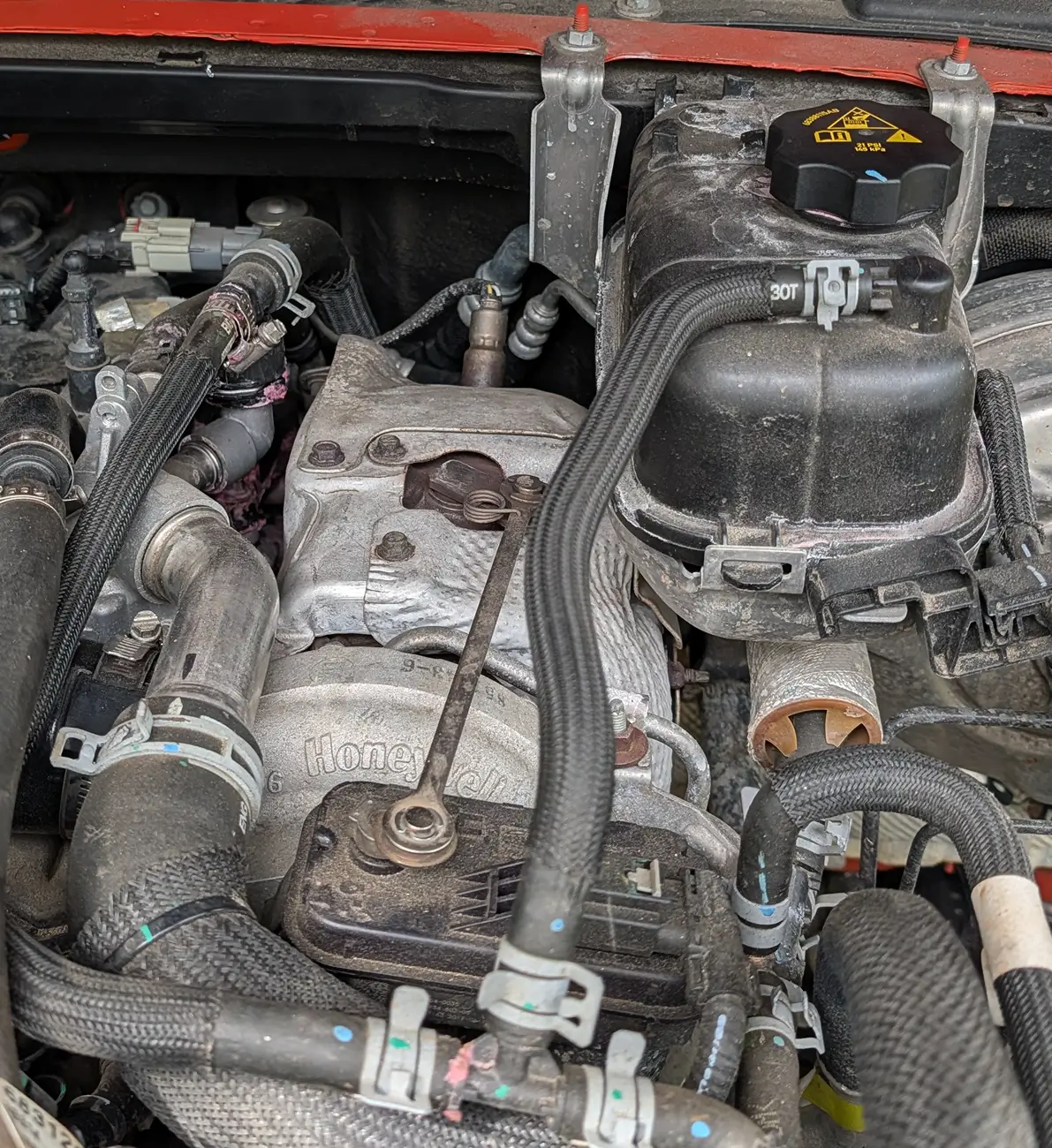

Before
Jeep Wrangler JL 2.0 Coolant Reservoir Replacement 1780424775182-es
After
Jeep Wrangler JL 2.0 Coolant Reservoir Replacement 1780424819894-pl
