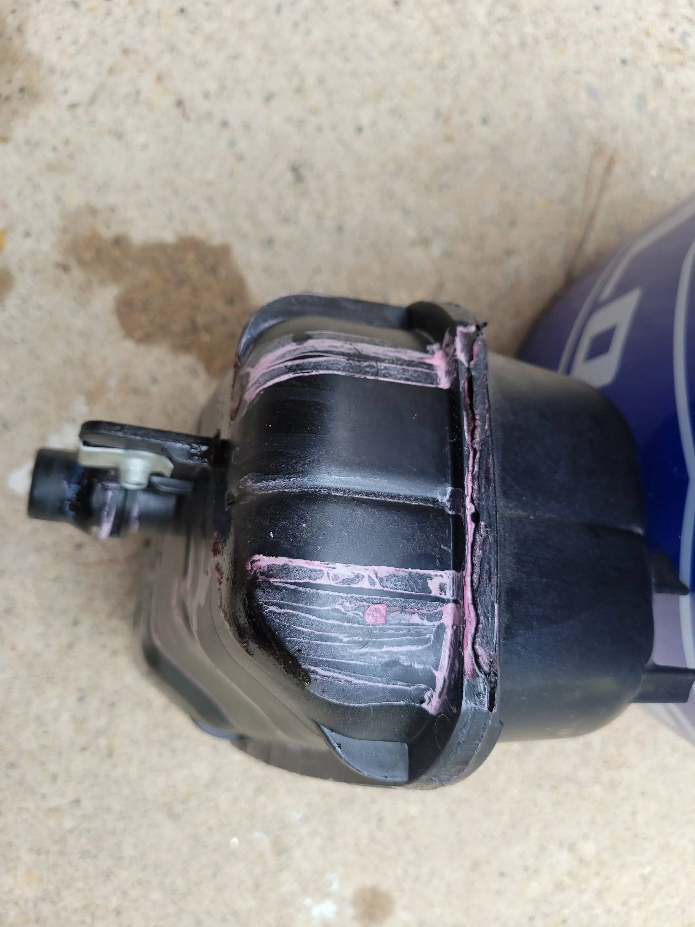

Also check your coolant reservoir. I had to replace mine a few months ago. Just did myself as the dealer was a few weeks out. I also keep a spare on hand now. I also had the water pump inlets tightened. The coolant level seems to be holding steady now.
Jeep Wrangler JL JL 2.0 coolant pressure test kit? 20230901_183007
