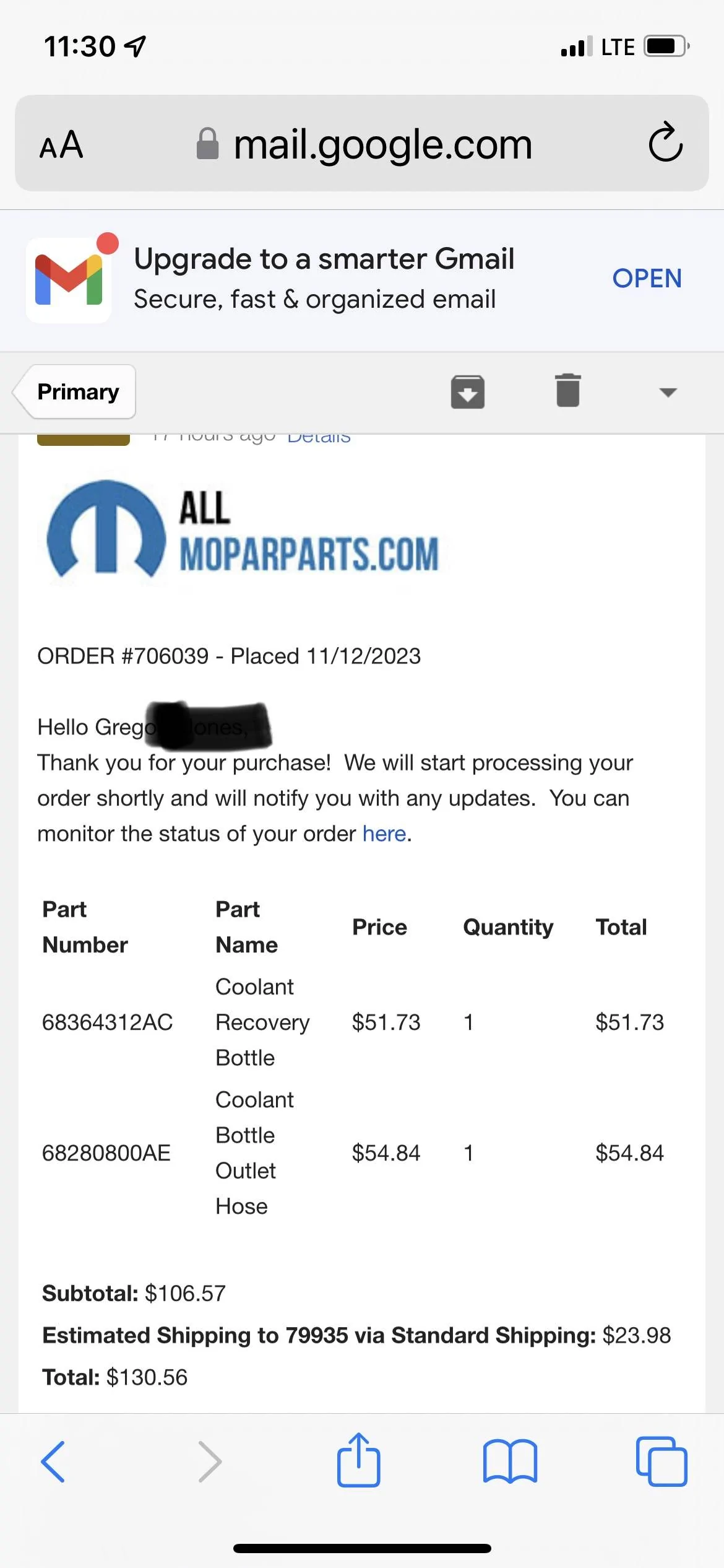

Boss Lady was complaining of a strange smell on start up. I crawled under it to look at the coolant neck that is the subject of many leaks and nope, not it! I did find pink liquid on the upper control arm on the drivers side. I traced it up to the coolant bottle, leaking at the fitting on the bottom.
Ordered the bottle and the hose from @allmoparparts $106.00 plus shipping.

Boss Lady’s Jeep has e-Torque so it has three. The one that is leaking is the black one between the turbo and the brake booster. Here are the parts I ordered. Waiting on confirmation from Allmoparparts.
Jeep Wrangler JL 2.0 coolant top off frequency 2195167A-4085-4872-BCA3-15BD50EA8D01

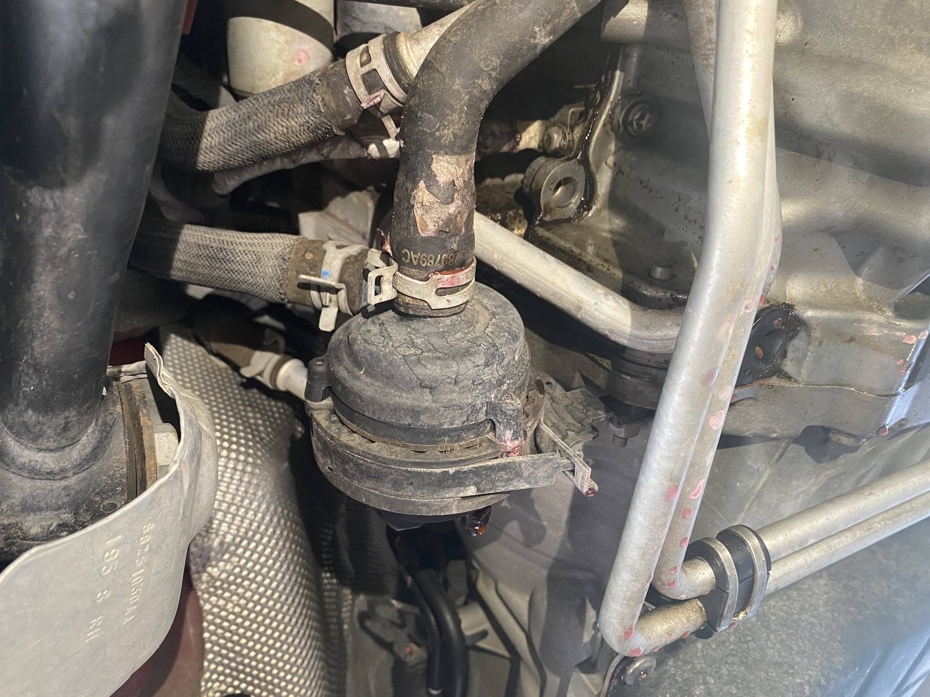

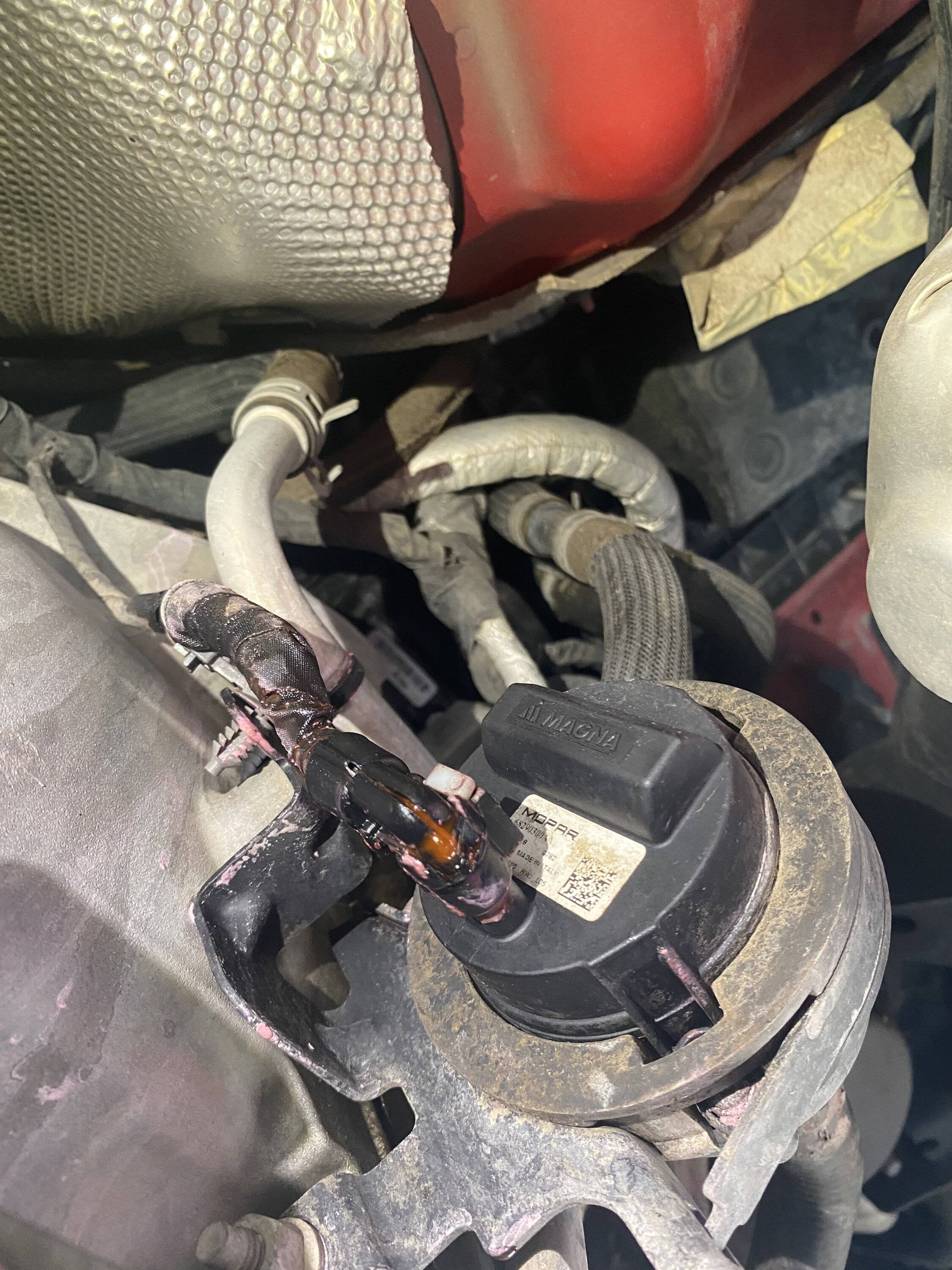

I am having the same issue (2018 JL 2.0 turbo) of needing to add coolant. But my issue seems to be with the auxiliary coolant pump (and/or hoses) for the Turbo, on the passenger side. Anyone else having this issue?
Jeep Wrangler JL 2.0 coolant top off frequency IMG_1503 2
Jeep Wrangler JL 2.0 coolant top off frequency IMG_1499

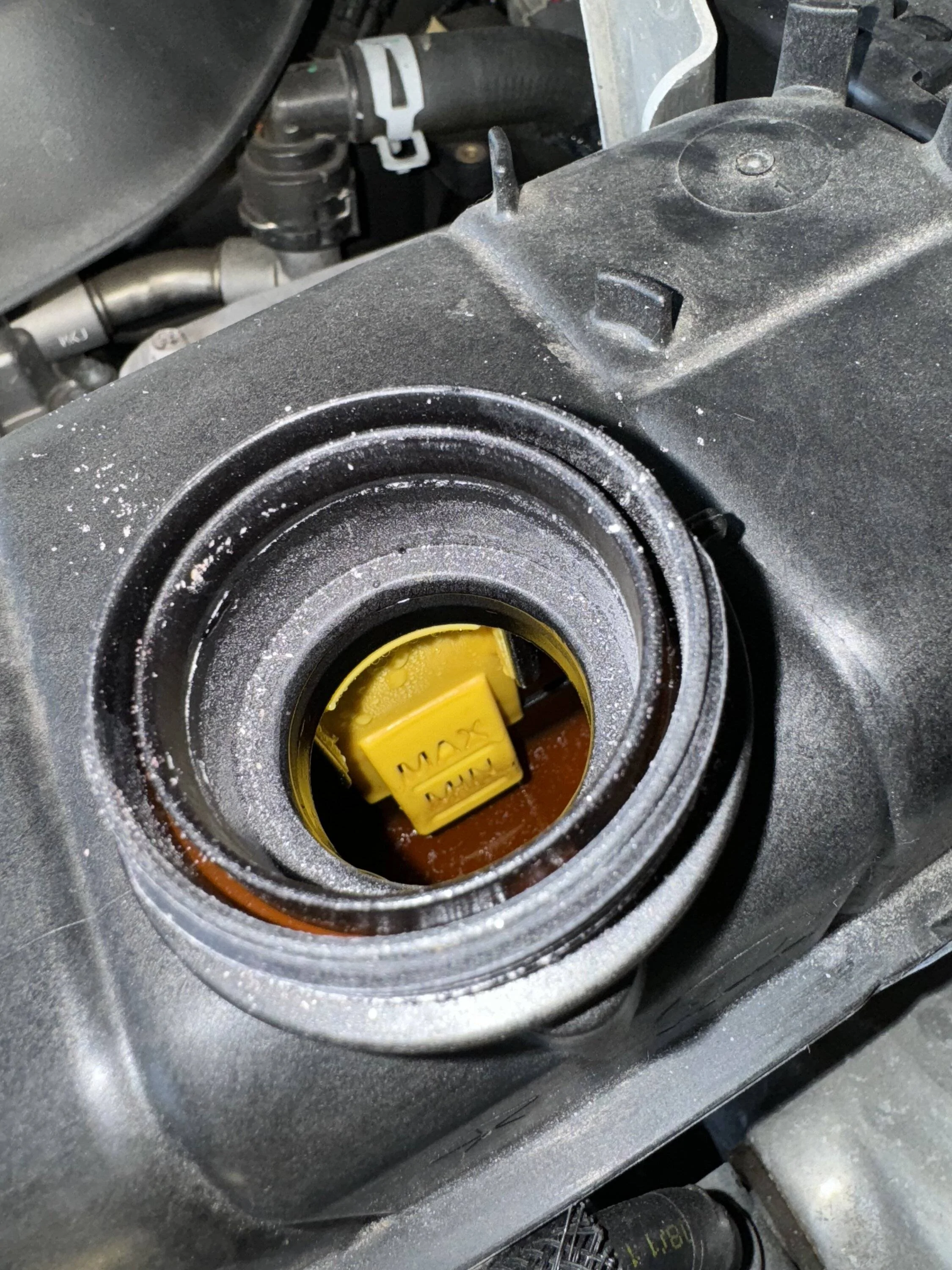

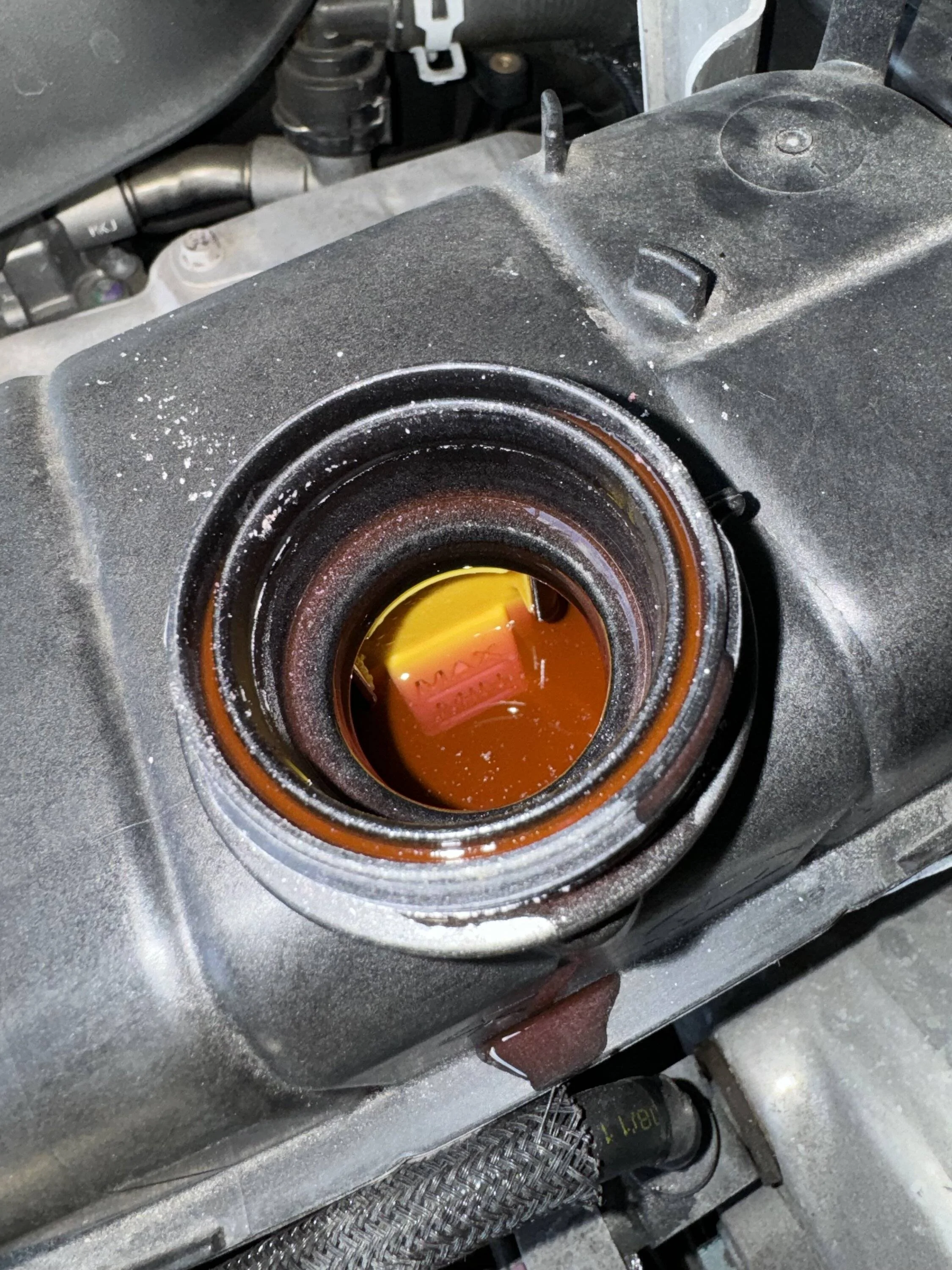

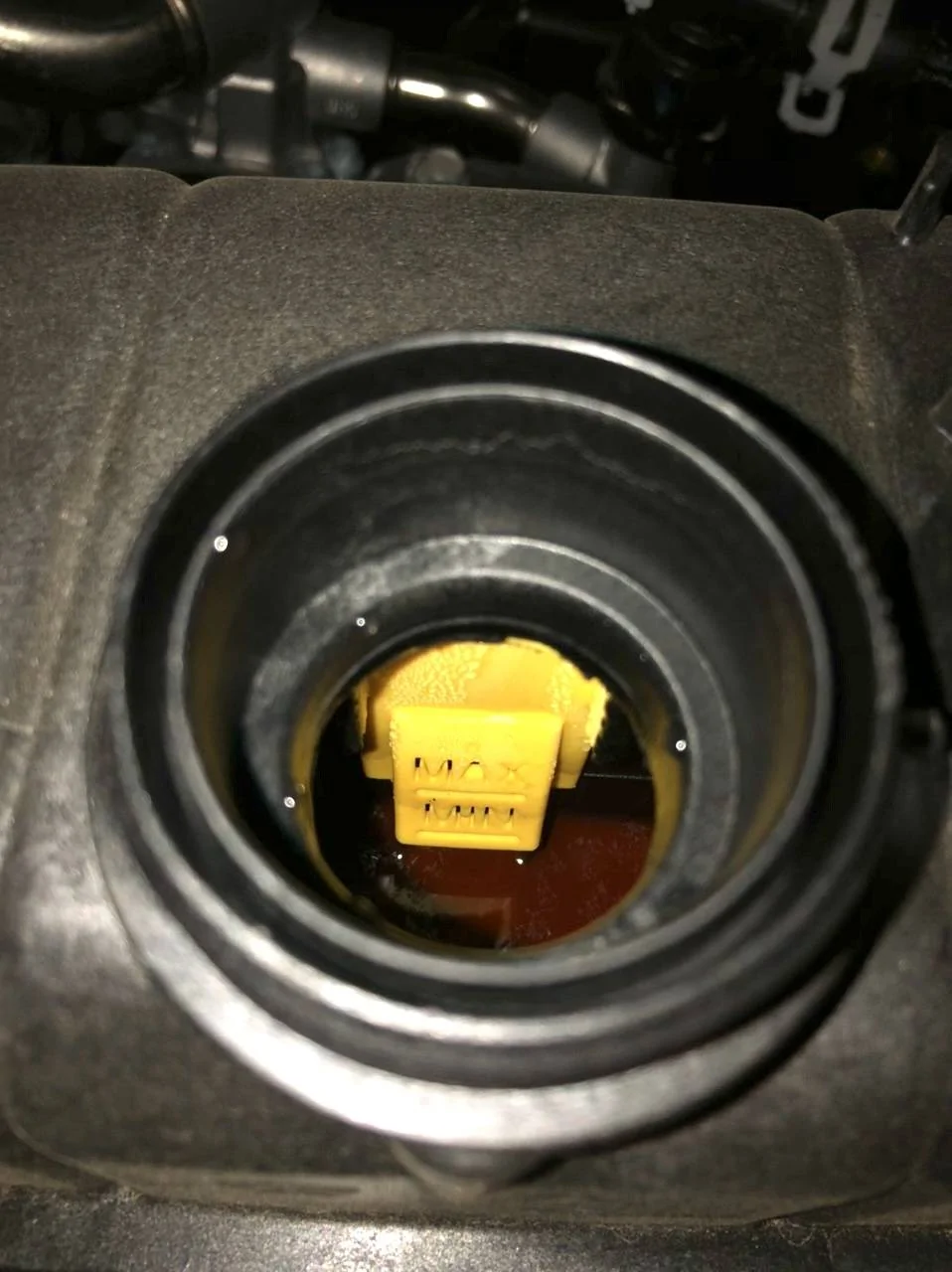

So 2 months ago on Oct 6 this was the level. I don’t remember if it was dry at one point but I vaguely remember fiddling with the dipstick. Topped it off then to the max line. I’m hoping it’s just that it had to flow through the system or something and make its way through the rest of it.
Jeep Wrangler JL 2.0 coolant top off frequency IMG_1358
December 7 last week before a roadtrip. Gonna check the coolant level after work today since it’s been about 1.2k miles since topping it off before the trip. But the water pump looks like it never leaked from there, but I haven’t checked the reservoir itself yet.

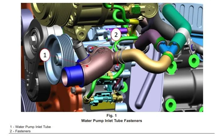

Does anyone have a pic of the waterpump from below? Trying to find someway for me to locate and check but not sure exactly what it looks like.
thanks in advance
Not sure if this will help. It's the graphic taken from TSB 07-001-22 REV. A, regarding the water pump inlet tube fasteners. If these fasteners aren't correctly torqued, coolant will slowly leak from them.
Jeep Wrangler JL 2.0 coolant top off frequency Water pump Inlet Tube Fasteners
