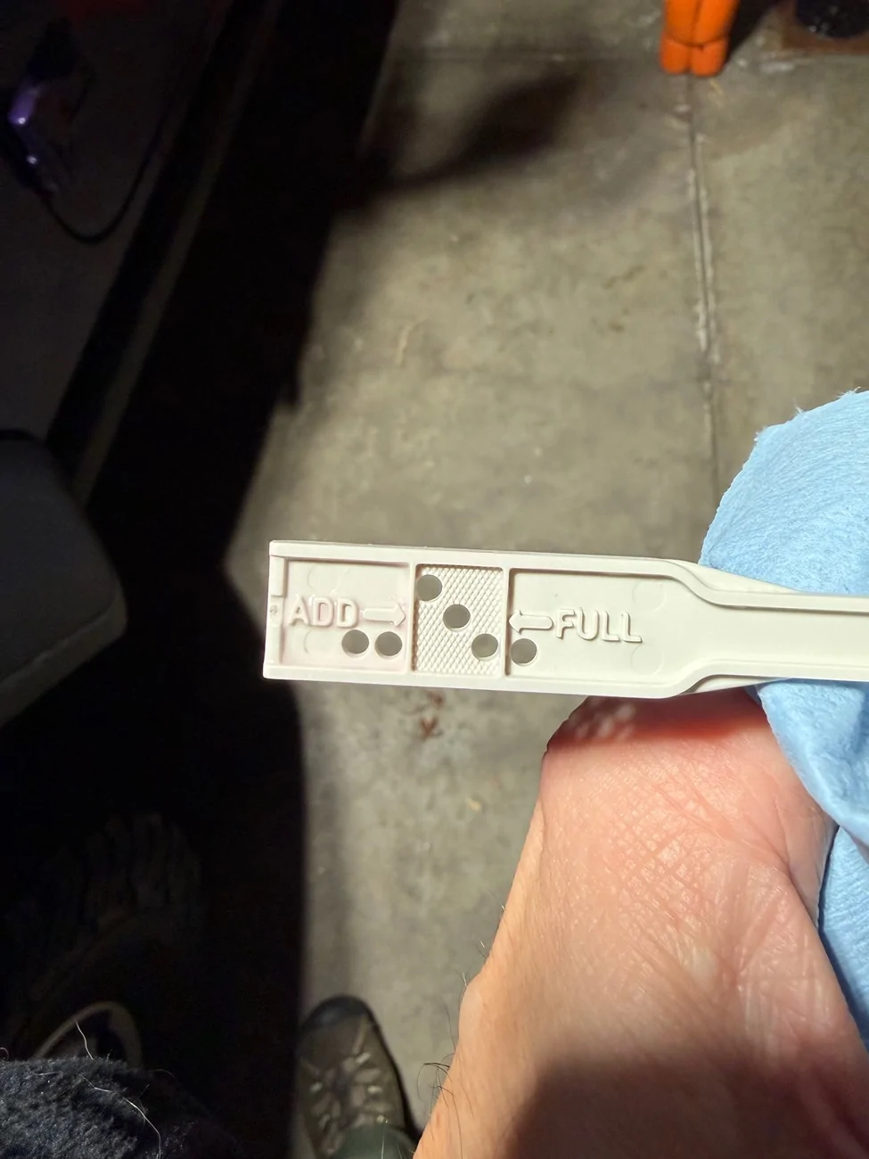

When you pull out the dipstick, those bottom two holes should be filled with liquid . Are they? I know it looks like pink coolant on the stick, but if those holes aren’t filled , then the coolant is lower than you think. Note, my 2023 came a full 16 oz low on coolant from the factory.

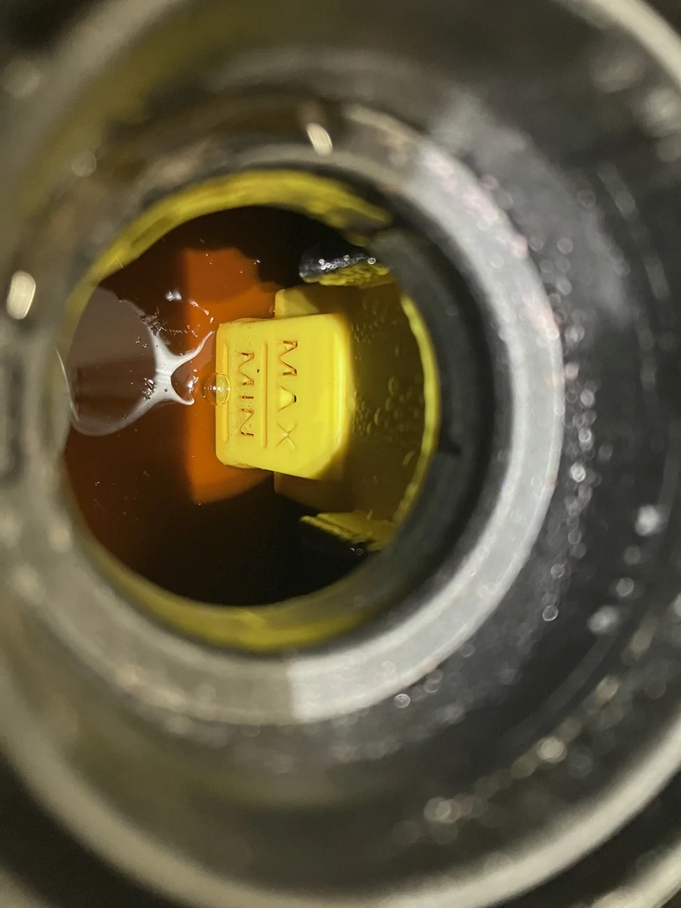

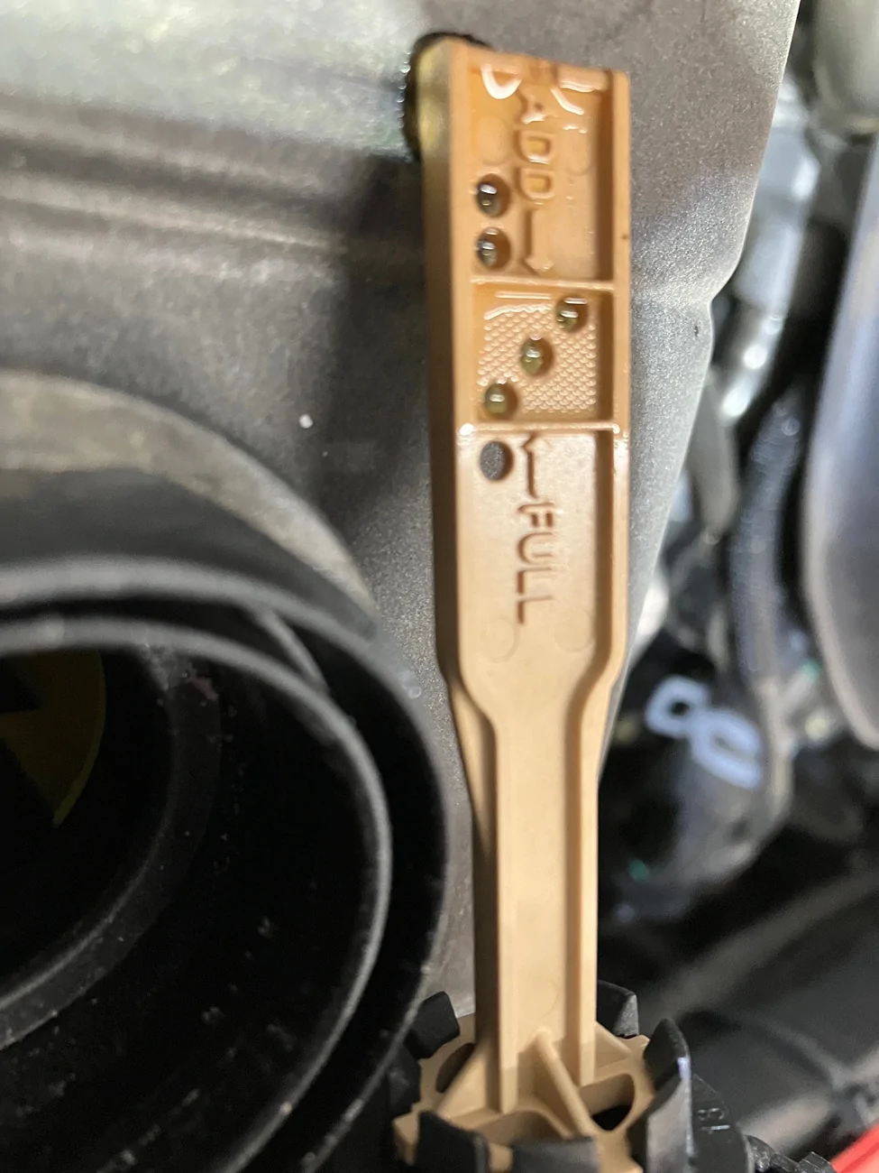

I learned that there is another way to see the fill line. Take a flashlight and look inside the reservoir you’ll see the max fill level.
Ah yes. When my dipstick is at 'full' the internal indicator is just below 'min'. I don't think it is critical. When cold it needs to have some coolant in it and not so much that it overflows when hot.

Have ordered new a 21, 22 and 25. All three required adding coolant when new. The 21 took the most, then the 22 then the 25. The 25 only took about a cup and a half.
I check the level by just taking a flash photo down the fill neck. Thankfully they included a level indicator inside the tank.
It was very shocking when I checked my 21 a couple days after I got her home. The tank was dry.
