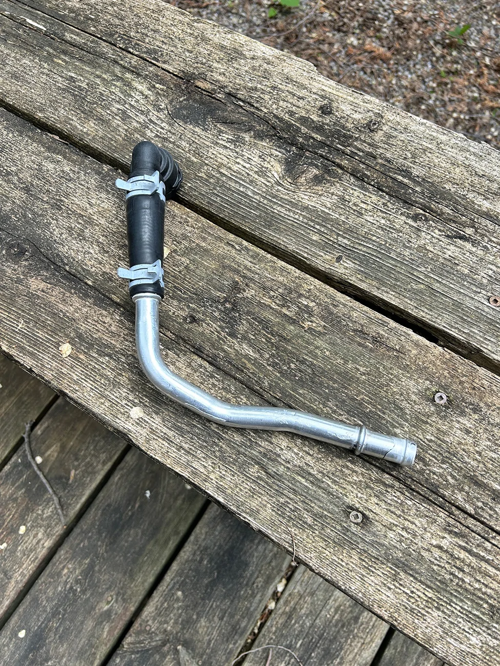

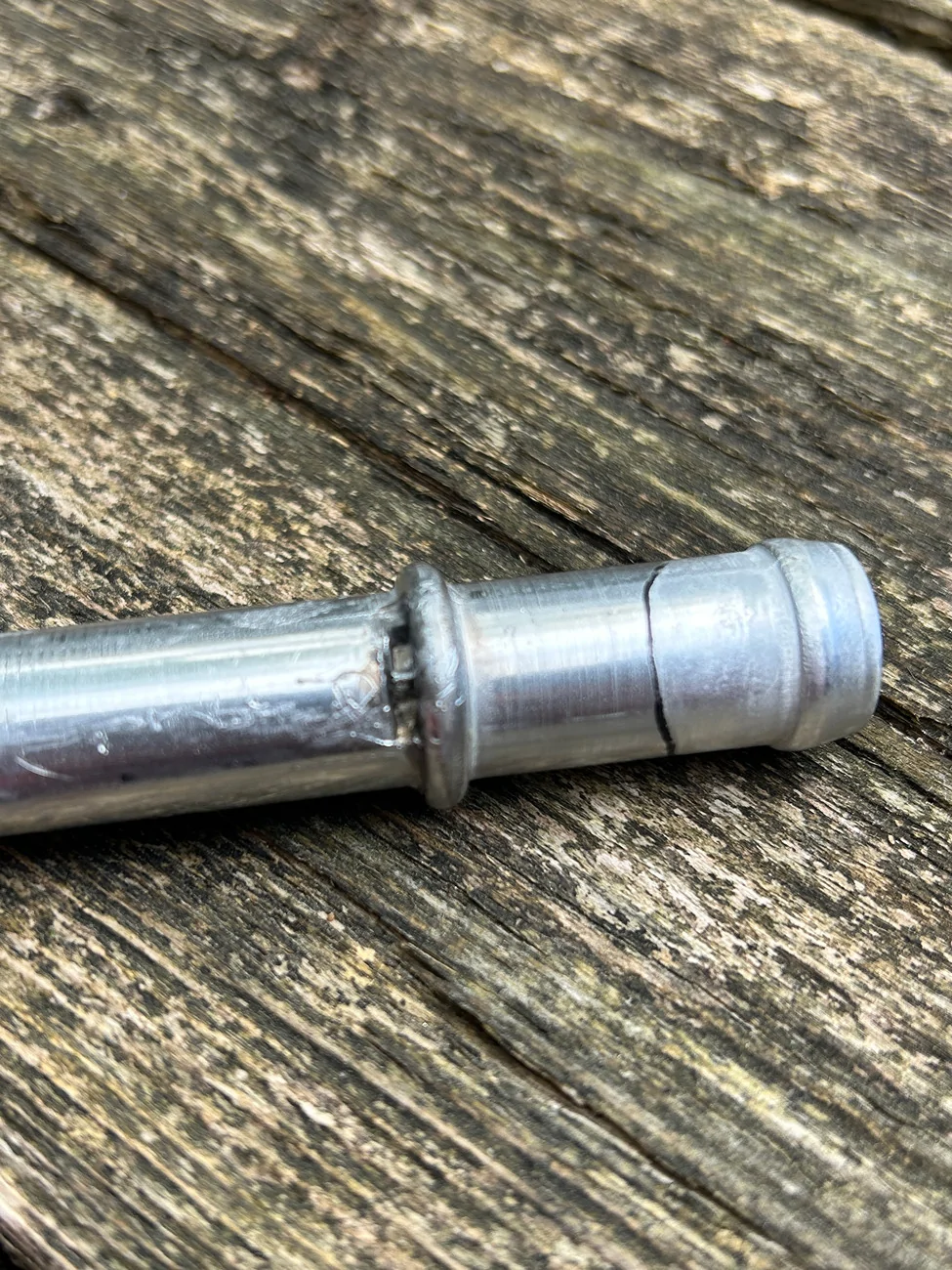

Did you replace the coolant tank and pipe as mentioned @SIGP2101 before you noticed the tank empty for the second time?
No, I did not. Still trying to establish the leak. No visible trace. Any way to pressure test only the tank? I will have to evacuate coolant, remove tank and find the way to test it somehow.

It Finally I wiggled part out to be able to inspect it. It looks like that there is factory inflicted pinch right at the flange as you can see it on second image. This car has never been to any mechanic and this is first trouble after 5 years of ownership.
