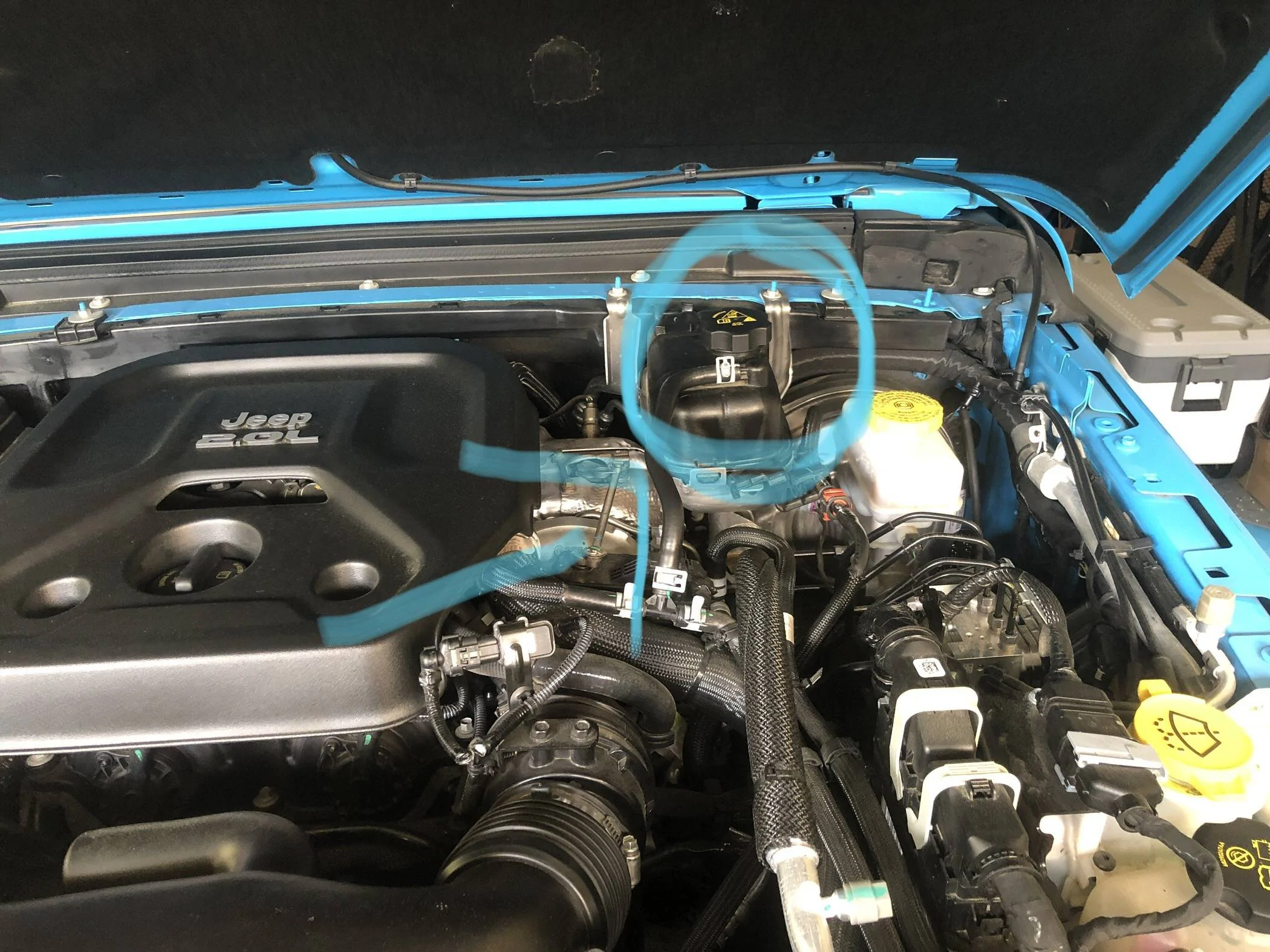

Probably leaking from hose clamp. They are not the best and can leave you stranded.
Check for discoloration around the hoses.
Also, your Jeep can benefit greatly.... if you change out the rubber hoses -for hi-temp silicone replacements. Not sure why Jeep is still utilizing rubber hoses in a such a potentionally hot engine compartment.
Changed mine to properly sized constant-tension hose clamps & hi temp reinforced silicone hoses.

How did you diagnose the leak location? Was there evidence a trail?
Nothing visible on the ground but when you move the mess of hoses and look down towards the diff I could see the pink staining And some accumulation on top of the diff itself. Initial when I added water after over heating it was also leaking out of the hose in the bottom of the reservoir. After fiddling with it a bit that particular leak seems to have sealed back up.
