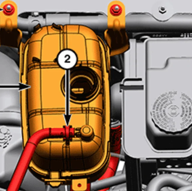

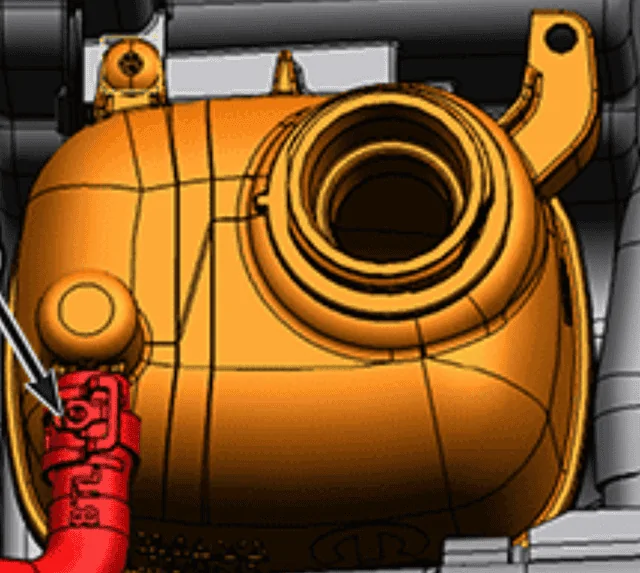

The res on the firewall is engine coolant. The smaller res near the front is intercooler.
Both use the same coolant.
There is a fluid level indicator inside the large res so you don’t have to check with a dipstick.
The intercooler res has level indicator on the res.
A subscription to AllDataDIY.com isn't for everybody (price being the main issue), but for those who may be curious as to what's over there, I thought I'd provide a sample of how it identifies these two coolant tanks for my 2021 JLUR without eTorque.
Colored ORANGE for illustration, here's the shape of the tank that you're looking for near the firewall:

Again, colored ORANGE for illustration, here's the shape of the transparent tank that you're looking for near the front:
Jeep Wrangler JL 2.0 coolant top off frequency 1651590774669
It does a really good job of capturing the exact shape (and relative position) for the items in question. But the size of an item won't always be to scale from picture-to-picture so you have to watch out for that. And in this case, because it uses ORANGE to identify the items in question, you don't get to see which one is solid and which is transparent.
Despite that, the images provided by AllDataDIY seem more than enough to find what you're looking for.
