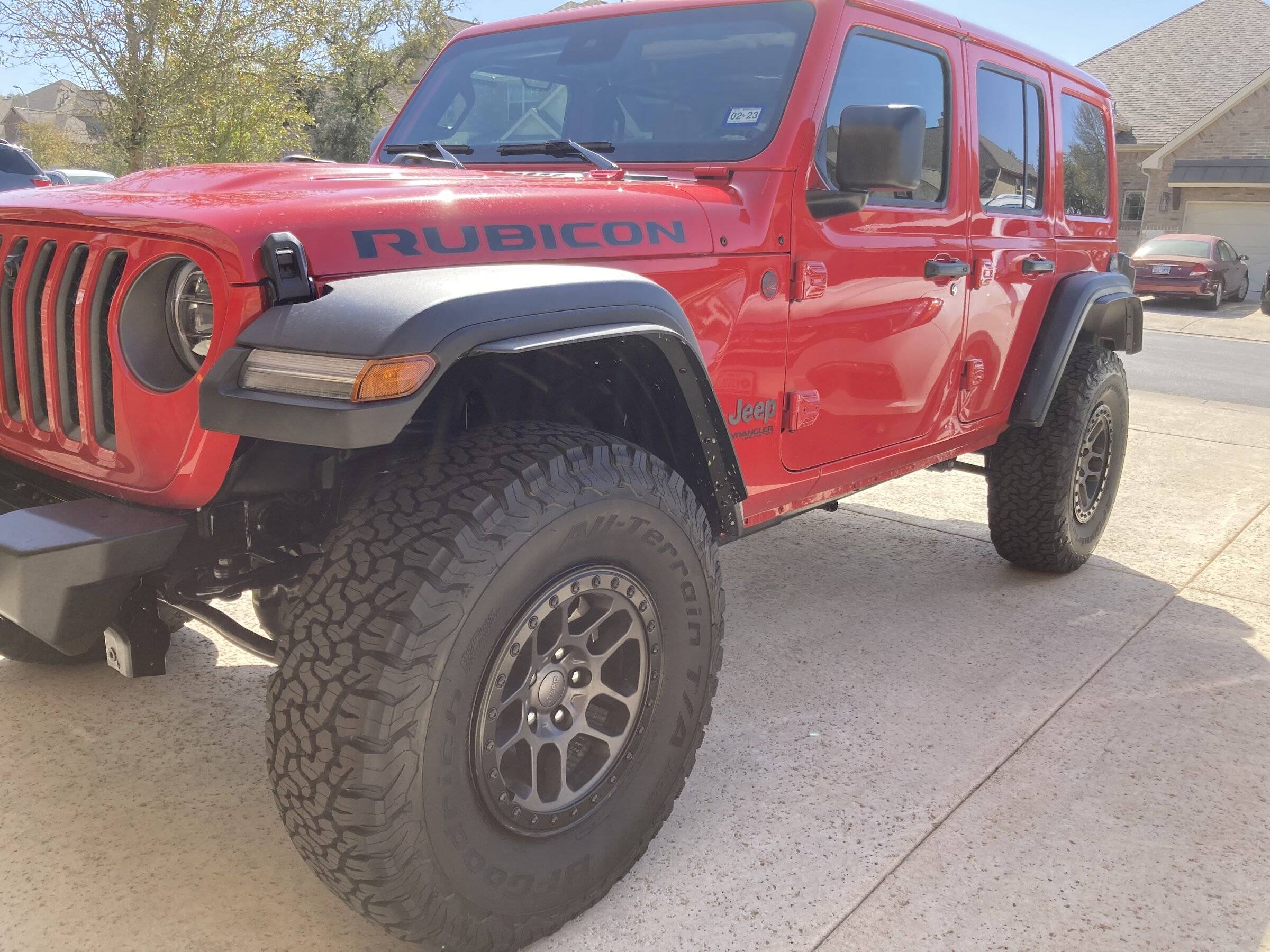

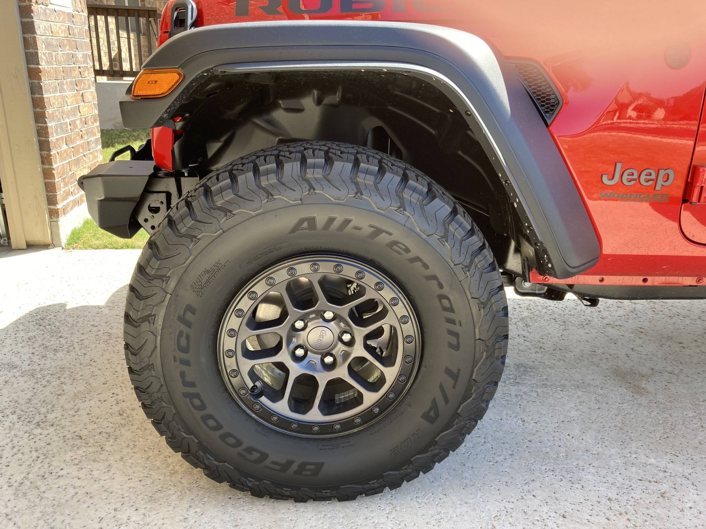

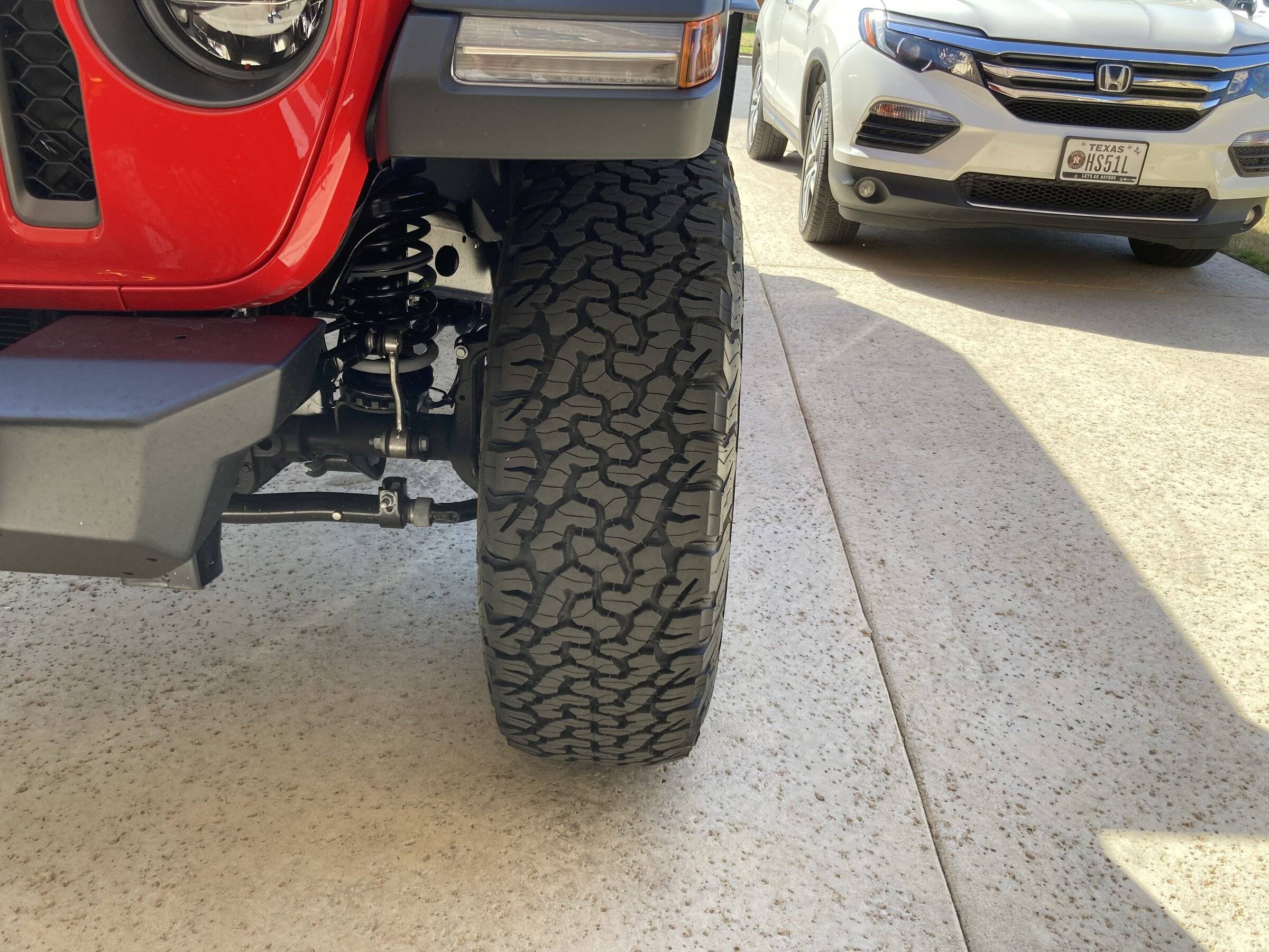

Unless your lift or spacer or whatever else has been mentioned in this thread to "add breathing room" includes more bump stop, you didn't add any breathing room. Your suspension will still compress to the exact same place as the pics the OP posted. Not saying the spacer or lift skirting is useless, as you did all add uptravel from ride height, but ultimately your bumpstops are what keep your tires out of your fenders. Unless you added shocks so long that they act as bumpstops, but you'd be better off letting a tire rub the fender.

Splitting the fenders added the room for the tire to stuff. Lifts don't add tire clearance. Bumpstops or moving the parts that would rub does. If you can run a tire at 3.5" of lift and not rub you can run it with no lift, you just might be riding around on the bumpstops.

Agreed and I didn't say anything different. Just pointing out that the XR bump stops are at the right height for this configuration.
