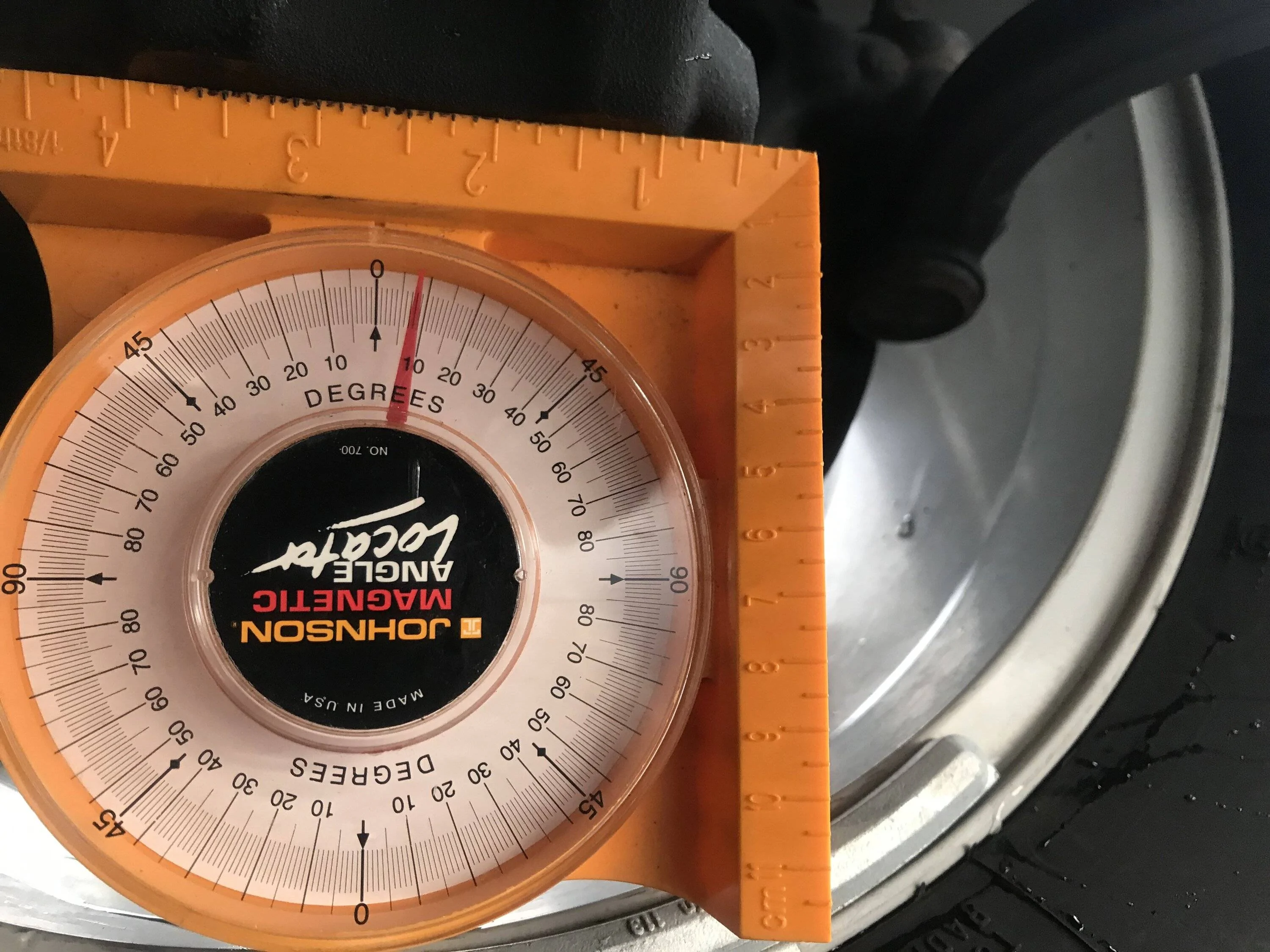

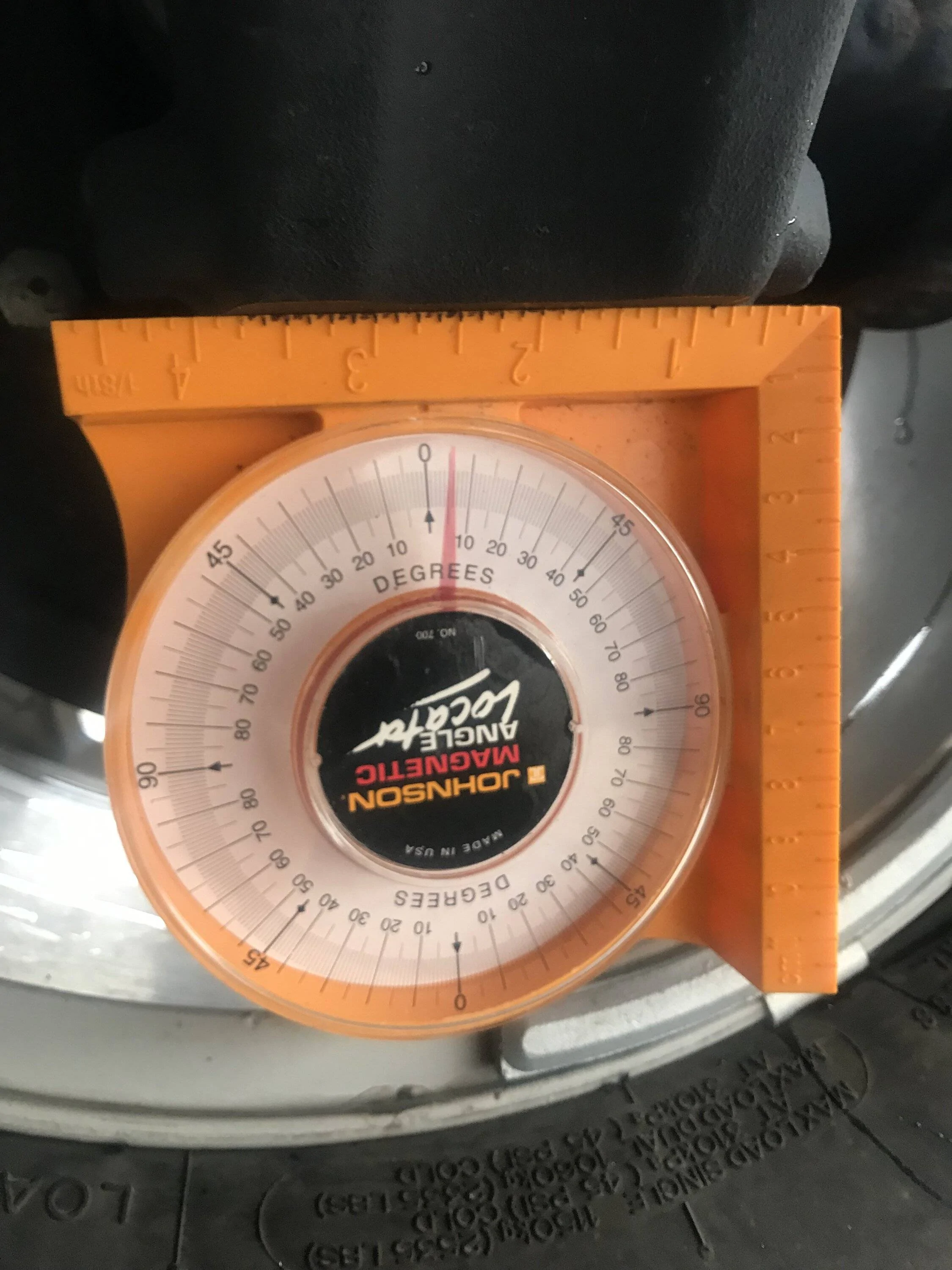

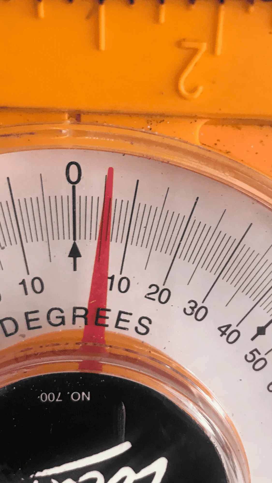

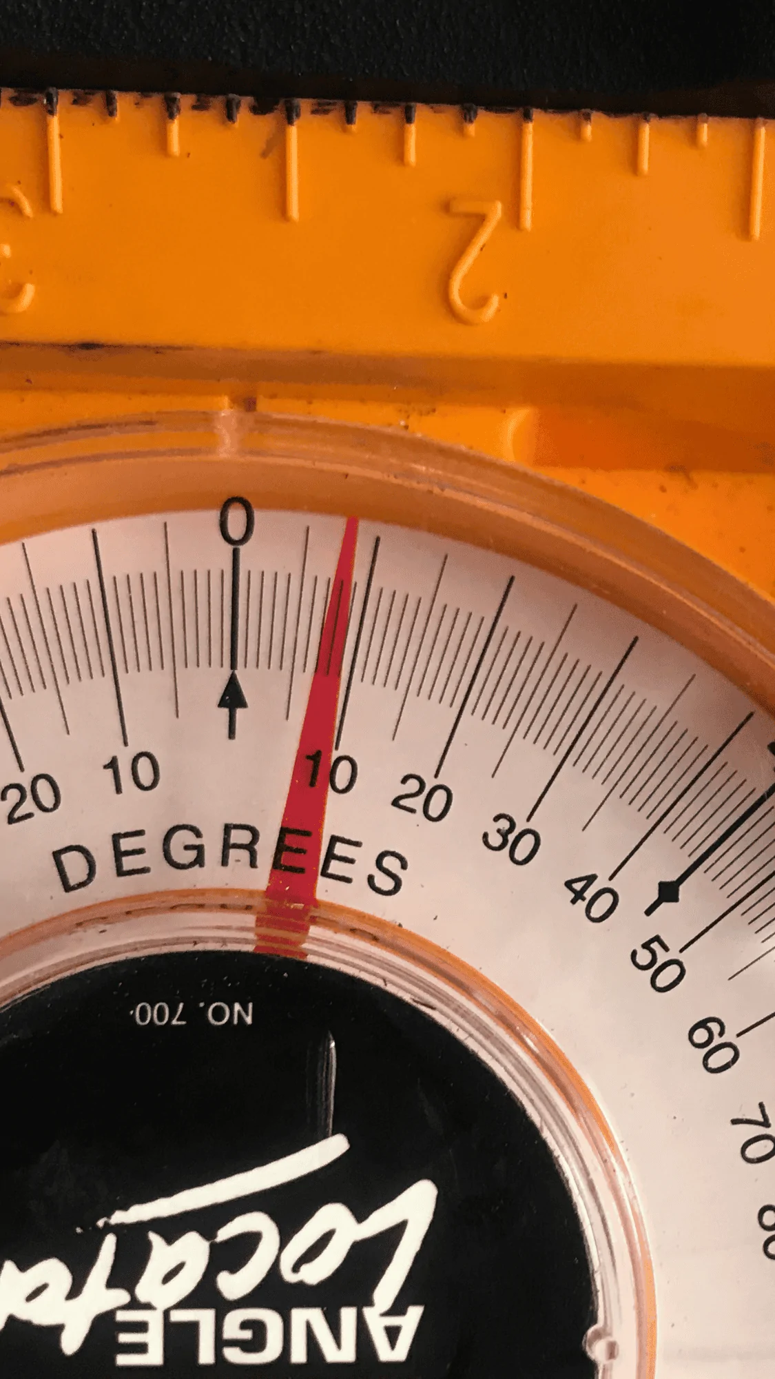

Just wanted to add another successful JL Rubi XR Mopar LCA swap. Agree night and day difference in drivability. Angle gauge on lower knuckle results looks like I picked up 2-3 degrees! Spend the $70 if your on the fence...Easy install & well worth it!
Happy Trails,
Scooter

Is 8 degrees a little high for pinion angle? Looks like you had the magic 6 before the lca's?
This was the level gauge on my lower knuckle showing before and after numbers. I don't know what my exact caster number is but this shows that the longer Mopar arms definitely give you a increase. The arms really don't affect the pinion angle at all. All I know is that for my Jeep it made a "HUGE" difference in how it drives...
Happy Trails,
Scooter
