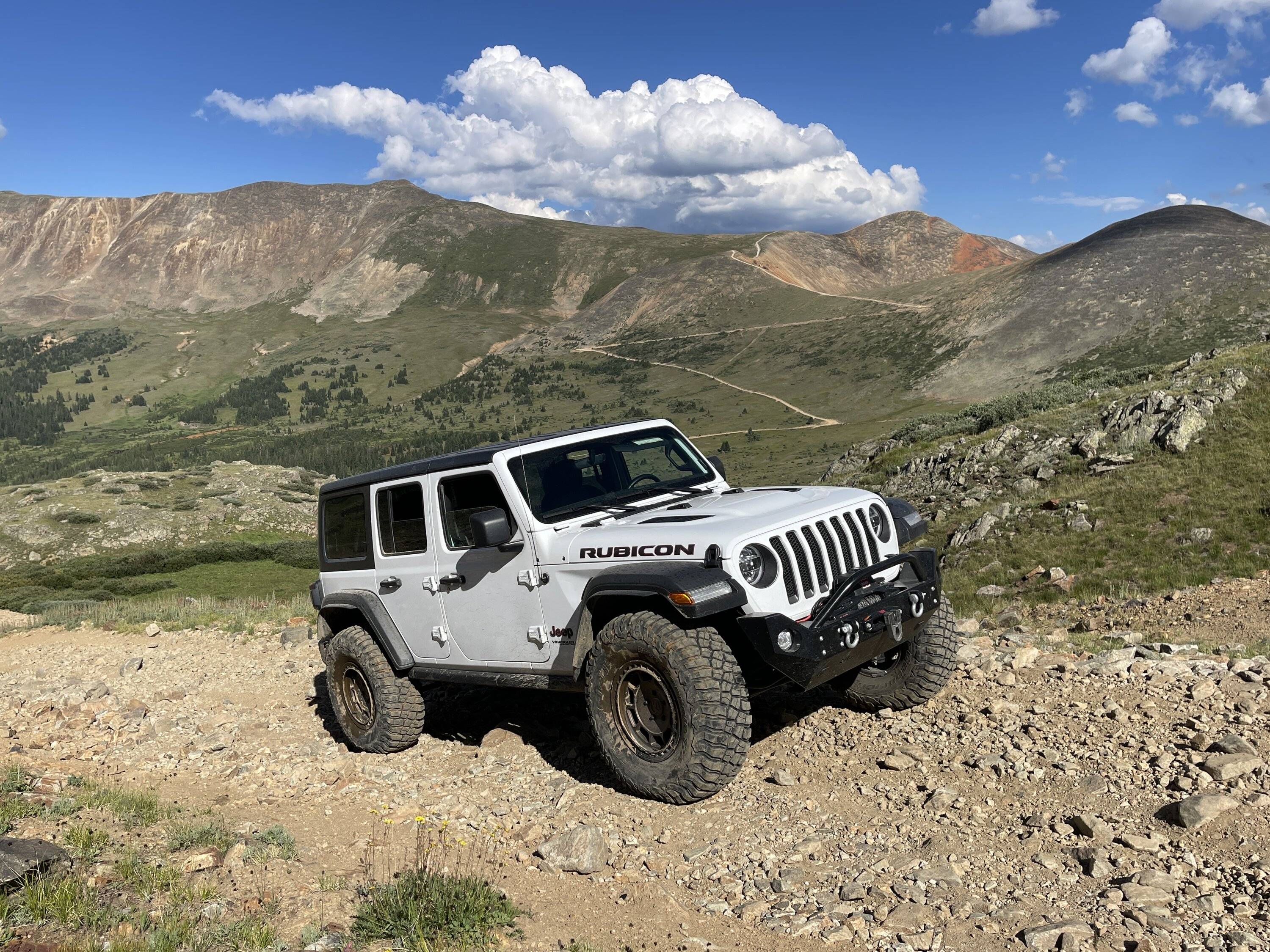

Now, almost a year later and 18k miles, stock suspension. I added aluminum front bumper & winch and underbody skid plates & new wheels and 37’s. No need for spacers or lift or anything and I’ve taken it Offroad all over Colorado, Utah & Southern California.
