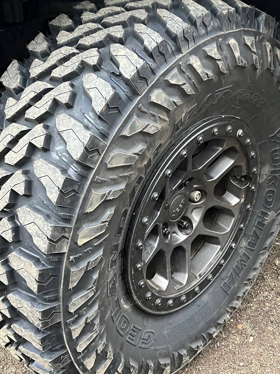

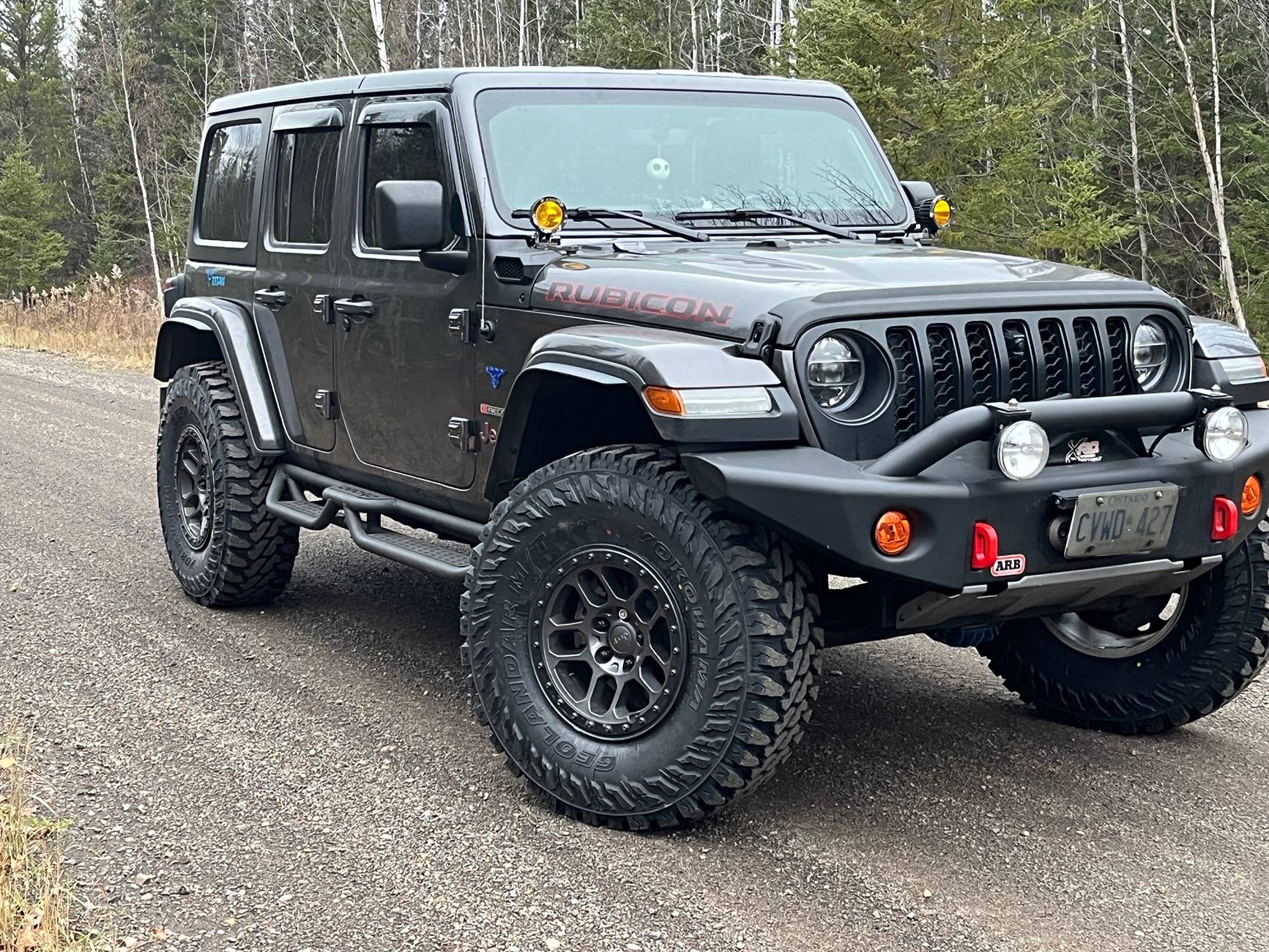

I just changed up to my second set of 37s on factory wheels. Gonna try out these Yokohama Geolandar MT G003 37x12.50x17.
Jeep Wrangler JL 37s on xtreme recon package? IMG_0920
Jeep Wrangler JL 37s on xtreme recon package? IMG_0922

On a side note. My tire guy couldn’t mount these tires on my XR rims without taking the rock rings off. The bead protector on the tires were too thick and heavy for his machine. This is the 3rd set of tires he has put on for me but the first time the rings had to come off.

They are on now, in the photo. Did you put them back on or did he remove only to install, then put them back on?
I will likely use Discount Tire. They have done well for me in the past.
He removed the rings, mounted the tires, re installed the rings then balanced the tires.
