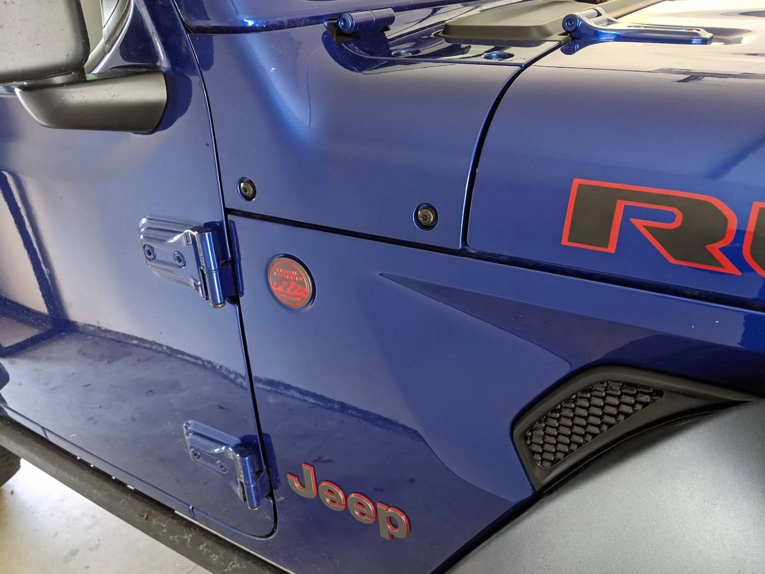

Another option:
Right Hand Drive models are inconvenient in the correct-side driving world.
Antennas are sized to the wavelength of the frequency band in which they operate. They can be made smaller in fractional amounts (e.g. 1/2, 1/4 wave) by several different methods to emulate a bigger antenna (e.g. windings around antenna, bottom coils, etc.) but all of these are generally less efficient and therefore have less performance. That's why a "stubby" rubber duck antenna might work in the city but not receive signals in the suburbs.
And that's why many report poor performance of their GMRS, CB, etc. radios when they mount a small or stealth antenna for looks. If the terrain (i.e. trees) allow it, I use a 5 ft. CB antenna that always outperforms more expensive radios using a 2 ft. antenna. I also have 3 ft. and 2 ft. antennas that I use as required (i.e. trees, garage). They're all 5/8 wave, but the "tricks" used to emulate a 5/8 wave is less efficient the shorter the antenna.
AnnDee4444
Jan 14, 2019
54
5,529
7,948
'18 JLR 2.0
Cool.
It's just a 2nd trail rated badge for my antenna delete... and right had drive doesn't change the antenna side anyway.
