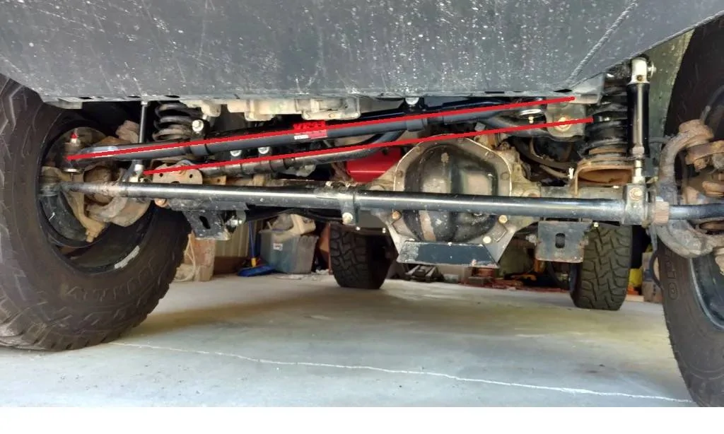

So... help a brother out. What DOES cure bump steer? In the posts above they claim making the drag link and track bar parallel will. Do you refute that?
Yes the drag link and track bar need to be parallel along the horizontal plane...which just centering your axle won't do. this one of my JK's
It's the length of the two link bars (drag link & track bar a.k.a panhard bar), and their mounting points in relation to each other. When they cycle through their range of motion, you want both axle-side ends to move in similar paths. Paths that are not similar will have noticable bump steer. Parallel could be good or bad depending on bar length and mounting locations.
