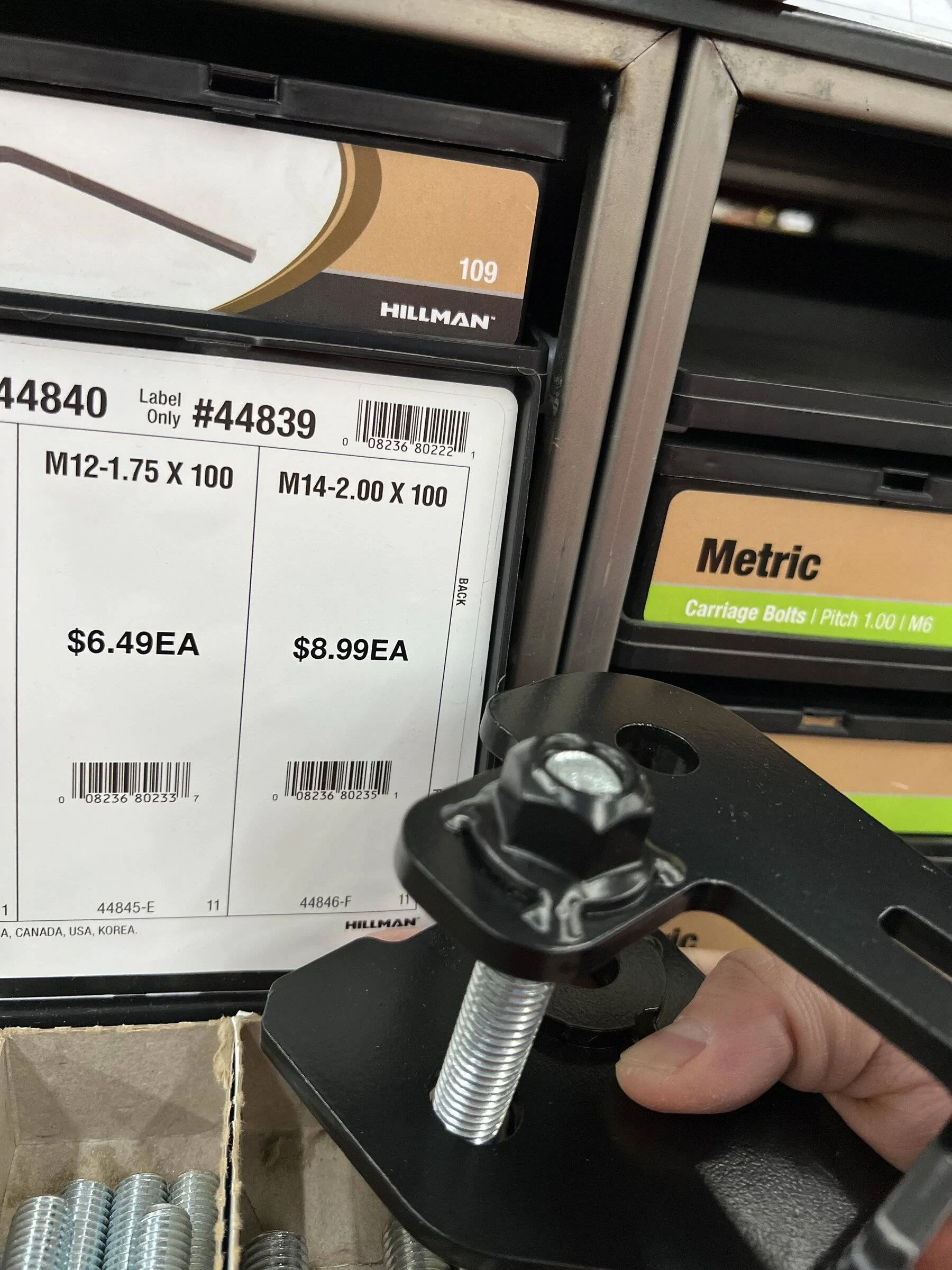

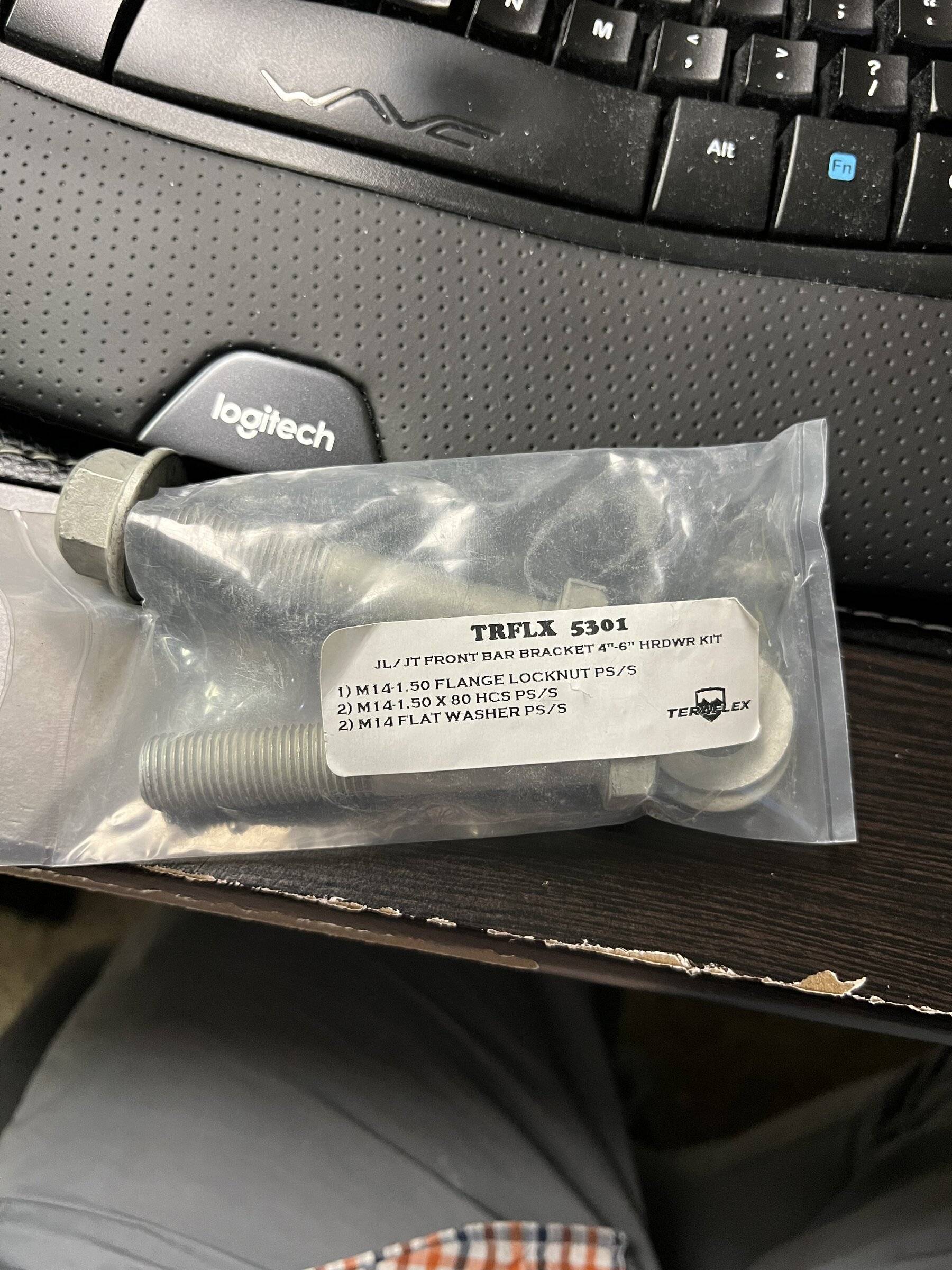

My bracket had the wrong threaded nut welded on the bracket. Teraflex shipped me a new one.
M14-2.0
Jeep Wrangler JL BUMP Steer EC2793CD-79A6-4040-B607-778BB42E09CA
M14-1.5
Jeep Wrangler JL BUMP Steer A5489BBD-D600-4559-8FCF-D603AEC96BD7
Explains why it didn’t fit.
