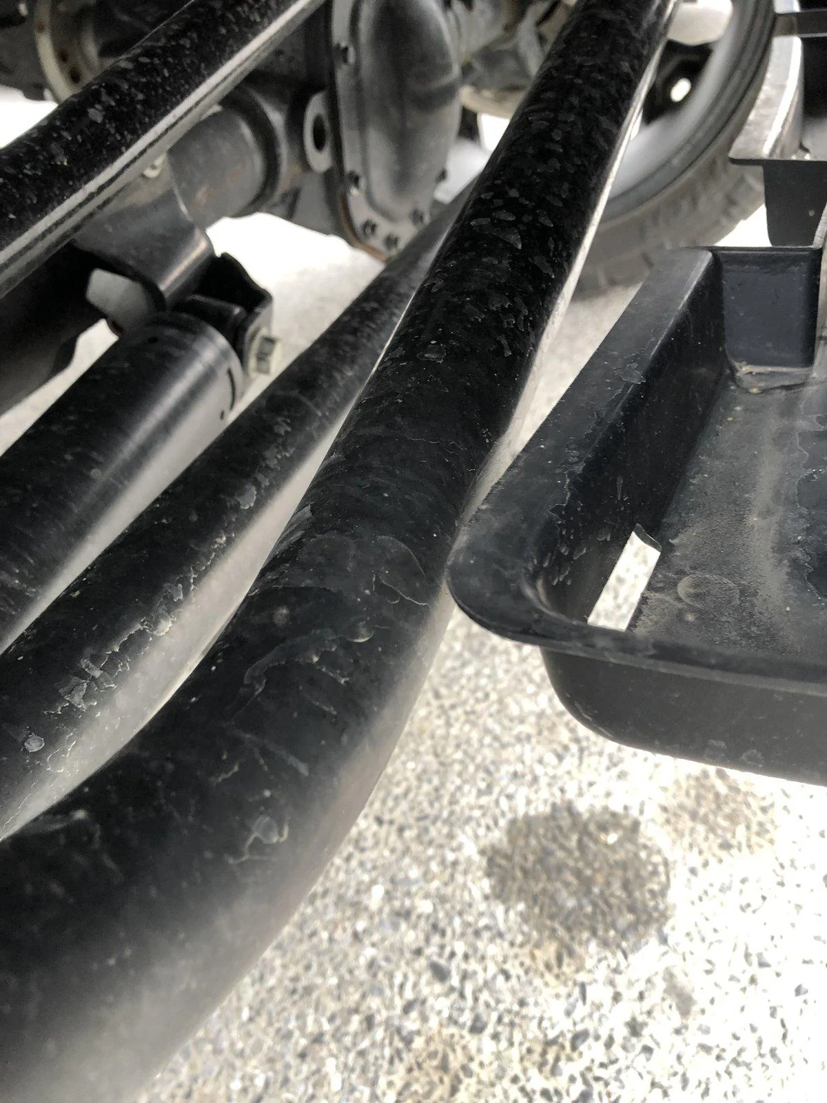

I have this problem with the factory wheels as well but also it looks as if my drag link is making contact at some point dont know when with the splash shield seems if i added length to the control arms it would roll it back. No? Ill include a pic i was only thinking caster because i have the rancho hd track bars and the jeep drove fine last summer with the bigger wheels this problem has only appeared after the lift. The wandering problem was day one but the wheel shakes over every imperfection in the road
If you add length to the upper, the draglink will roll forward & down, if you add length to the bottom, the draglink would roll forward and upward. If it were me, I'd just clearance the flange of the swaybar skidplate. I'd try to get at least 1/2" clearance. Then paint everything and check it from time to time to see if it is still making contact.
When you lift, it changes the track bar angle as well as the draglink angle. Did you do anything to correct these?
