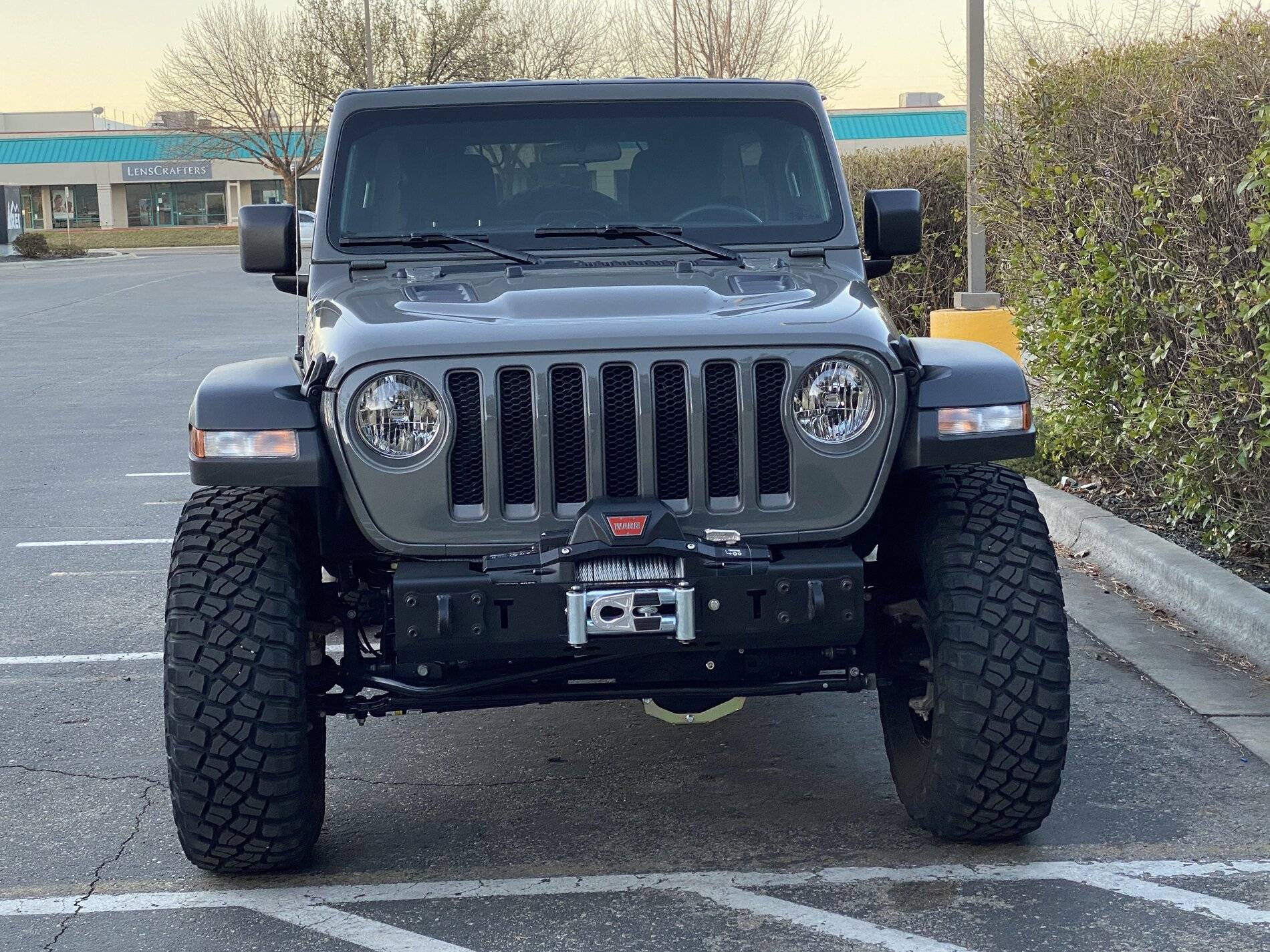

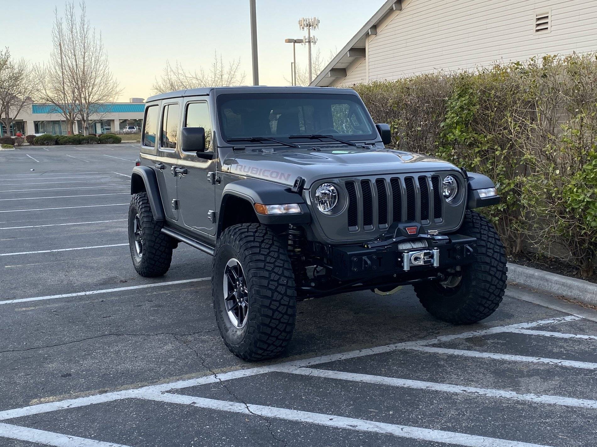

I need some help chasing down the bump steer in my 2021 JLUR. Driving between 30-50mph and hitting a bump or hole in the road makes the steering wheel wobble for 1-2 seconds.
After having someone turn my steering wheel back and forth between 10-2 o’clock and following Planmans video of diagnosing I’m finding a little up/down movement between the stock drag link and pitman arm.
I’ve read a dozen articles and seems like there is nothing in particular that is causing this. But everyone had something wrong and I have to keep troubleshooting until it’s gone.
History of the mods to the Jeep in order:
1- MOPAR lift with adjustable Track bars
2-EVO front bumper with Warn 12k winch
3-Synergy Steering stabilizer relocate with Synergy tie Rod.
4-3/4” inch front coil spacers to level out the Jeep.
This is about when the wobbles/bump steer started happening.
5-Clayton upper and lower control arms set to Claytons specs for their 2.5” lift. Caster looks like it’s at 6 degrees.
I have a Synergy drag link and Fox TS steering stabilizer on order and wanted to install that before taking it in for an alignment.
