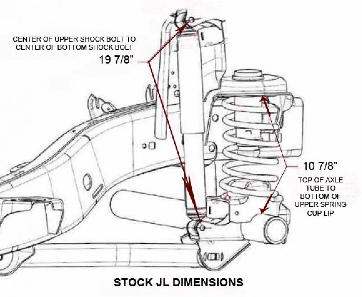

I measured the shock length from eye to eye with the jeep on the ground (full weight on suspension) and got 23.5 inches, so just a little over three inches of lift which is what I would expect. Is that enough lift to warrant a track bar relocation? Could having too much caster cause bump steer? One thing is for sure, there is no hint of DW, but at the same time there's a lot of feedback through the steering wheel (which is think is a result of the large amount of caster and the steering box/sector shaft bearing brace). It's not a fun experience cruising at 75mph and to hit a bump that causes the front end to feel floaty and disconnected. If I hold the wheel the jeep will steer right/left as the suspension moves up and down.

I picked up a digital degree finder and took some measurements. Garage floor slants down at a 7.3 degree angle (jeep is parked facing 'up-hill' in the garage). I get 8.3 degrees on the machine flats of the front axle (where the diff case spreader holes are located). This makes for a difference of 1 degree between the garage floor slope and the housing angle. If the built in caster is 6 degrees positive with the flats at zero, then I get 7 degrees positive caster with the current set up (mopar 3in lift with 1 inch spacer, AEV geo-correction brackets set to the middle caster position which is recommended for 2.5 to 3in lifts, and the mopar extended length LCAs installed). Does that sound right? It seems like the caster would be more like 8-10 degrees positive with the AEV brackets and longer mopar LCAs, right? Also - I did confirm that I have the required minimum distance that AEV specs for use of their geo-correction brackets (minumum of 5 inches from bottom of frame to spring perch, I have 5.5 inches).
I'm thinking of swapping the extended LCAs for a set of stock-length LCAs and see where I land with caster. From what I gather, caster for a 4 door JL should be around 5 to 5.5?
