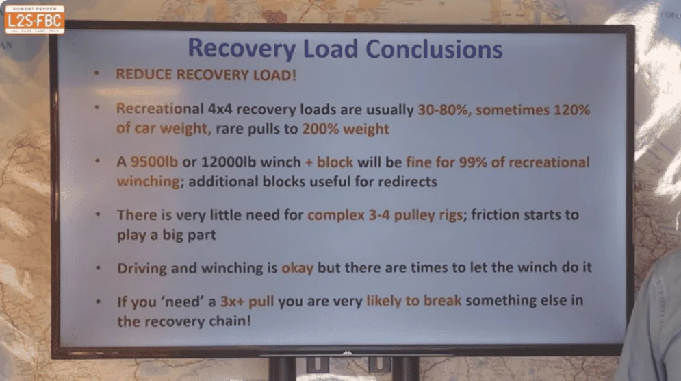

For those of us without Internet, what's the video say?
C.Sco
Mar 19, 2023
1,264
2,698
2023 4xe Rubicon
No internet, eh?
I skipped to the last minute or so and appears to be summarized as:
Recovery loads are usually 30-80% of vehicle weight in the vast majority of cases. Sometimes up to 120%. In very rare occasions, maybe up to 200%. If the load is any higher than 200% then, regardless of how powerful your winch system is, you should probably stop and reevaluate your recovery plan before you break something or kill someone. Also get a snatch block.
An 8k winch on a Jeep with a snatch block will easily achieve 200% recovery load. So a bigger winch isn't particular useful, other than it might allow you to run the winch without a snatch block in more scenarios.
For what it's worth, I run a 12k winch on mine because... *Tim Allen voice* MORE POWER!!! I don't think I needed one that big but, YOLO.
