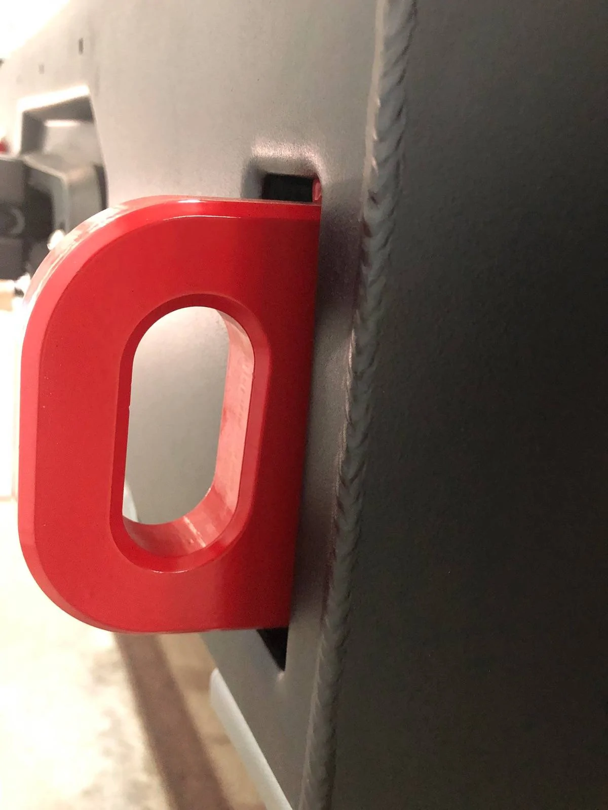

This is what I would use. A tree saver, soft shackle and ring, then the line pulls back to the Jeep with a thimble and hard shackle onto the bumper. Someone said above and I am the same way, I wouldn't use a soft shackle through a bumper recovery point. Sharp edge and you will saw the soft shackle.
With the popularity of soft shackles, some bumper manufacturers like ARB have started to chamfer their recovery points. I would like to see more of a radius, but this feature is worth considering when purchasing bumpers.
