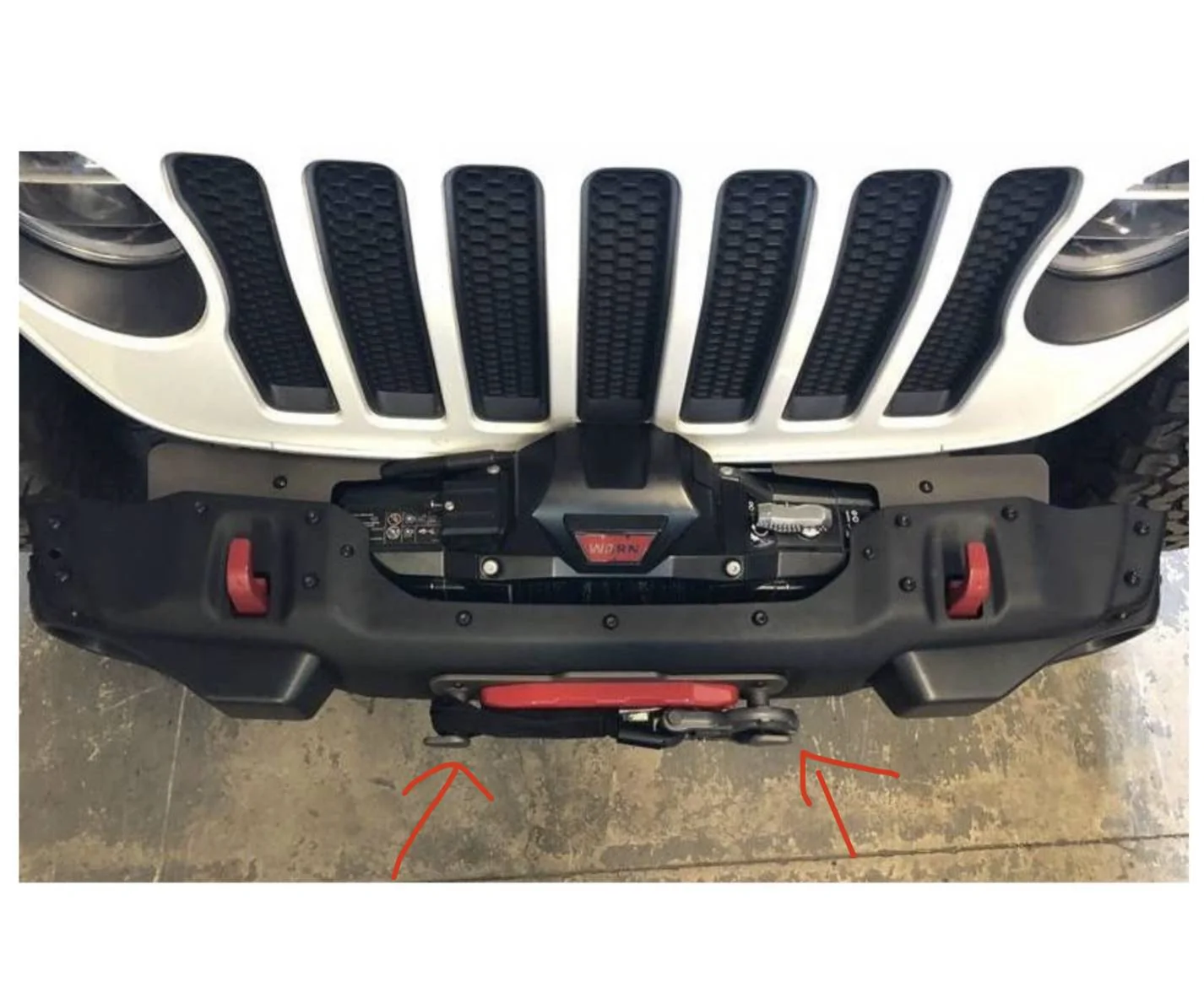

Awesome good looking out I appreciate it. I just ordered those as well. This might be a dumb question but do I need to have something specifically to keep the cable from flying around like in the photo.

This all depends on your setup. I like Factor55 stuff and their blocks have pads to set them against the fairlead w/o damaging it. You pull in enough line to have it snug but don't over tighten the winch line.
From your order it looks like you are planning on using Warns' hook that comes with the winch. You can buy pads (I know Daystar makes one, don't know others) that the hook fits into and then snug that against the fairlead to keep a clean neat setup. Or you can attach the hook to something and wind up any slack. Just make sure you're not pulling the hook into the fairlead. It will mar or cut into it and that would create a winch line cutting point. Keep the fairlead as smooth and clean or debris as you can.
Edit:
I did a quick look and the Daystar one requires it to be on the winch line. Seems like a bad design. I've never used one of these pads, but if I was going to I would want to have something I can slip on and off w/o having to remove the hook from my winch line. AEV makes one that is a lot smaller and wouldn't be an issue to leave on the hook when in use.

Thanks for the tips. I can’t seem to find what you’re referring to on Factor55’s website. I really like the one in the photo with the Maximus 3 mount. Do you know that one? If not, I’ll reach out to Maximus.

That’s a hook keeper plate that goes under the hawse fairlead and it is sold by Maximus 3

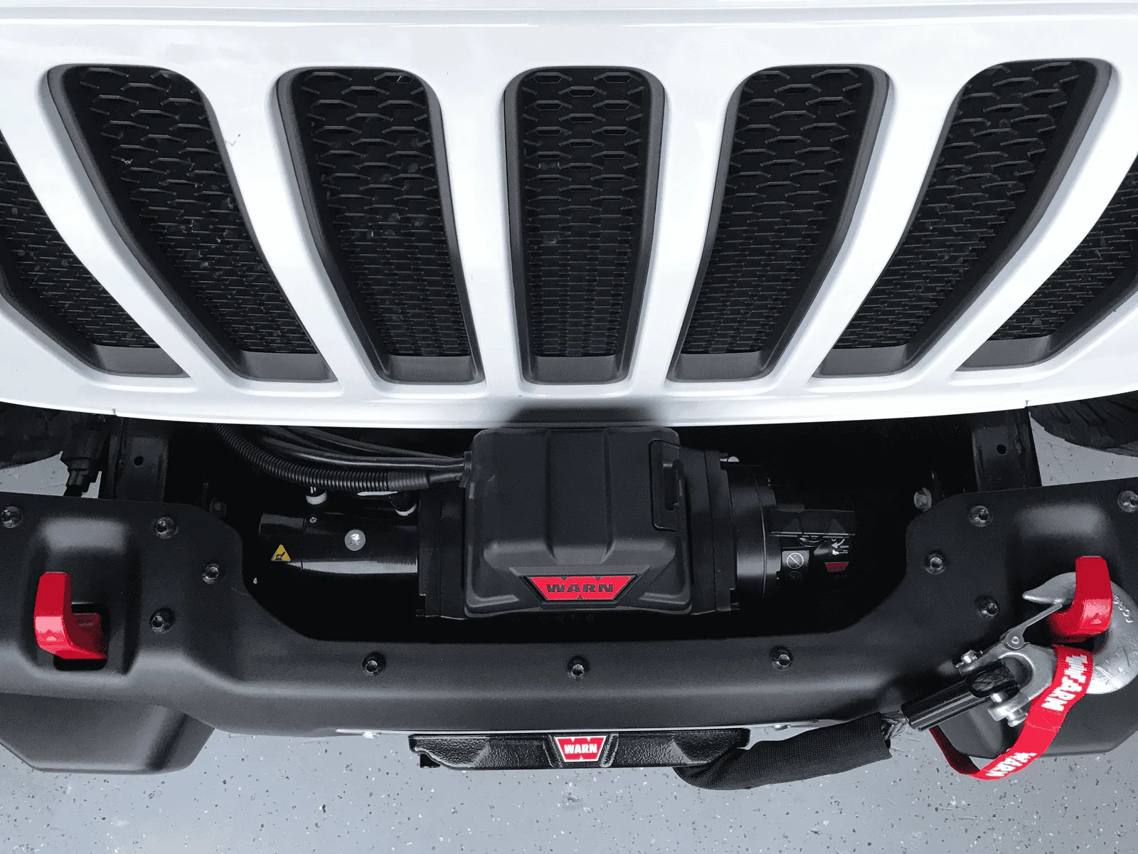

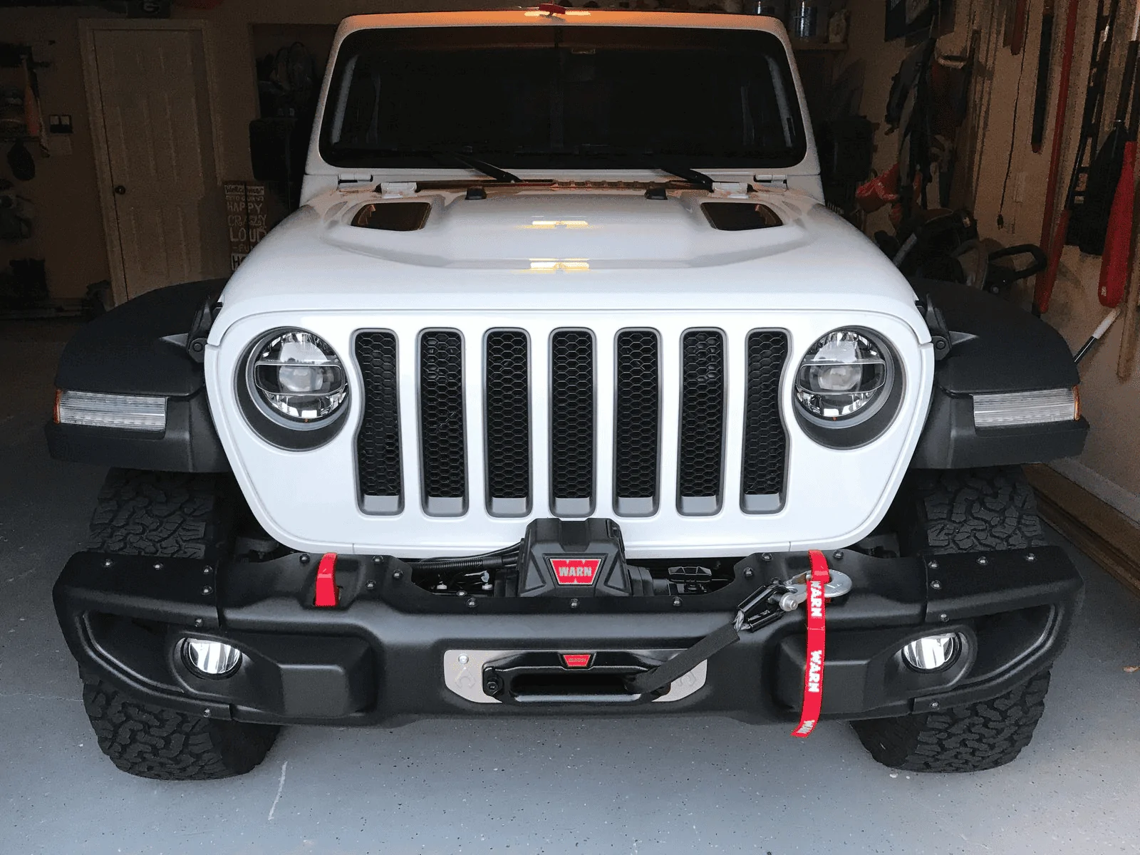

You could go with the poor man’s hook keeper, but from your flurry of purchases, maybe that’s not your style. ?

It works with any hawse fairleads? More specifically the warn one I purchased?

I don’t see why it wouldn’t work with the one that you posted, but probably best to run it by Maximus-3 first. It’s just a spacer between the fairlead and the bumper so you may need some longer mounted bolts for the fairlead. Not too hard to work around.
