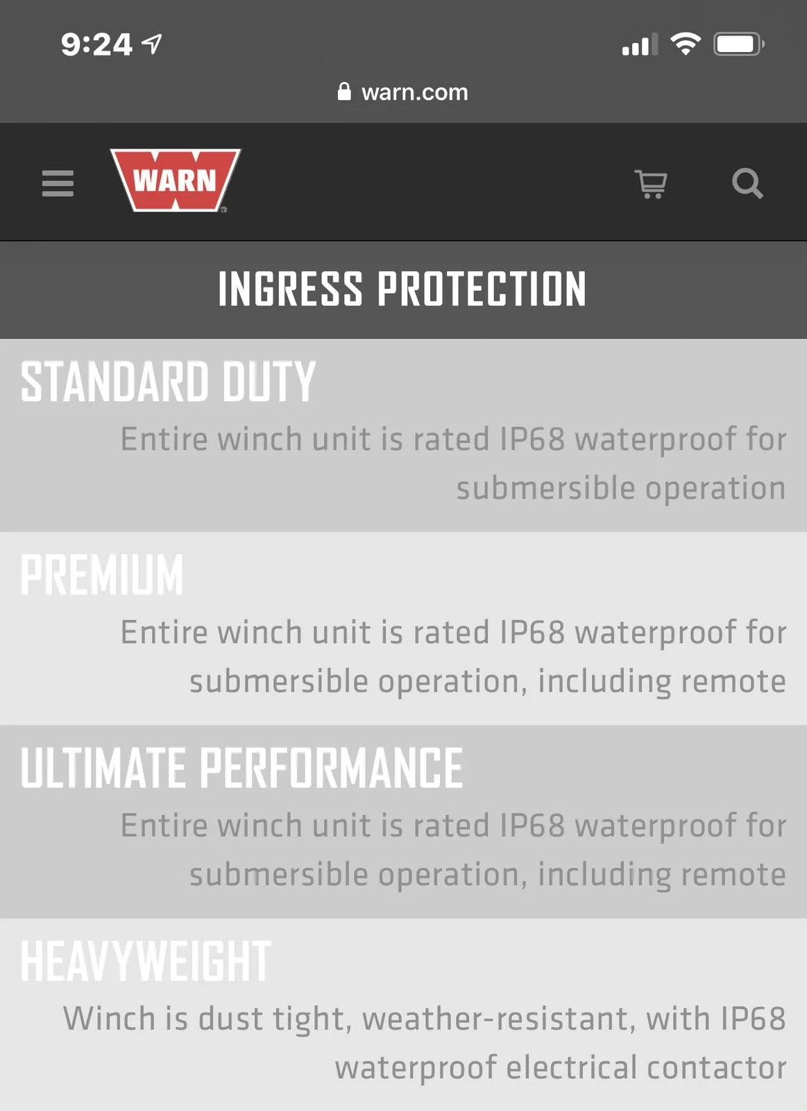

Not sure why some believe that the new Warn EVO series is not able to operate while fully submersed. If you read the the comparison link listed above, and look under the "Ingress Protection" section towards the bottom of the list it says, "Entire winch unit is rated IP68 waterproof for submersible operation." Only the remote itself is not listed for submersion.
Here’s what you are referencing I assume. I don’t have a dog in this fight, just a casual reader who went and looked. Standard duty being the EVO VR.

Ok I'm wrong. No idea why on another Warn page they list Zeon with submersible operation and exclude VR EVO. Hell maybe Warn has no idea either.
I think they were just really slow to update their website after they brought out the new VR EVO model. Be interesting to see if they update the Zeon series with more efficient motors and the wireless remote like they added to the VR EVO. The Zeon series uses a lot more amps than the VR and in some cases is also slower at the equivalent weight of the VR EVO.
