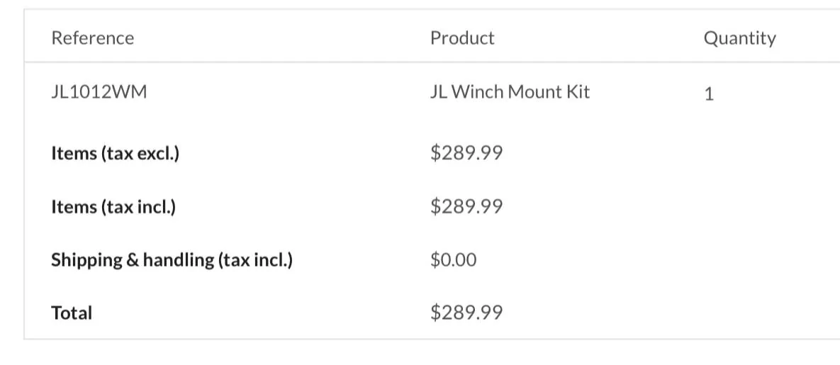

I'll second the Maximus-3 winch plate. I was going to go with Grimm Offroad, but they were backordered too. I've had multiple Maximus-3 products and all have been well made and presented no issues.
It looks discontinued at a lot of places. Is it old or is there a newer version?

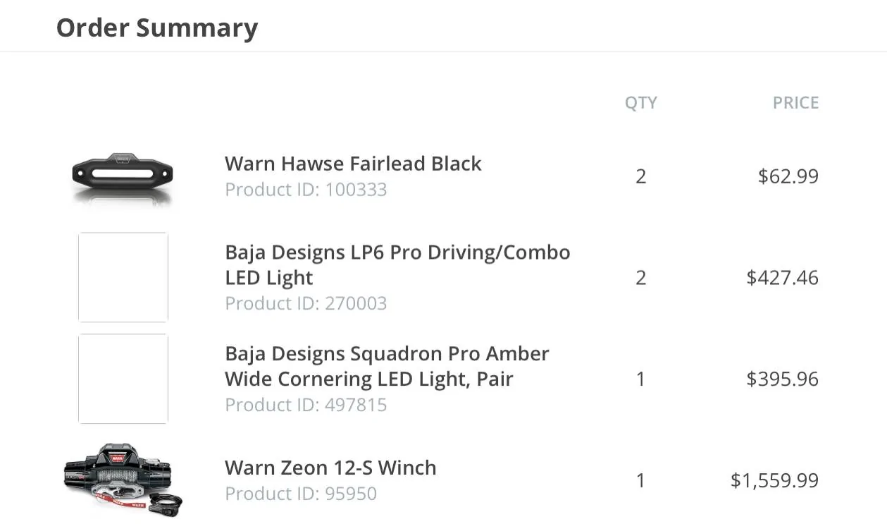

Thanks I went with the Zeon 12-S. Yes Expeditions do weigh quite a bit, but I bought a getaway which is much smaller. Only about 2800lbs with everything including water.
