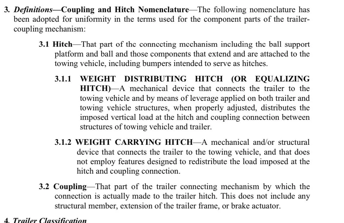

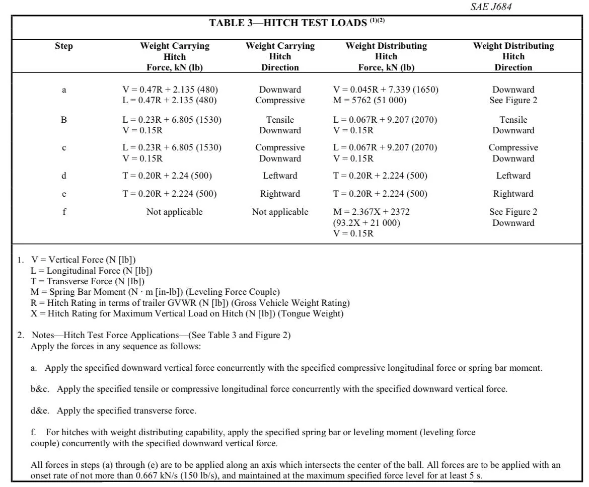

To pass SAE J684, a 3,500 lb hitch in tensile has to take the following load for 5 seconds without permanently deflecting 5 degrees:
Longitudinal Tensile Load = .23* Rating + 1530 LB = 2,335 LB.
Jeep Wrangler JL Trailer Hitch Installed Winch 1A26DF16-F964-457F-8AE6-9E836716D7A3
Jeep Wrangler JL Trailer Hitch Installed Winch D456635C-4263-4169-9925-D4BCC804D6D2
