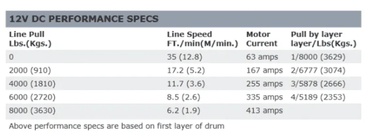

A bigger JL main battery is a Group 48 rated at 65 Ah.
Disagree on the math. The back of the Excel calculation:
FeetFt/minMinhoursAmpsAh
1006.216.130.27400107.5
Calculations using zeon-8-winch
Jeep Wrangler JL Trailer Hitch Installed Winch 1676746231019
It's actually much worse that that. The 65Ah rating goes way below 12 V. Anything below 12V does permeant damage to the battery. The lower the voltage, the higher the amperage and the hotter the winch gets. Now add in 15% drop in pulling power with each layer.
A small battery in the back with 1 Ga jumper cables would be idea. 30' 1 gauge cables lose 10% voltage over 30'. I'd cut the jumpers down to the shortage distance you need to minimize voltage loss.
When I do a pull from my JLR, I do the two finger Taser salute to bump the idle up to 2,000 RPM. Because I have the tow package, I've got a 240 A alternator. On my TJR, long pulls are a PITA. It's got a 117 A alternator and no Tazer to bump the RPM.
But it's unlikely you'll need a 100' @ 8K pull. Wheeling solo you're much more likely to need a 2 foot, 3,000lb pull. A small battery would be perfect with that. I'd attach my volt meter to make sure it's not dropping below 12 V.
