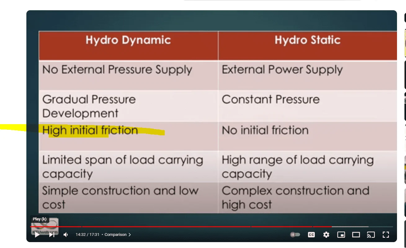

Hydrodynamic bearings require rotation to entrain oil. Nearly all the wear occurs on start up and shut down.
Engine stop start systems are afterthoughts to help meet corporate average fuel economy targets. They are compliance features. They are not in the customer's best interest. Your engine absolutely will last longer if you disable stop/start. Whether it matters during your length of ownership - who knows.
The engine doesn't remain off long enough for all the the oil to drain out of lubricated components. 30 seconds to 1 minute seems to be the usual time for me before I'm on the move again. And thats if the AC/Heat doesn't kick it back on sooner than the light turning green.

Without oil pressure or rotation, the oil wedge is collapsed.
