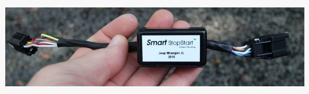

If you don't have a Tazer or similar... you can spend $50 - $100 depending on brand and get an ESS eliminator . This way you don't have to pull fuses or alter the vehicle in any way other than installing the module (installation is just like a Tazer/basically).
I like not having to push the button to turn it on/off , plus if there is a need to use the ESS, I just turn it back on. So far I haven't had any battery issues (fingers crossed)
https://www.smartstopstart.com/jeep-dodge-chrysler.html

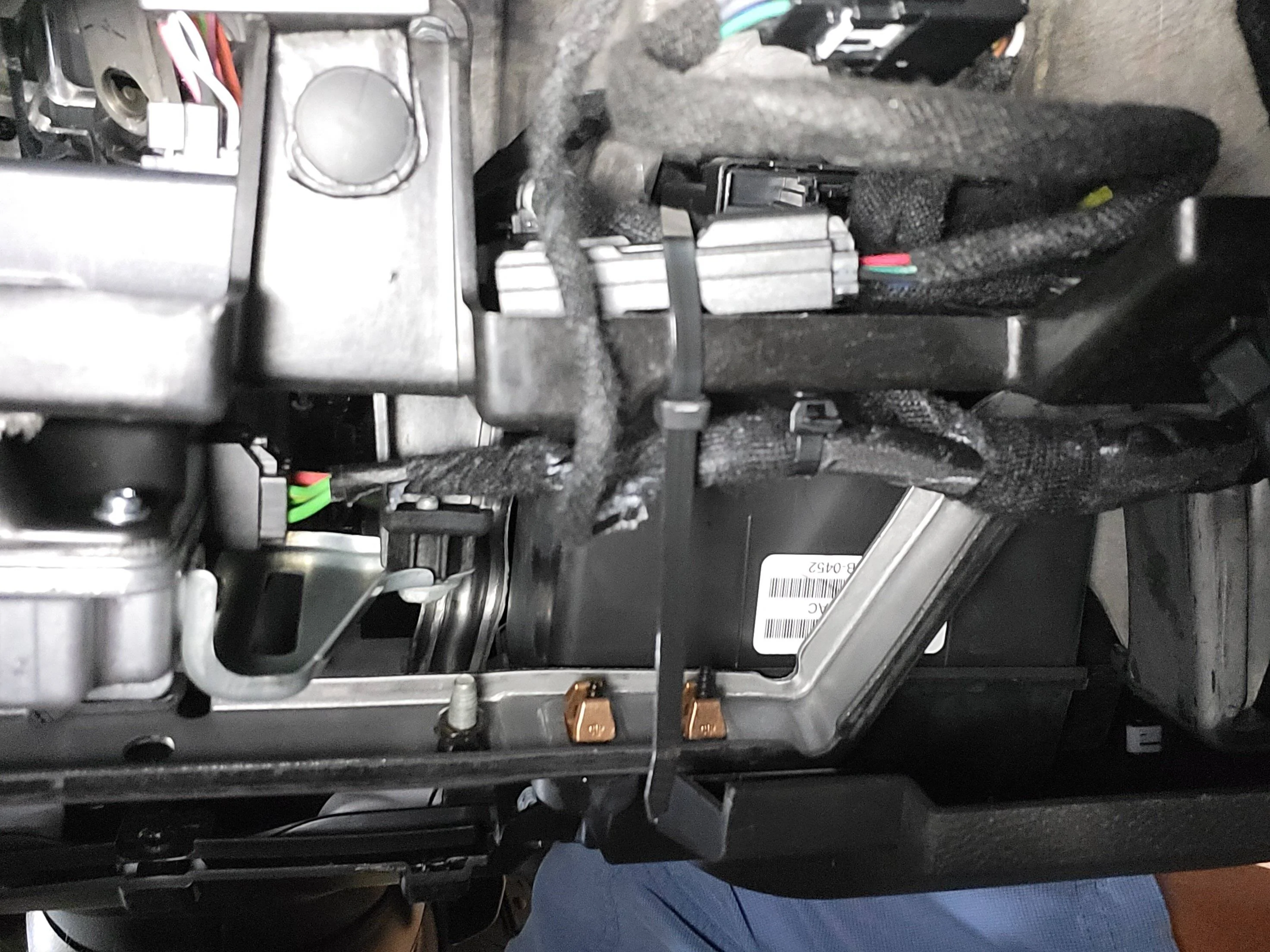

This may be the wrong area for this. I have a 2023 Jeep JL. I ordered a auto stop eliminator when I went to install it. I found the security gateway module on my vehicle is not were the video stated it would be. I think I found it, but holding up install until I hear back from Auto Stop Eliminator. Anyone have issue like that on 2023 Jeep Wrangler JL.
Personally, I would return that knock off offering if you can. It is a so so offering as on occasion it is known to hiccup.
Most here on the forum that have purchased such an offering, went with the original SmartStopStart.
For the same price you can buy an SmartStopStart unit. Sold by a fellow JL owner. Also, SmartStopStart is forum sponsor. The SSS offering NEVER hiccups!
https://www.jlwranglerforums.com/fo...-should-have-been-designed.13946/post-2294877
Your knock offering connects at the security gateway as the SSS unit does. See pic that shows gateway the connectors to use circled in red.
