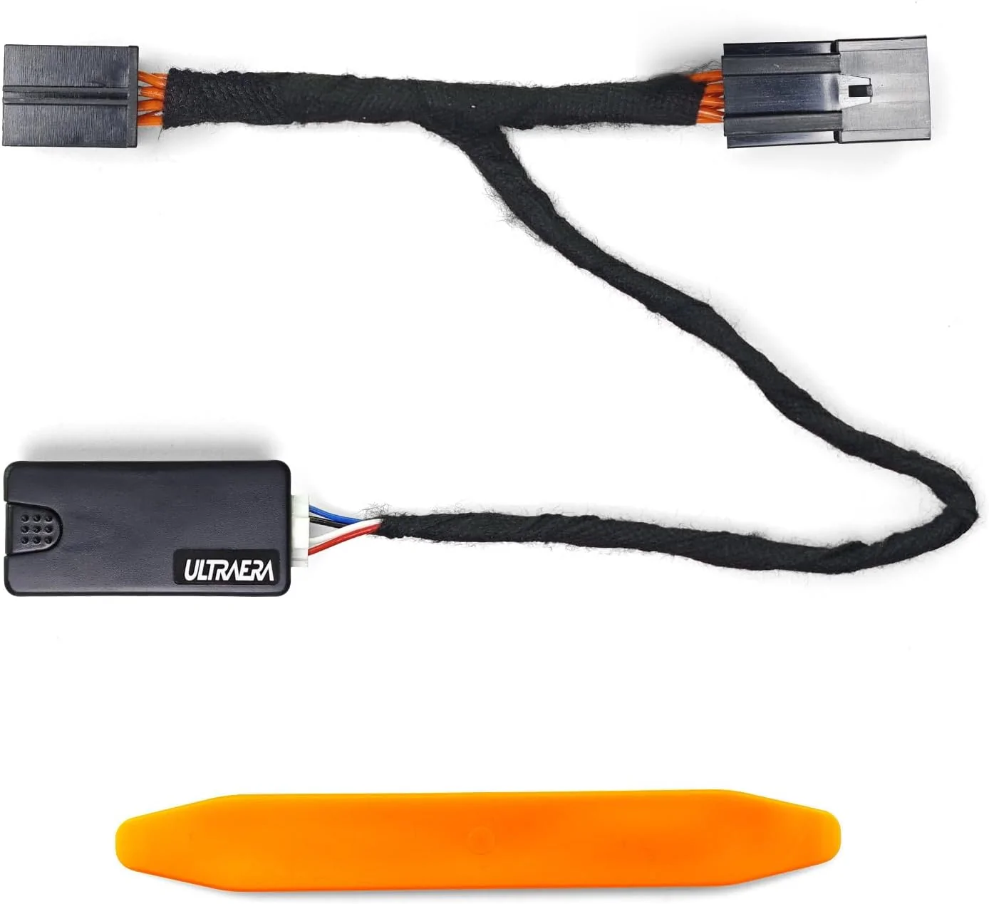

There are two types of these cheap Amazon options, I have discovered. One connects to under driver's side dash. Instead, get the one that connects behind control panel where the button is. Kit comes with pry tool if you don't have your own. Whole thing takes 5 minutes, works perfectly, Amazon free returns, 'nuf said.
Amazon.com: UltraEra Auto Start Stop Eliminator for Jeep Wrangler JL 2018 2019 2020 2021 2022 2023 2024 2025 Gladiator JT 2020-2025 Auto Stop Eliminator Engine Auto Stop/Start Disable/Plug Play Car Accessories : Electronics
Jeep Wrangler JL Auto Start Stop disable options? 1765037403351-82
Now, the Chinese should be banging these out on Amazon for $20 like for every other car I have gotten these for, but for some reason cheapest for jeep is now $50 less discounts (I paid $39).
What I don't love about this one is that it turns the switch 'on' within 3 seconds of starting the car. I would much prefer the kind that simply remembers what you last used. That way you can turn the switch off before taking it in for service and the tech won't know you have one installed. Then again, if it takes 5 min to install, logic dictates a 5-minute removal.
No way .... Not if you gave one of these Chinese knockoffs for free would I install on my/a JL or JT.
I'll pay the $100 for the original SmartStopStart.
...AND.... I know when I finally no longer have my JL that I will easily easily be able to sell the SmartStopStart I used for years for about $50-60.
So, buy the SmartStopStart ....an offering from a USA, forum sponsor.. ... a JL owner ...
An offering that is known to never hiccup. An offering that does not require you to pry open things. An offering that is about 8 in in length/very small footprint..
