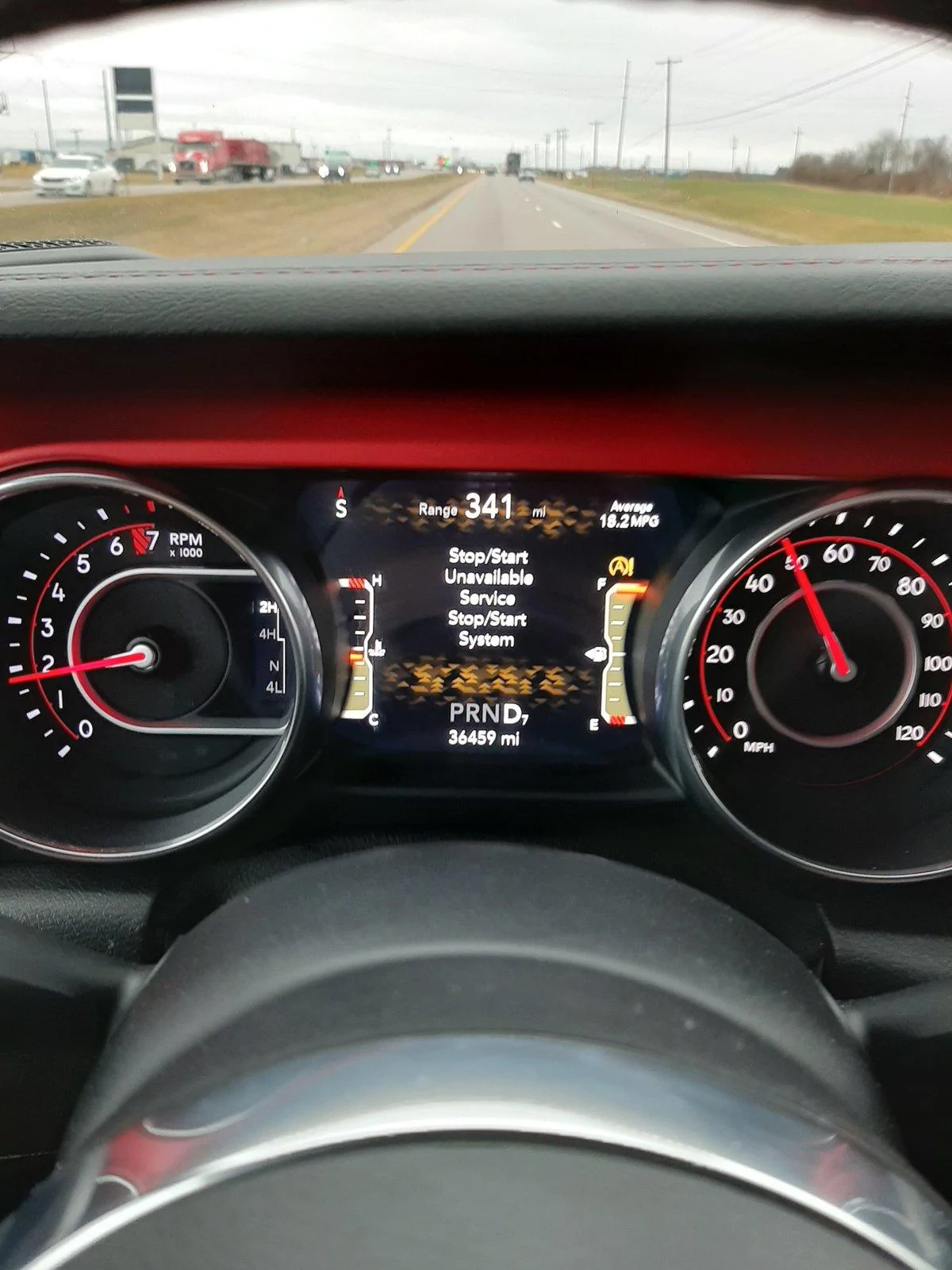

OK, normally I do not use auto start stop and I always push the disable button when I start the Jeep. But today I forgot and while at a stop light I let off the brake pedal the auto start stop chugs a bit and then I get this error message on my dash. Now as much is I am annoyed by the auto start stop I do not like error messages on my dash panel so does anyone know how to get this
resolved?
Hi JC,
Should you decide to visit your dealer, please feel free to send us a PM. We'd be happy to connect you with a Case Specialist to work with you and your dealer throughout your service visit.
