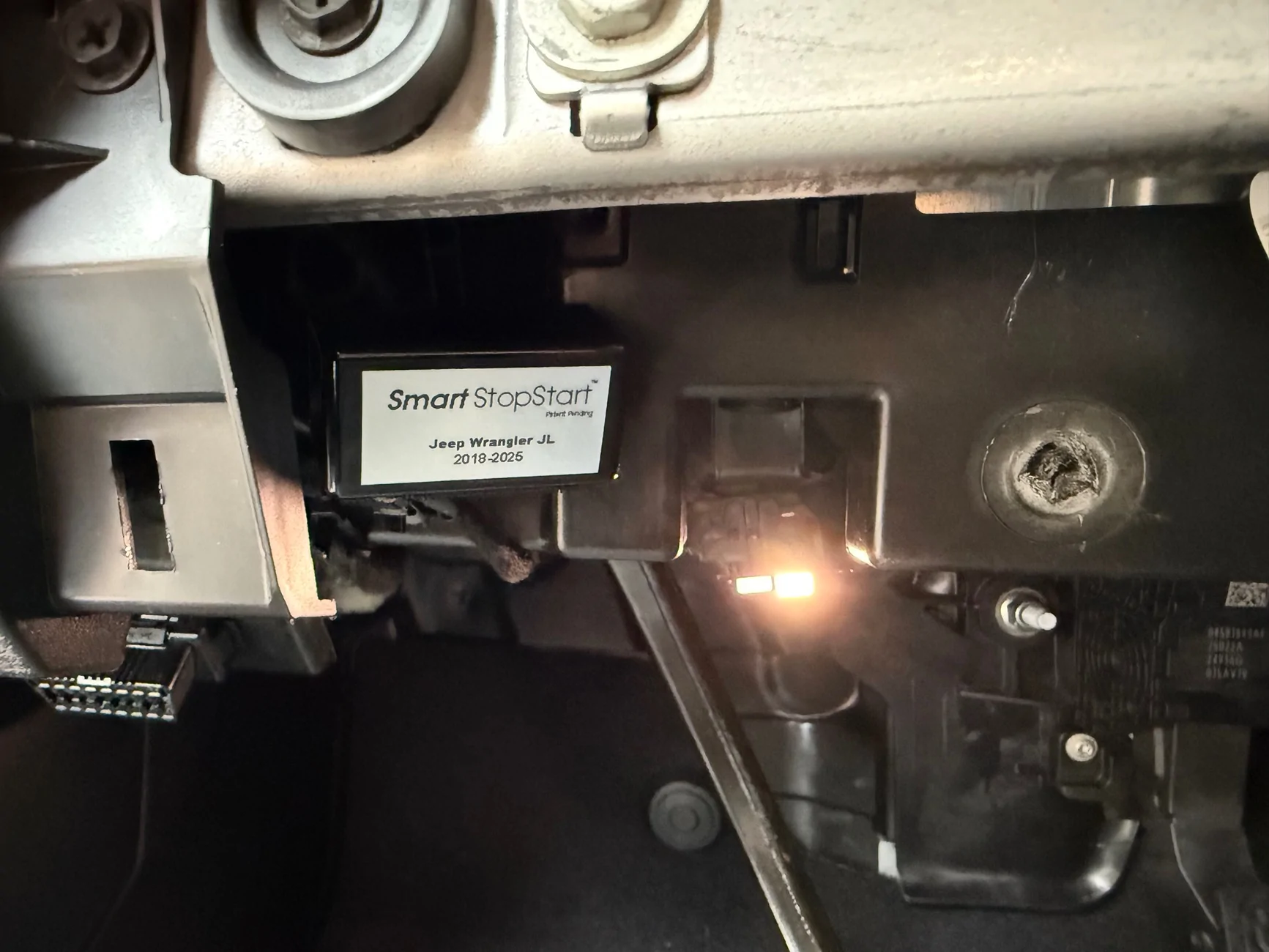

@Nash_Dj Agreed. There’s just some members on here that don’t like having choices they don’t agree with.
In my case I operate several different vehicles throughout the week. My Jeep is the only one with the ASS button. I’m not going to remember to hit it every time so I dropped a hundred on Smart Stop Start device. If someone else thinks I’m lazy or spending money recklessly I don’t give a shit 😉👊🏼🍻
