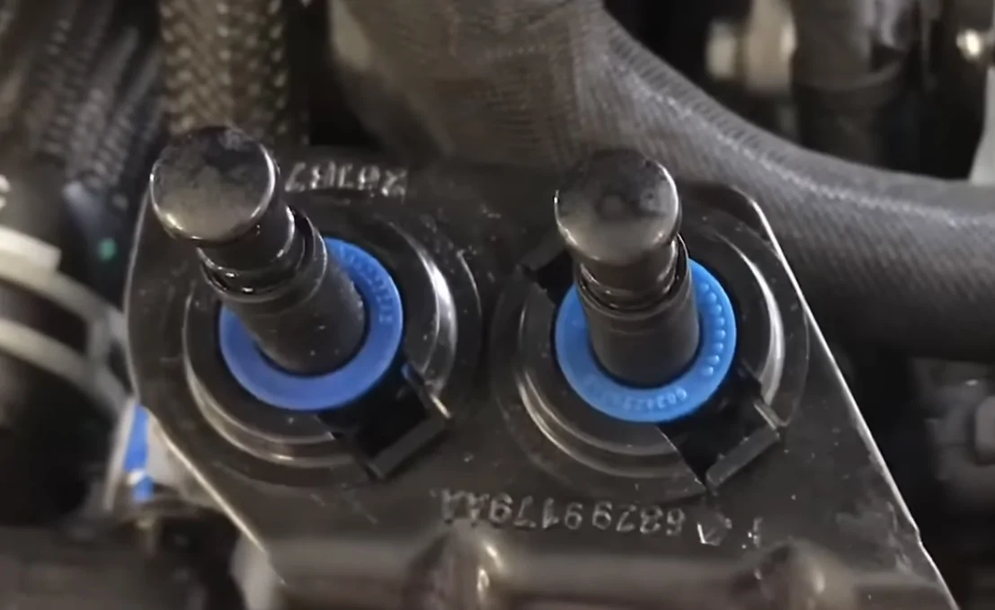

My apologies if this has already been addressed. This is a 7-year-old video. In the photo from the video, we are looking at the hood plunger switches of a JL/JLU. The guy in the video says all one must do to permanently disable ESS/ASS is to remove the plunger on the right, and the video shows how to do that. Is this legit, and if so, why not do this instead of disconnecting the ground from the ESS/ASS battery and removing fuse #42?
Here is the video:

It's my understanding that this technique, while effective, will generate an ESS off message in the dash and prevent remote start if equipped. It's quick, and it will keep your Aux battery, if equipped, connected, for all the benefits or downfalls of doing so. IMHO, if you've committed to not running ESS events, disconnecting the Aux battery is generally a better choice because its demise can't, unconnected, compromise the main battery. I imagine there are owners for which keeping this Aux battery charged may have other uses.
https://www.jlwranglerforums.com/forum/threads/engine-start-stop-feature.147885/post-3079732
I once here posed the idea, rather than pulling Fuse 42 and yanking the Aux battery cable, to just do the latter. Your first attempt (old 2018's possibly being stranded by this without TSB 18-092-19) to cold crank afterwards would likely fail, but all subsequent ones, provided the main battery has ample power, should succeed, the vehicle generating the ESS off message in the dash, seemingly obviating the need to buy tech to turn ESS off for you. It seemed like a win win. @Jebiruph, the father of these inventions, seemed to think that this ESS off light in the dash--and I am paraphrasing--is a bit of a canary in the coal mine diagnostic that when displayed in the dash (i.e. EVIC) can be a sign of other problems, and thus owner/operator invoking of its presence could hide other diagnostic conditions.
I mention this because the hood plunger method you describe, I understand, and as mentioned, also illuminates this light.
Additionally, you've ask Jeff to have people compare this to the Fuse 42 and cable yank. Under this more newly discovered method the vehicle upon cold crank is tricked at this crank time, into performing its test of the ESS/Aux on the main battery. Yanking Fuse 42 denies the Power Control Relay (PCR) of the power it needs to separate the batteries, otherwise connect in parallel, and the pre crank test instead happens against all connected batteries, of which you have only one, the main.
Normally the vehicle is "very happy" with the power it sees from the main battery--thinking in this case that it is the Aux, and doesn't disable ESS (or turn on this diagnostic light). It then becomes the owner/operators task to turn ESS off by pressing the button or buying tech to do that.
I am not a fan of people running ESS events with just the main battery. Yes, other manufacturers run ESS with one battery, but I don't like the idea of the one battery that needs power to crank the engine after an ESS event also used to run appliances during that ESS event, with the engine off and the alternator not backfilling the main battery with power, particular under the perfect storm of an old main battery, a cold night, a left turn across a busy highway, and one too many power hungry aftermarket appliances so common in Wranglers running during the ESS events. Sure, ESS is designed to early terminate if battery voltage drops, but the voltage drop is designed against the Aux battery that is suppose to energize the ESS events, while the main battery, at least under the factory configuration, is sparred for the engine crank.*
But all this said, if you do run ESS events under this scenario, and manage to get to 6 of them in one cold crank, the vehicle will turn ESS off until the next cold crank. This is because it compares the voltages of the two batteries under the factory configuration in each ESS event (I'd presume at its termination point) and assumes issues if they are close enough in value: which in the cable and Fuse 42 pull are tests against the one main battery than would produce such identical voltages, going of course against the same one battery.

OP, yes disconnecting the hood sensor closest to the left fender will disable ESS. It will case a service ESS lamp to be always be lit on the center gauge cluster behind the steering wheel. It will not disable remote start.
I ran my jeep like this from day one upon delivery on May 6th until yesterday without any problems other than the service ESS lamp being on. I got tired of seeing it always on and installed a SmartStopStart device yesterday. I reconnected the hood switch at that time. No more ESS warning on the dash and the device remembers my always off push of the ESS button below the radio.
I am now considering isolating the aux battery completely with the fuse 42 full and negative cable disconnect as mentioned in the post above.
That light drove me crazy. I lasted about a week with hood sensor pulled then bought a Tazer. I used that to disable ESS for a couple years and decided to finally delete my AUX battery while I had the battery box removed to pull the motor. No problems since removing the Aux. I removed the entire positive cable to the battery instead of just taping off the aux end.
