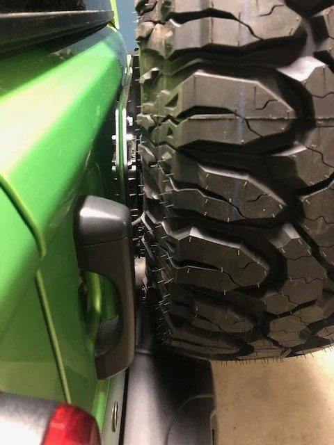

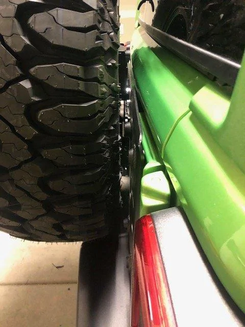

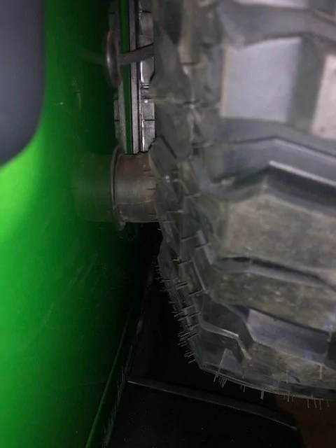

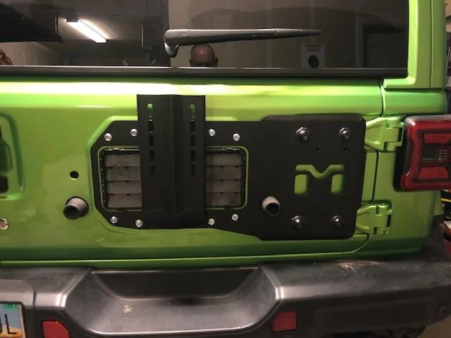

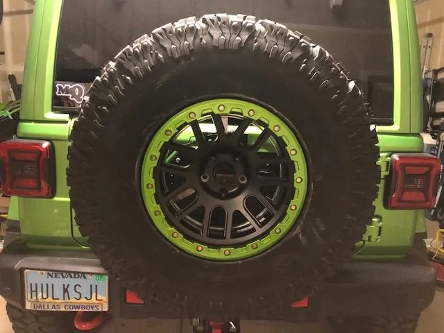

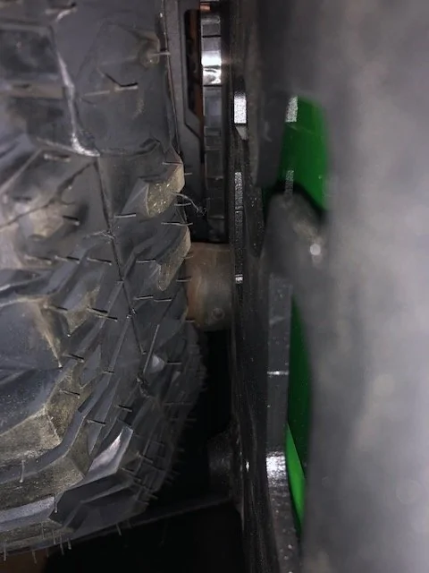

Didn't see anyone post about the Metalcloak Sportgate tire carrier yet, so thought I would. I've had it on for about 2 weeks carrying a 37x12.5R17 Patagonia on a 17x9 Vision Nemesis wheel with 4.5" BS. I drove about 450 miles yesterday and about 700 miles total in the last 2 weeks. Haven't seen the tire move or shake and there has been no sound from it.
According to Metalcloak, their Sportgate can support up to 150lbs. This tire carrier is similar to the Mopar or other hinge reinforcement carriers, it doesn't replace the hinges. Although there's no doubt the hinge replacement systems are stronger, I haven't seen any movement or ill affects using this carrier with a 37" tire.
It allows for the backup camera, but has no provision for a third brake light. I used an Oracle third brake light ring, which was pretty simple to install. If you go this route, don't cut the 3rd brake light wiring where Metalcloak tells you, wait until you mount your brake light and trim as needed.
Pros:
Easy to install, good instructions
Seems very strong and I really like the "M" cutout
The backup camera is in a very protective slot, allows for pretty good field of view. I can see the rash ring on my spare, but it doesn't interfere with the FOV
Adjustability: I still have a decent view out of the rear window. The spare is about ½" above the rear steal bumper cutout.
Maintains use of stock spare tire bumpers....I was able to get the spare sucked into the bumpers with good deformation, which is what's keeping the tire from rattling and moving.
Price: $420
Cons:
No 3rd brake light provision (I like the ring light better anyways).
Not a hinge replacement system
There's a slight misalignment with the latch and tailgate.....I will attempt to preload the hinges or align the latch at a later time. Tailgate closes fine, I can tell there's a slight drag on the latch.
Overall, it does what I need it to do at a very good price. I decided to try it as I like Metalcloak's products and it's features.

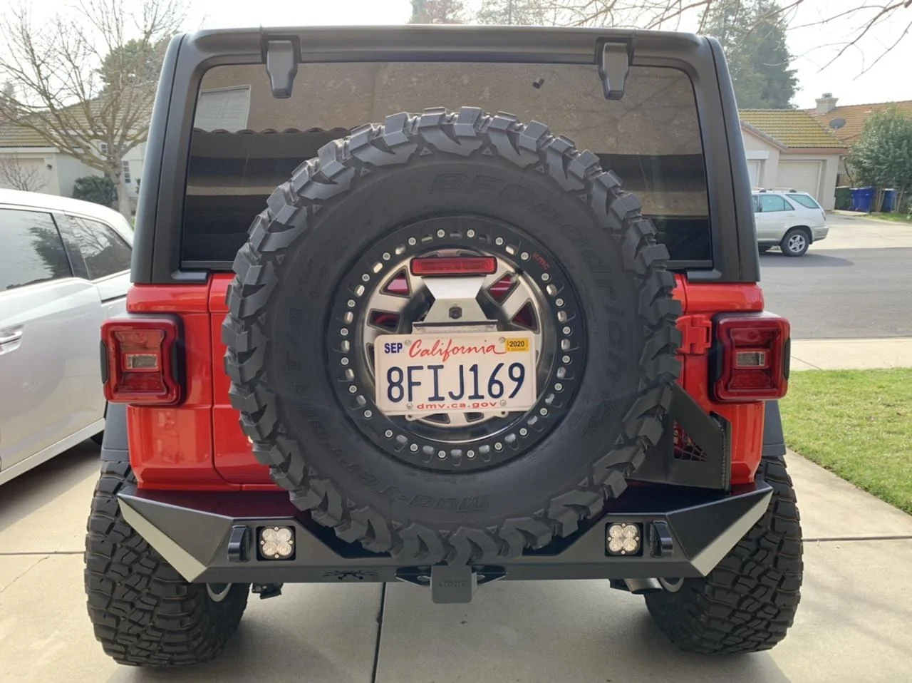

I figured worse case I can buy a Poison Spyder or some other brand JL frame mount and do some minor modification to the Smittybilt.
Just to clarify for anyone using this thread as a reference, the Poison Spyder tire carrier pictured in this thread (and on their website) is NOT the JL model. The JL model still ties into the frame, but the “arm” that ties into the rear frame cross bar doesn’t exist. Instead, the JL model has a steel plate that extends toward the end of the bumper and bolts onto an additional 4 large studs that are built into the back of the Poison Spyder Bruizer and Crawler bumpers. You wouldn’t be able to use the Poison Spyder carrier with any other aftermarket (or OEM) rear bumper without significant modification. Watch the install video on YouTube if you need help visualizing it. I love my Poison Spyder tire carrier BTW....
