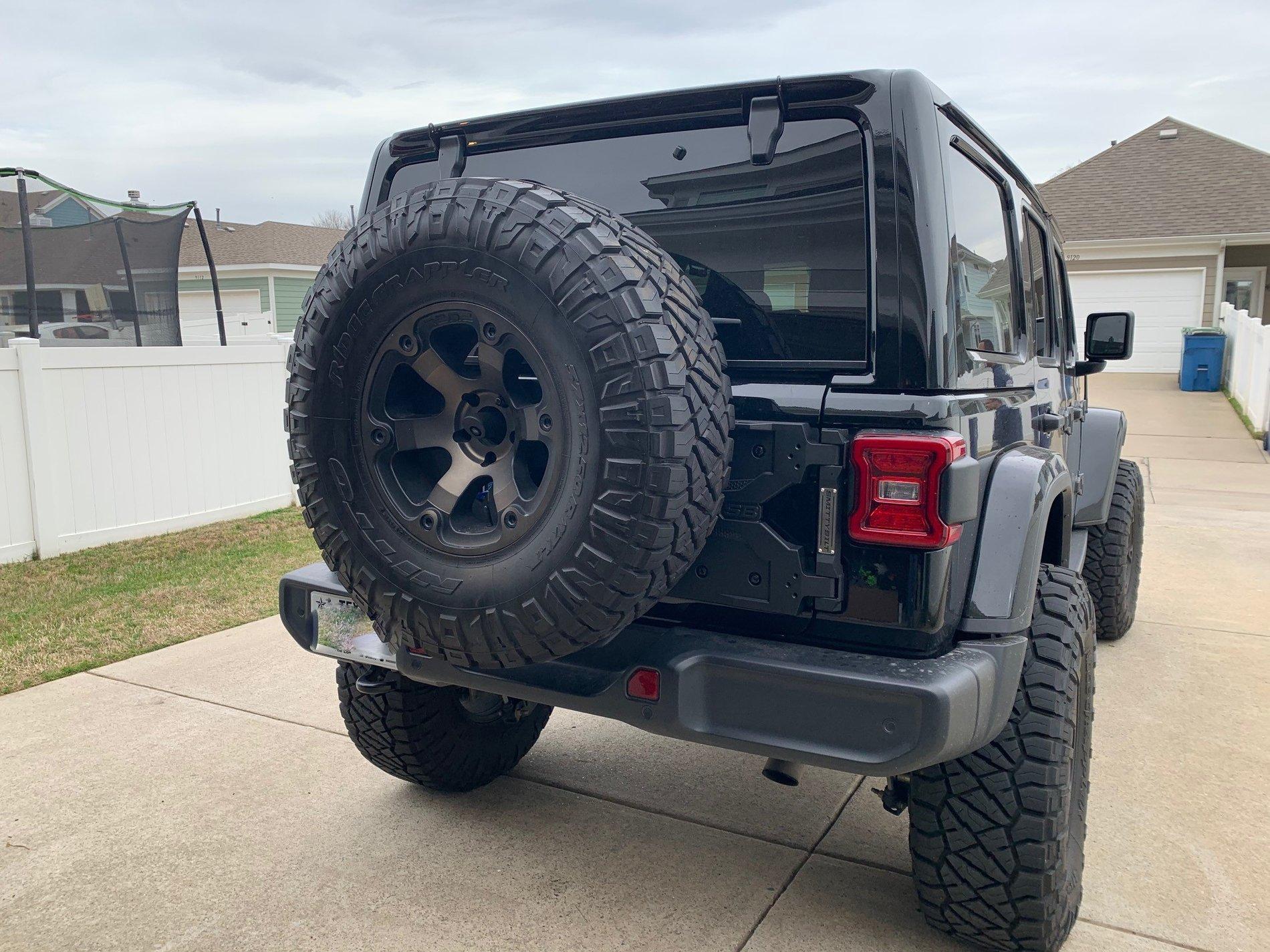

Smittybilt HD Pivot Tire Carrier. Installed over the weekend. Rock solid addition to our rig. Specs for my wheel / tire combo in my sig block. More info and pics in this thread.

you have any side pics, that show how far out the tire is from the tailgate?

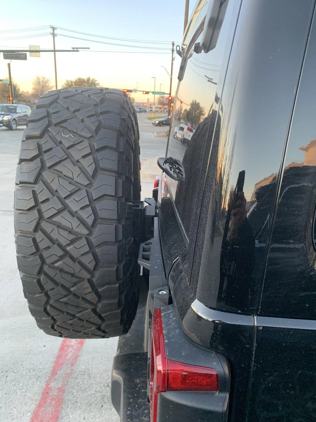

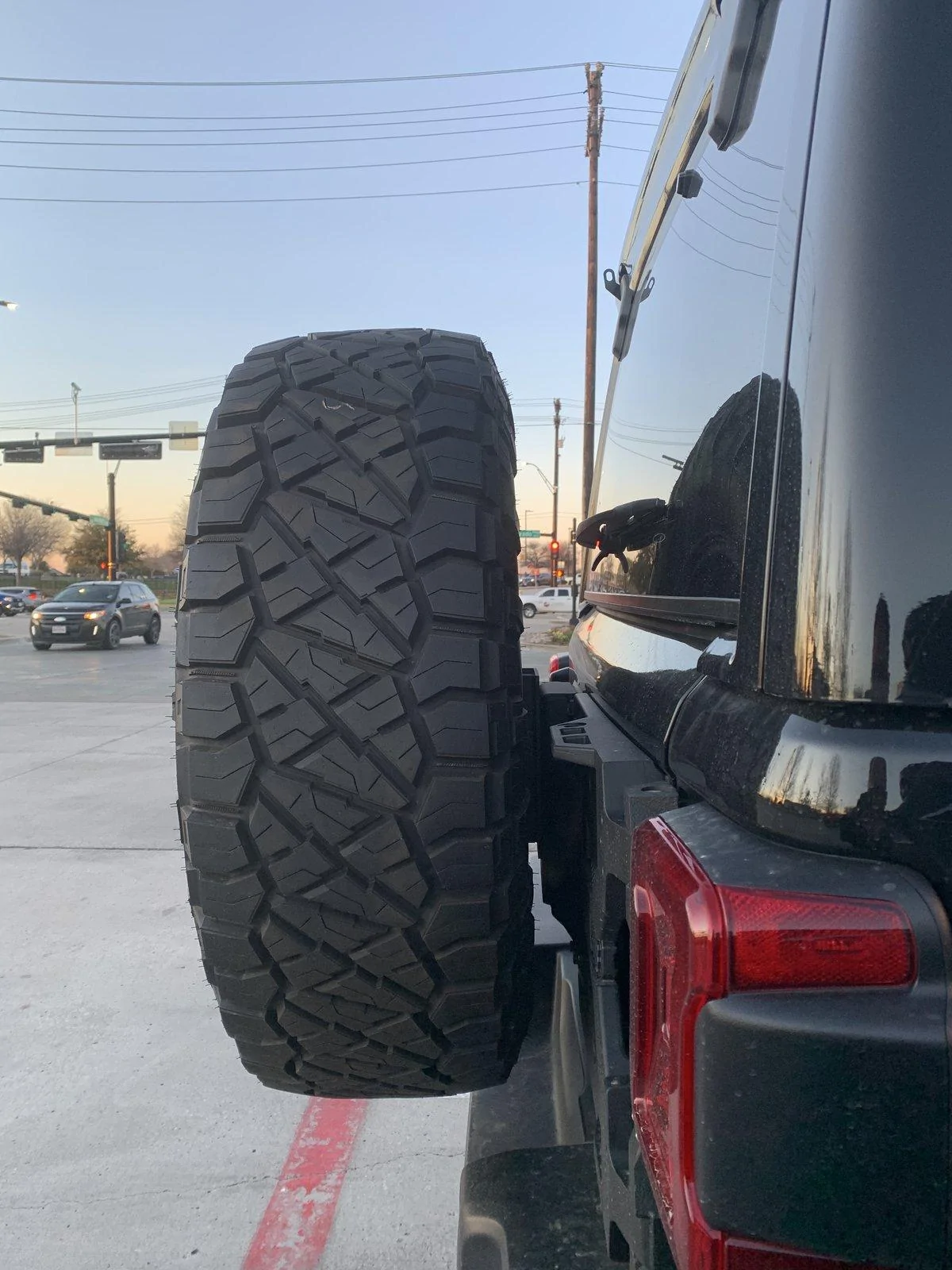

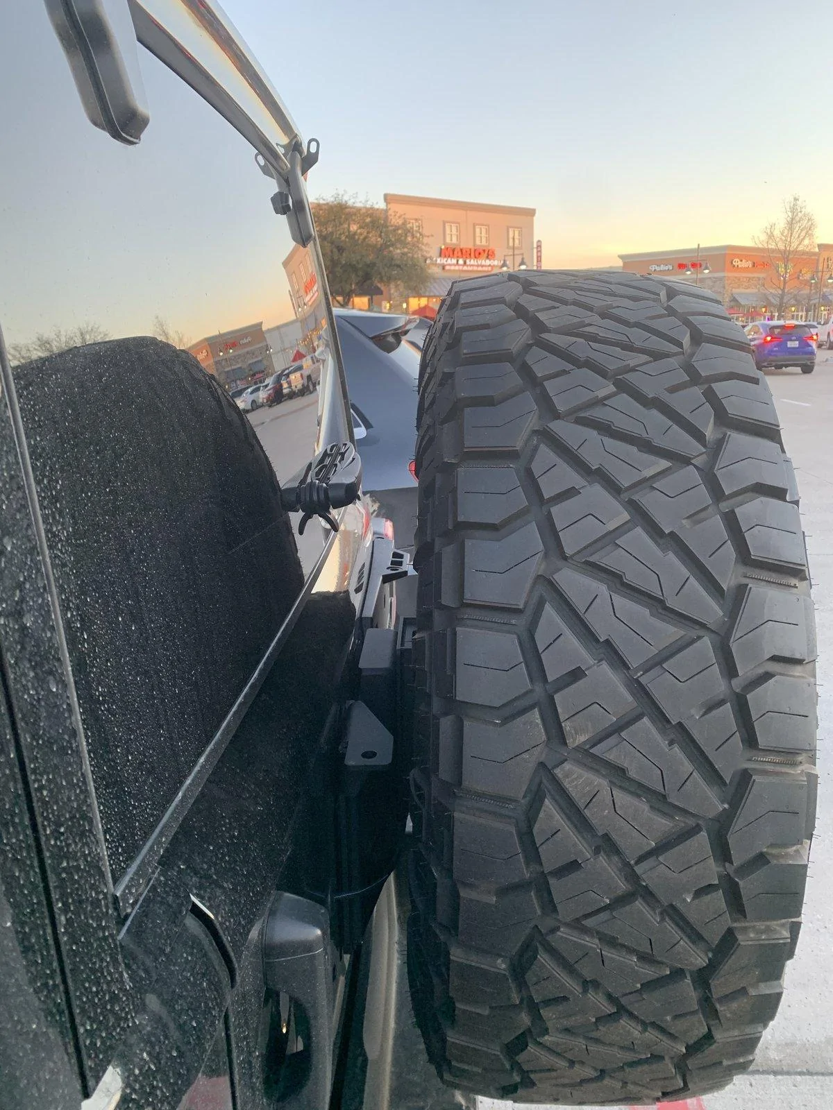

Not the greatest photos, but these were taken a few days ago.

Thank you. Is this as far back as it will go? Anyway to get it closer to the tailgate.
how far back it goes will depend on each individuals set up. I’ve got a 4.5” BS on my Fuel wheels so this is as far back as it will go for me.

Thank you for all the replies, and the thread. I have 3.5” backspacing and my concern is that the tire doesn’t hang out to far away from the tailgate.

One of the steps is actually measuring the total backspace (wheel and tire) and then applying that to your installation. My total backspace was 6" (4.5 from wheel and then another 1.5" from my tire).
3.5" should be easy to adjust for and will be closer to the tailgate. Those with more BS will appreciate the adjustability.
