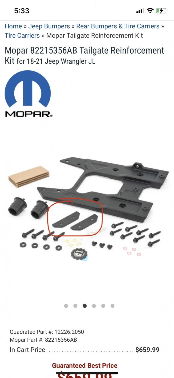

you should not need the part you referenced.
I’m running both and only needed to use the two small brackets shown coming with reinforcement kit to ensure everything is even for mounting on the left upper and lower sides.

Thanks. The Mopar tailgate reinforcement you linked is what I’m buying. What exactly do you mean by “the two small brackets shown coming with reinforcement kit”? Parts that already come with it or some parts that I will need in addition to the normal parts it comes with?
I believe he is referencing these
OK, if that’s the case then great. They already come as parts of the reinforcement, not separate items to buy. All of the Original parts are included with the one I’m looking to buy. Thanks.
Yes, what he circled is exactly what I was talking about.
