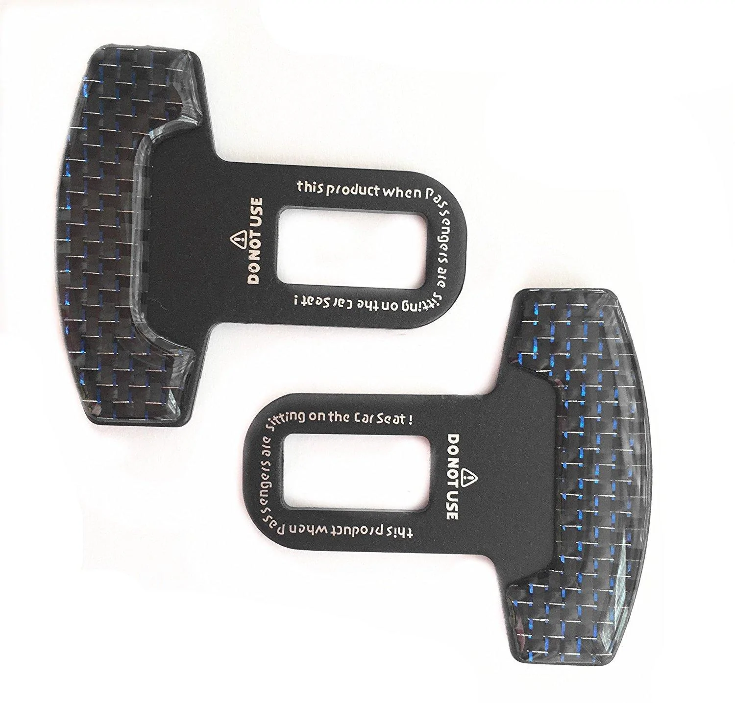

I'm wondering if one of these seat belt clips stuck in the driver's side female buckle will trick the JL into thinking the seat belt is buckled and then disable auto park.
See this post:
https://www.jlwranglerforums.com/forum/threads/disable-seat-belt-chime.3521/page-3#post-542076
Anyone have one of these ... they can test with. Seat Belt Clips... you buy on eBAY and Amazon, etc..
See this post:
@Roky
@ebelp
The fellow says yes, the seat belt clip disables auto park.
https://www.jlwranglerforums.com/forum/threads/disable-seat-belt-chime.3521/page-4#post-544703
