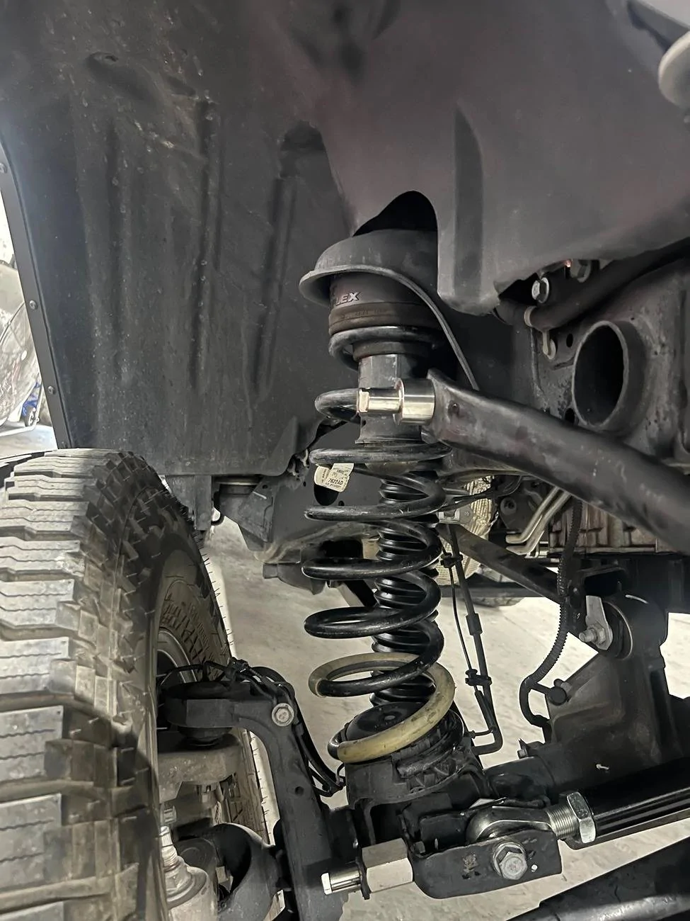

Got all my work completed on my JLUD and took it in to get flex'd out to check for contact, and the biggest issue I was advised of is that my shocks make contact with the frame before full extension. The shop recommended Metalcloak shock relocation brackets, but after checking them out, they say they need a 2" spacer on the stock wheel or a wheel with different backspacing. I've about reached the end of my limit on funds at this time, and things are starting to pile up.
  • Is there an alternative relocation solution I'm missing that would not require all new wheels?
  • Is there such a thing as limiting straps for the front axle to artificially keep the shock off of the frame before contact?
They additionally recommended 1" of bump stop in the front and the rear to keep the springs from over-compressing, but said that it won't stop the shock contact. I'll be doing that as it is relatively simple and cheap.
My original short-term aspiration was to just leave the Rock Krawler front sway bar disconnects connected for the time being to limit articulation and skip the shock contact until I have more time and cash to fix it. However, on my first trail, I threw one (passenger-side, top mount popped off, separated the ball from the rod, and yeeted the pin somewhere that I never found). After calling the company, I've been told this will happen over and over as the disconnects aren't meant to be used on the trail, only on flat ground / pavement. Sure wish they had shared that info in the information before I had bought them...

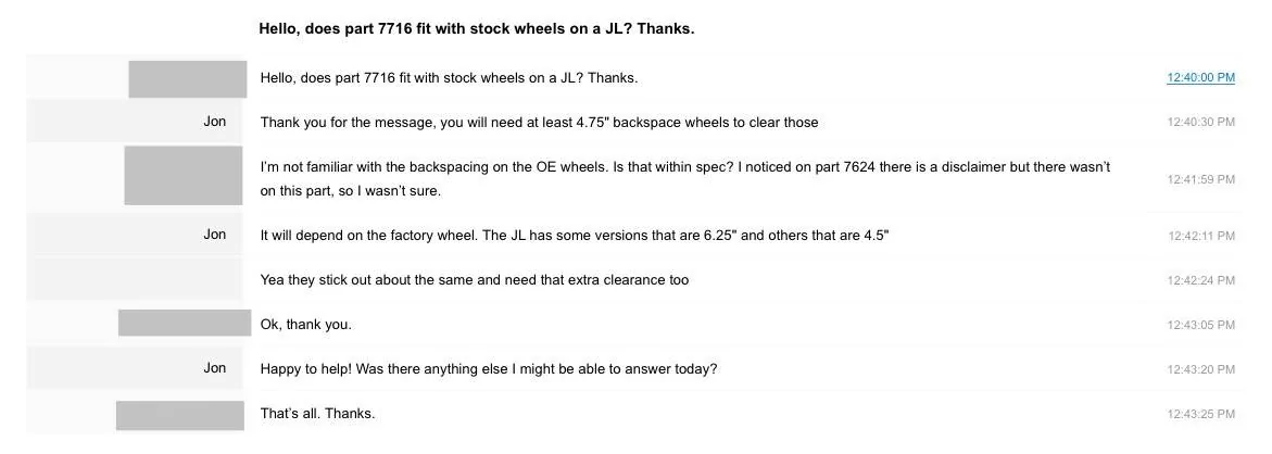

Hadn't seen these before. Do you have experience with these? This is what I got from the manufacturer:
Good Morning
Thank you for reaching out. I am not sure, these were intended for use with large coilover shocks which require bigger backspacing. Installing on a stock wheel with a standard shock setup is not something we have tested.
EVO
If someone has used them and knows they clear, that would be awesome...

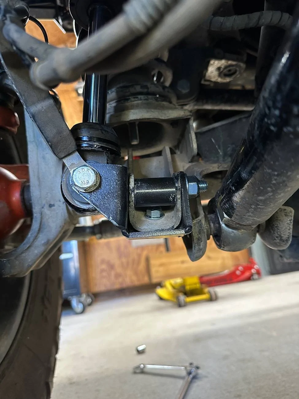

Yeah I ran these for a few years….. I have 4.5” backspace wheels though… I can’t see that they would interfere with stock wheels, here’s pic…..

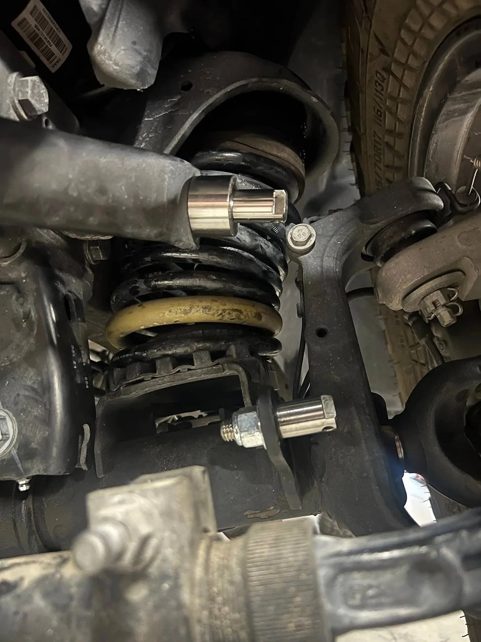

The MC brackets you seen that said you need 4.75 backspace are the relo brackets that raise the shock as well as outboard it….. I switched to the new MC brackets that just outboard the shock without raising it…..
Jeep Wrangler JL Stock-Wheel-Friendly Alternatives for Shock Relocation? IMG_9973
here’s the link, if you see where they say anything about wheel bs please let me know……

I’ll have to reach out to them and ask. This is the product I was looking at:
https://metalcloak.com/outboard-sho...eyTCVqaE0LBEehNFp6FaqEC0Kgz5MSt_iMZ1dzC9AzzGy
It has a big warning saying “If using OE wheels 2" spacers will be needed to give proper clearance. These mounts are intended for use for wheels with 4.5" of backspacing or less or an equivalent of a 2" spacer on factory wheels.”
The one you linked to looks the same but in black, so I’ll reach out and see if there actually is a difference or not.

The one I linked is different than the one you linked, I just painted mine black…..the one you linked raises the bottom of the shock as well as outboards it…… the one I linked just outboards the bottom of the shock without raising it…they are two different brackets….
Ah. I see it now. It’s like playing that game spot the differences… the rise wasn’t easy to see in comparison. Thanks! I’ll bug them to confirm fitment.

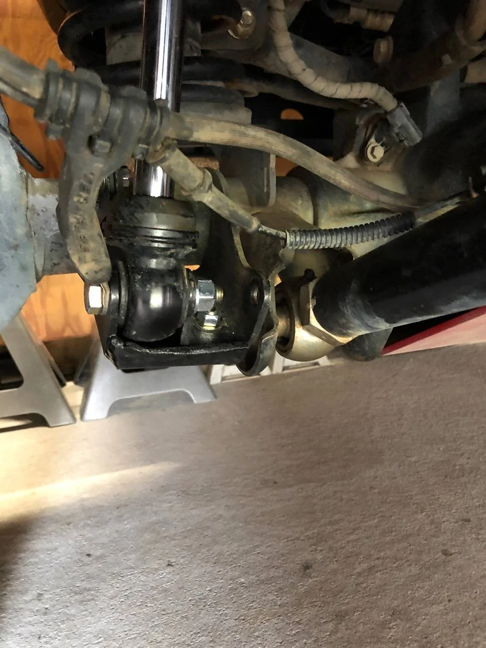

No dice here sadly.
Jeep Wrangler JL Stock-Wheel-Friendly Alternatives for Shock Relocation? {filename}
I have the MC raise relocation brackets. I honest cant see how factory wheels would cause issues. Granted, I have 1.25" wheel spacers, but I dont see wheels or tires are even close to make contact with shocks under full tern full flex.

I wonder why the slight difference in mounting height changes what wheels fit.
I don’t know…. Just thought it was odd that there wasn’t any mention of wheel fitment on the new level bracket website, unless I missed it. I don’t know to much about oem wheels, my only interaction with them is when I’m replacing them….🤣

I think I figured it out... The same height ones are listed as a "RockSport Black" part, which comes included with the RockSport Black front shocks. The kit states "All 2.5 in diameter shocks will require model specific consideration for “proper” fitment; additional bump stops, properly back spaced wheels, brake caliper clearance, etc... "
@Metalcloak should really list the limitations on their individual components, or design to work with OEM parts.
